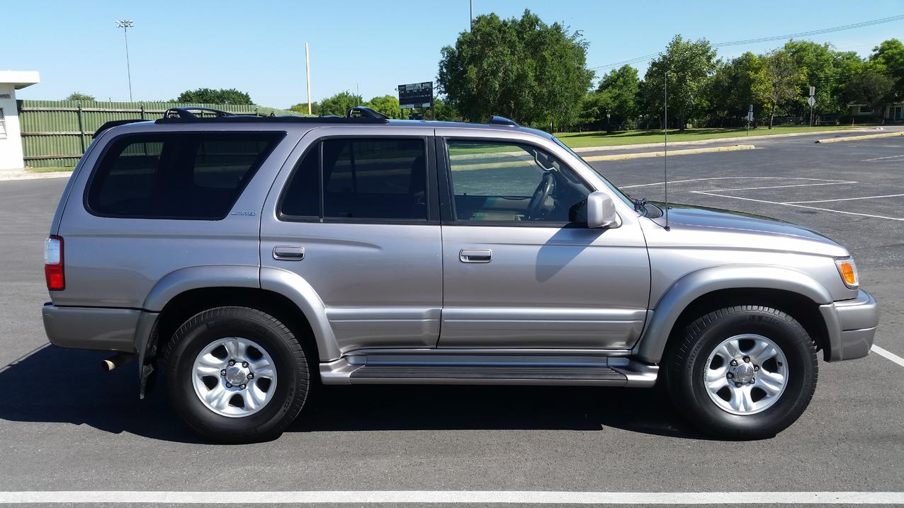

New member here and my first post... Just picked up a 2001 4Runner Sport in Imperial Jade Mica with 88k that was garage kept by the original owner and incredibly well taken care of. T-belt already serviced and body in excellent condition with very little rust anywhere underneath. Only things it had were a cold air intake and a touch screen in dash navigation system with bluetooth and an ipod cable for charging. It had a few common gremlins with the dead factory clock and dead power antenna. Front rotors were also warped which led me to upgrade right away to the 13WL 231mm Tundra front calipers with Brembo rotors and Toyota pads. I also added a B&M 70264 external trans cooler at the same time to protect the trans. The last thing mod for now was removing the factory running boards which I have listed on craigslist already(hit me up if anybody needs them). The truck has Michelin's on it already with lots of tread so it'll keep me from doing a suspension lift until it needs tires again. I've already put this forum to good use as there's so much good info on these trucks here it's scary. Down the road I'll look to lift it 2-3" and go with a bigger tire but it''ll be just fine for now. I'll only be using it sparingly to hunt and fish and tow my 16' aluminum boat. Look forward to posting updates as I go down the upgrade path here and I'll post better pics of the truck when I take them.
So clean and pretty! Outstanding find! :jelly:

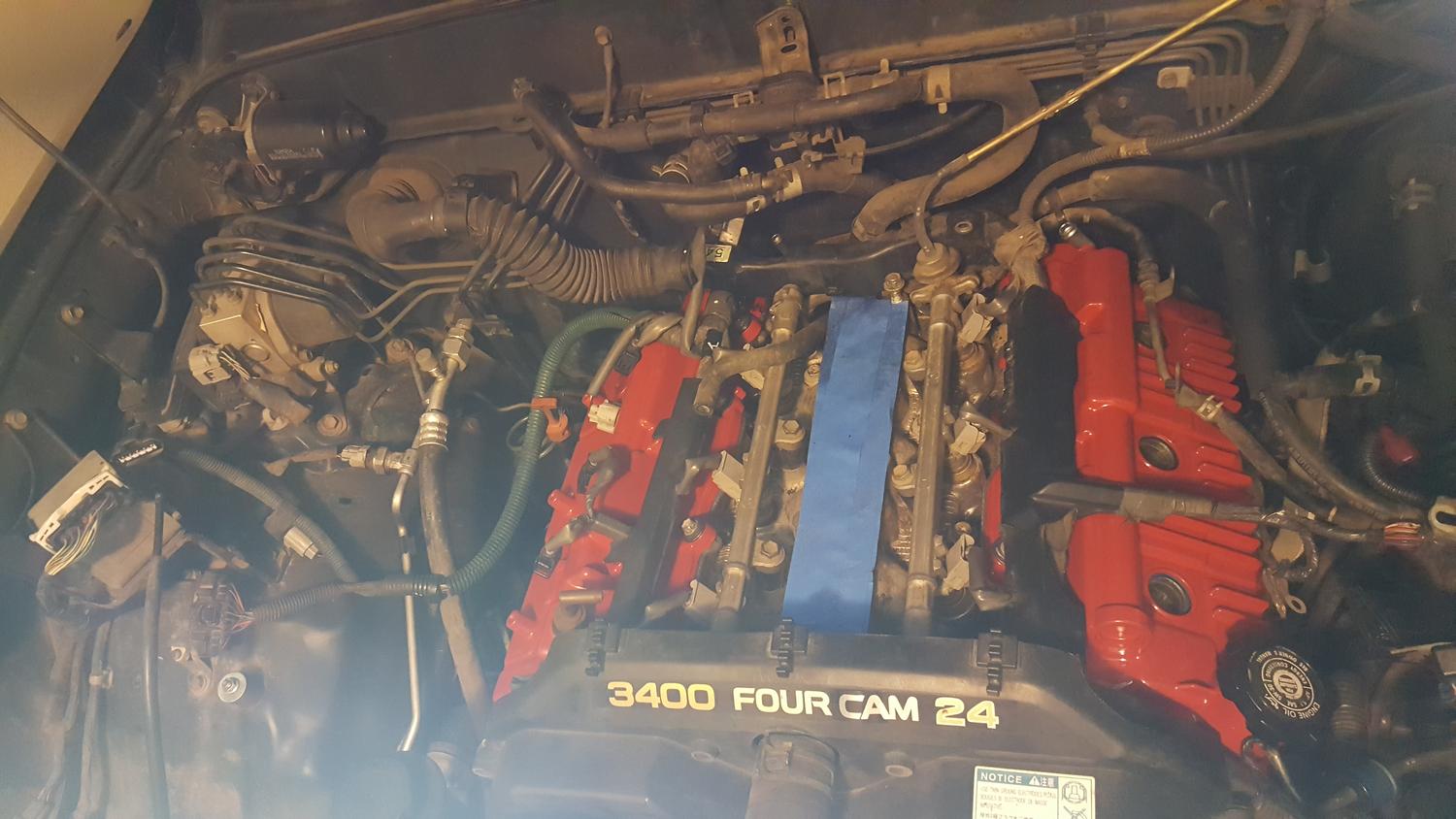

@ Amalik , No it's actually just paint. Back in my import tuning days some powder coaters were sand blasting the whole covers without protecting the bottoms and it cause issues with the sand falling out after heating up, so when it comes to valve covers, I have decided to not get them powdercoated and to just use paint. They did end up pretty clean and I tested the coating with a heat gun, it held up.
Just a note.. the VHT flat red is - ORANGE... lol don't use it , I learned the hard way.
