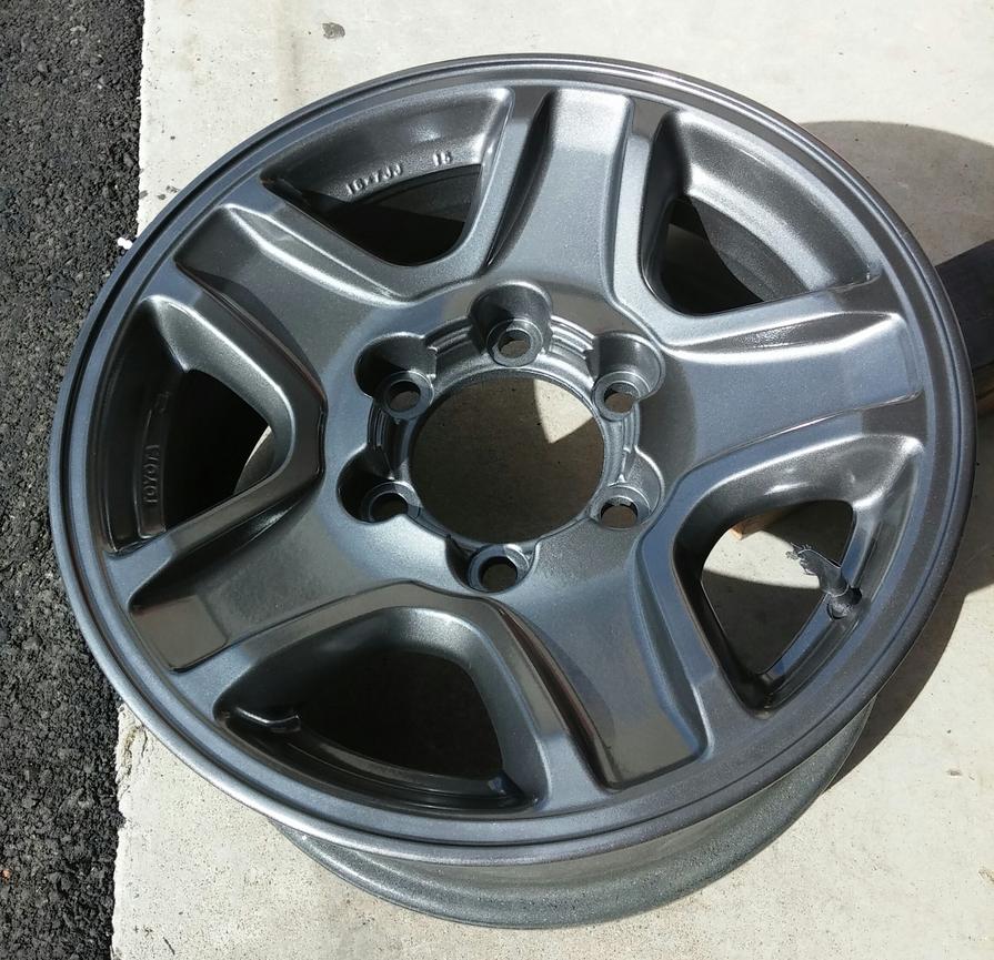

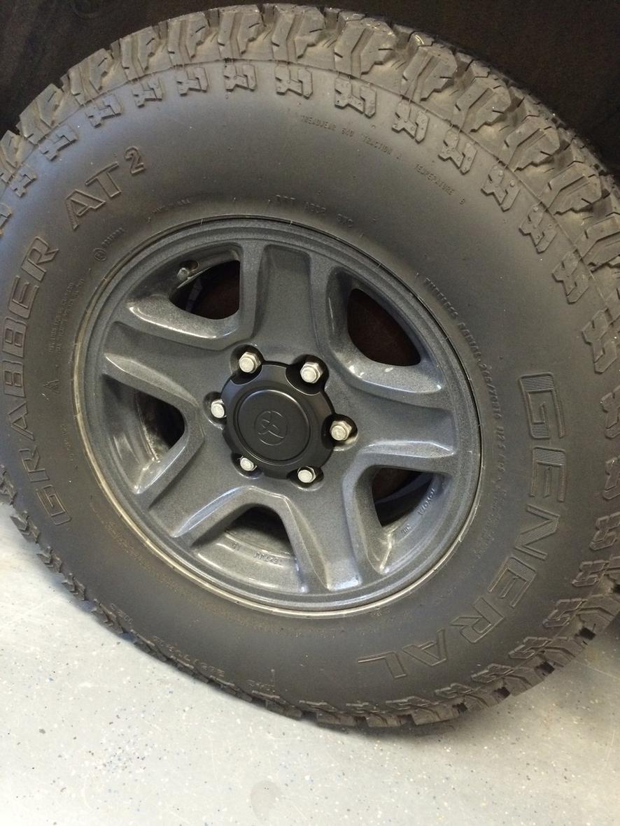

[MENTION=137305]HawkNation[/MENTION]
I think you would find a close match if you used Duplicolor white primer then 2 light coats of Duplicolor Graphite Wheel Paint, followed by Duplicolor clear wheel paint.
My wheels are Duplicolor graphite and while mine (2nd pic) are a bit darker, you could correct that with a white primer and two thin coats instead of two thick coats like I did.
