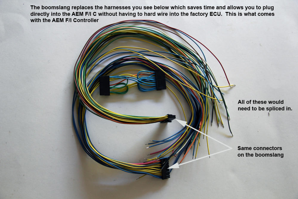

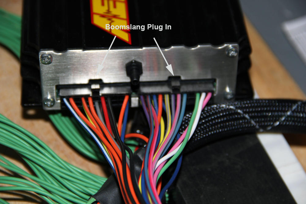

AEM F/I C and Boomslang Installation

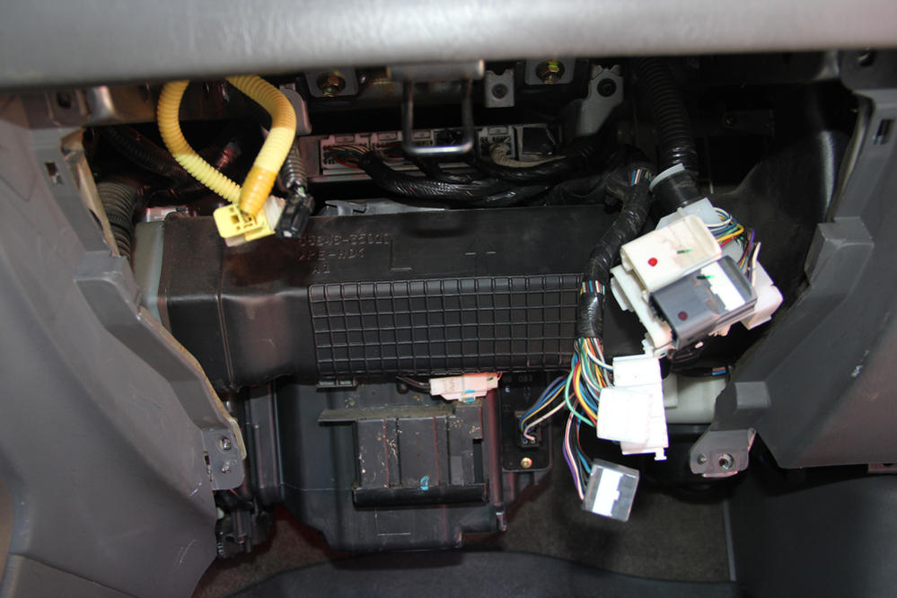

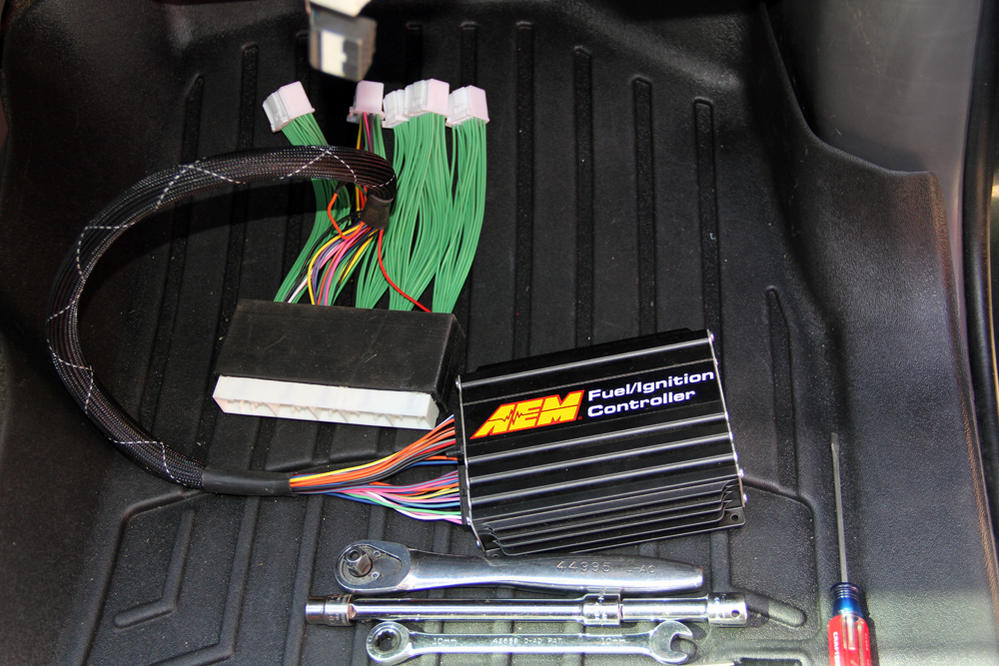

Getting prepped to install the AEM F/I C and Boomslang harness with the AEM wideband gauge. There's not a lot of room to play with behind the glove box. Looks like I might end having to use it.

That's quite a wiring harness! :eek:
What does it do?
It's the lazy man's way of plugging directly into the ECU without having to painstakingly hard wire each wire to the factory harness. It replaces those connectors you see in the 2nd photo. It's a direct plug-n-play. White plugs with green wires plug directly into the ECU. The plugs from the ECU harness plug into the Boomslang.
The problem I'm running into is the lack of room behind the glove box. Can't seem to find a nice place for this to live without some modification.
EDIT: Look at the 2nd photo above post. The factory ECU connectors plug directly into the white female end of the Boomslang. The White connectors with green wires plug directly into the ECU.
