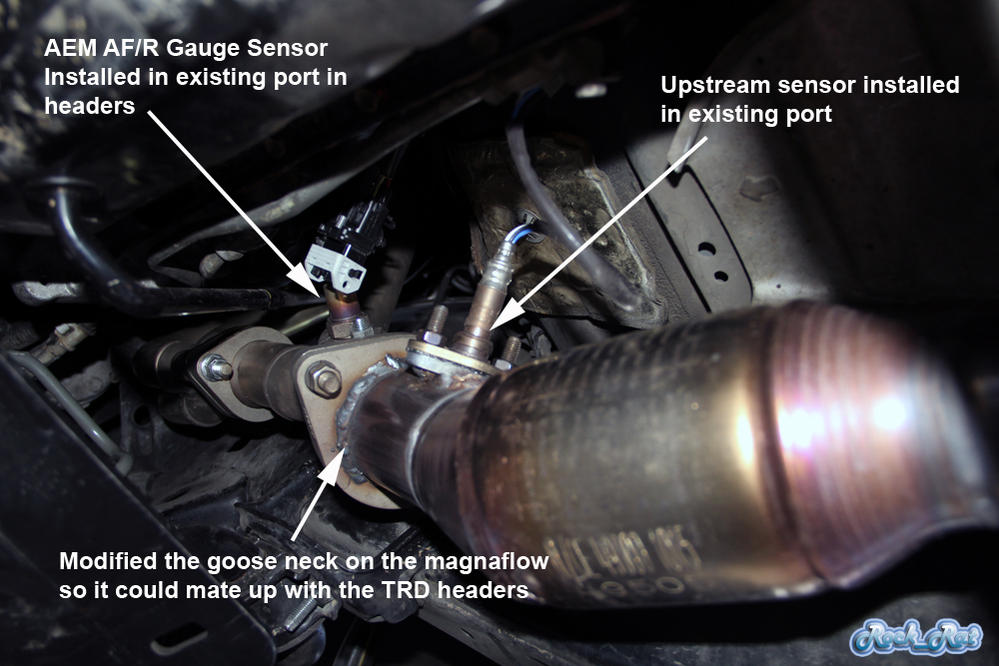

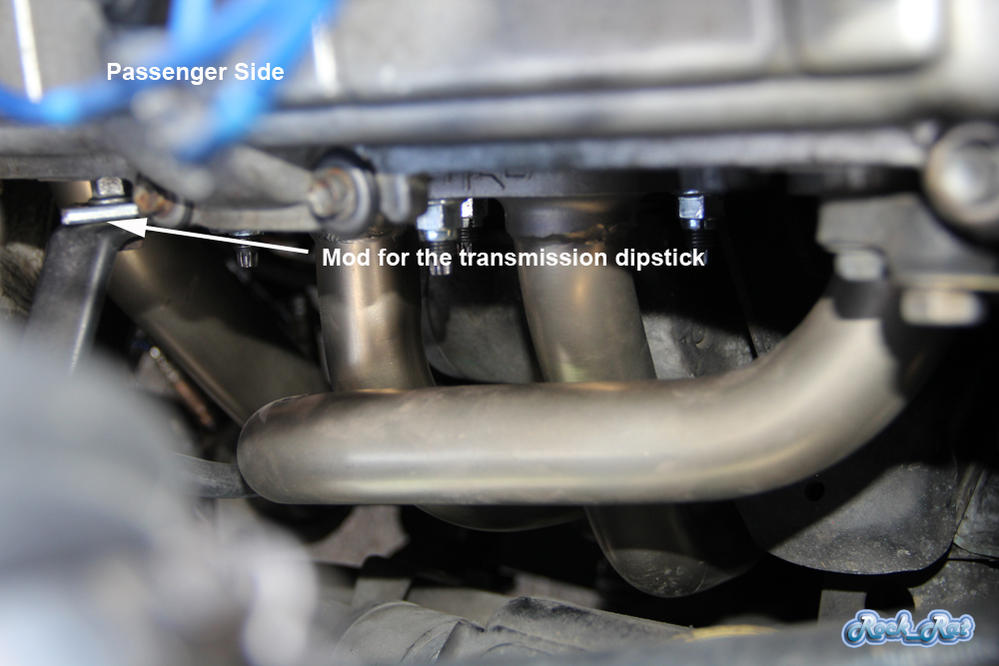

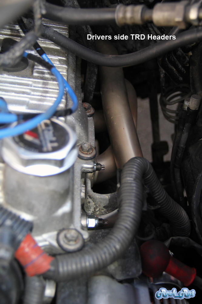

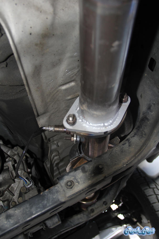

TRD Headers and Magnaflow Exhaust Installed
Had my TRD headers and cats installed. Picked it up yesterday afternoon. Here's a couple pics. Write up is in my build. My only advice to you is be prepared to have your cats modified if you have headers. Ended up modifying the elbow (not a goose neck) Direct fit is for stock exhaust only.
Here's the link. I have the list of Part numbers for my Entire Exhaust setup Here - TRD Headers with Magnaflow Cats and TRD Cat Back

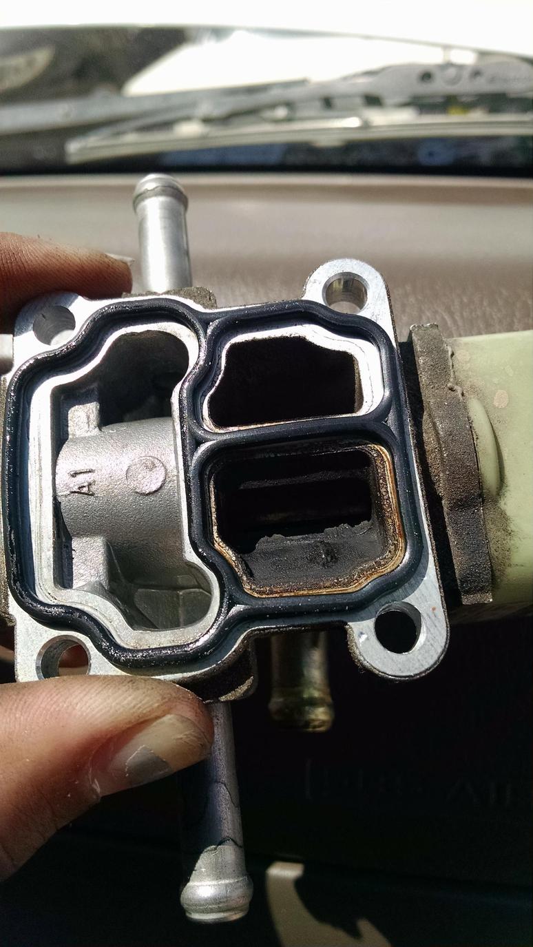

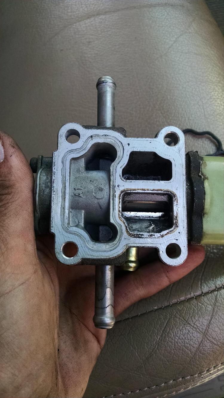

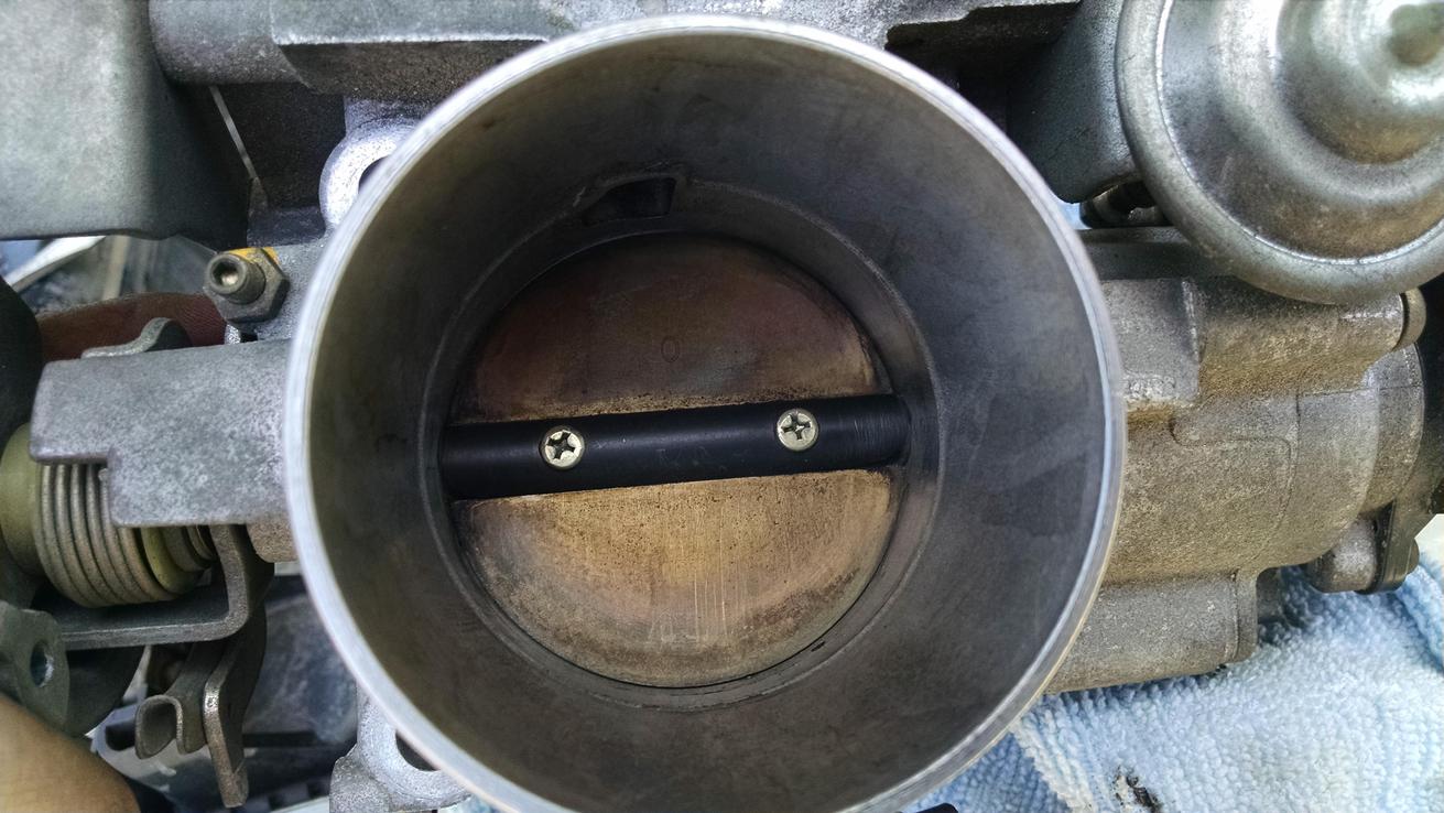

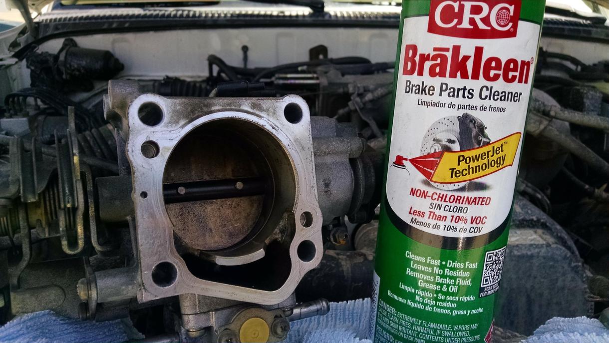

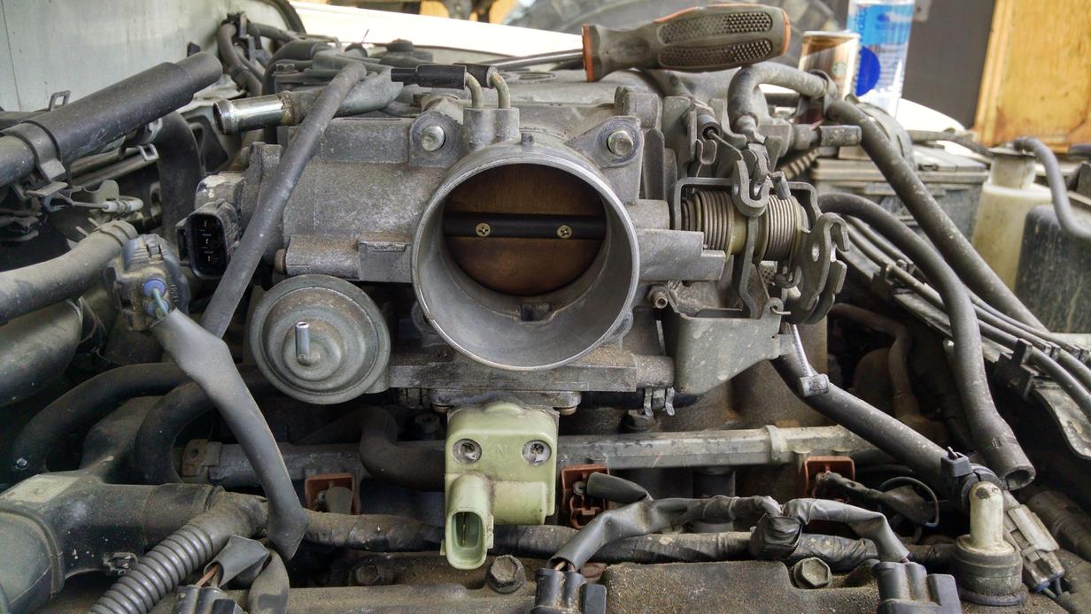

2000 Running Perrrfect
I am out in the desert often...Out racing around in my 4Runner.
Started loosing MPG
Then she started to idle extremely low and stall out at initial start up.
By the looks of my engine bay, (dirty..Mud and dust) I decided to do some cleaning..
MAF was filthy
Air Filter filthy
Throttle Body filthy
IAC filthy and full of buildup
Used my favorite..Brakleen to clean everything.
Put it back together started it up....Low and behold, check engine light came on for the first time ever and the idle was way too high.
Reset ECU - Unplugged battery for 15 minutes. Started her up and everything was PERFECT. No check engine light and the idle is right where it needs to be.
And some say girls can't wrench ;)

I'm having similar symptoms with mine with low idle and random long starts. Will have to give this a shot.
When you clean the throttle body remove the IAC first, that way the crud doesn't wash into the sensor
I used a zip tie with Brakleen to clean the IAC. The zip tie comes in handy with scraping off the buildup and it opens up the little valve inside.
Also, when you pull the MAF, DO NOT TOUCH the actual sensor itself, just spray with cleaner, let dry and pop back in.
