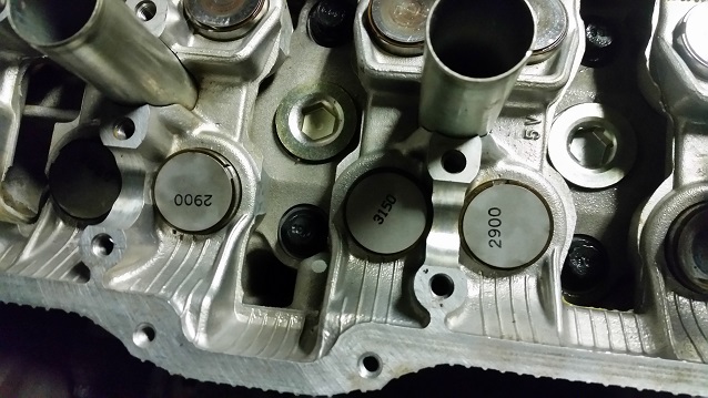

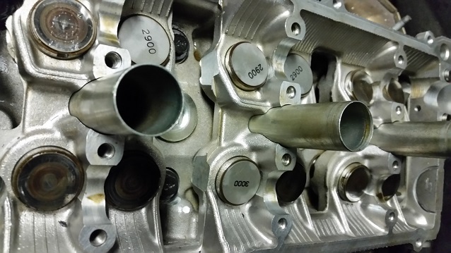

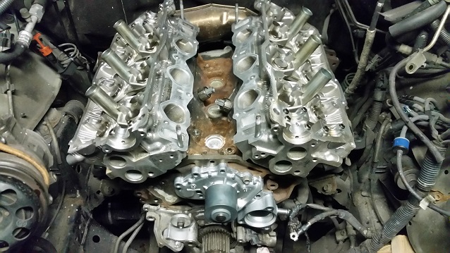

Finally got off my lazy ass and did a bit of work to the truck after a loooong break...

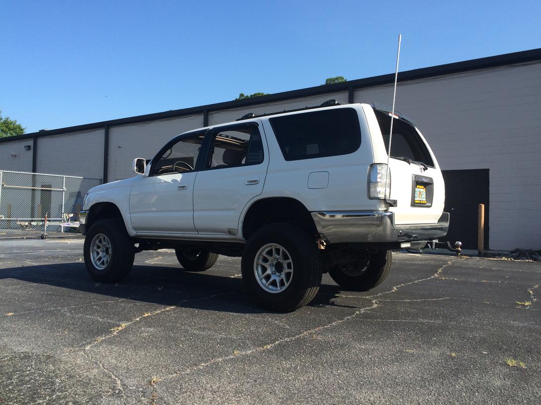

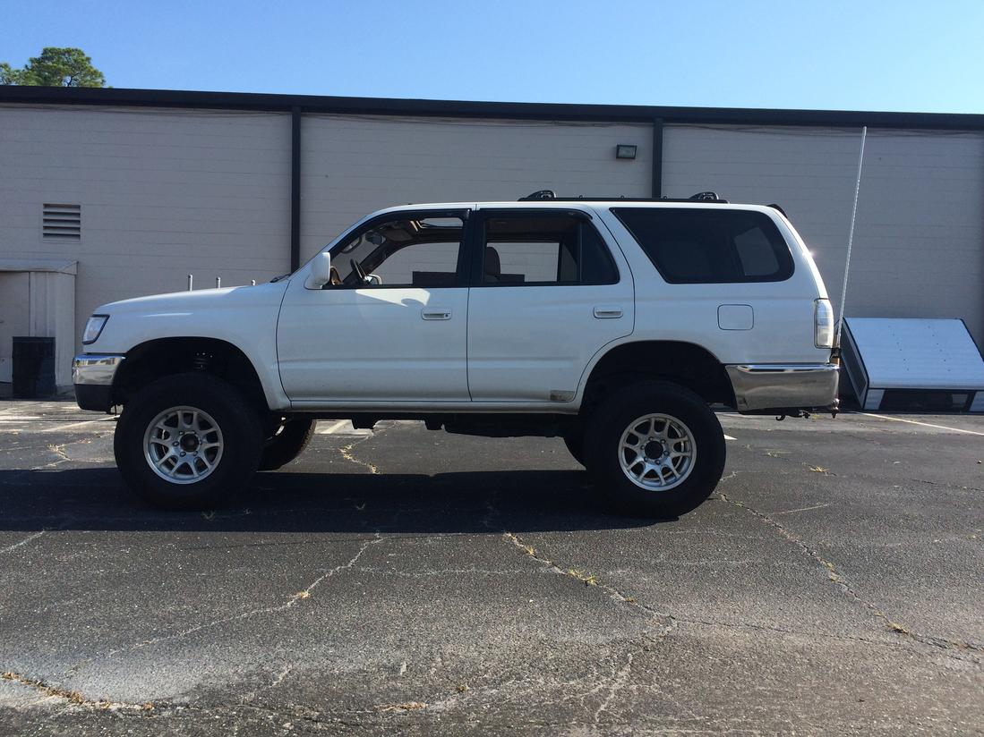

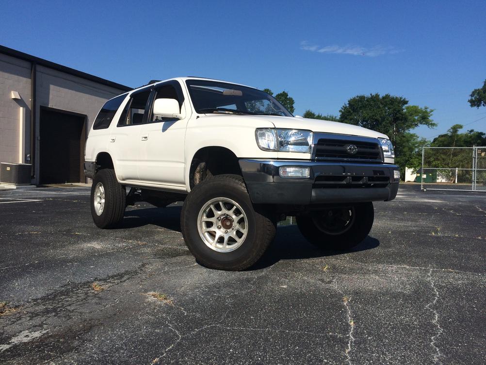

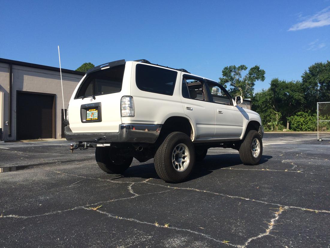

Took 3.5hrs last Friday to install my lift would have gone quicker but had to sawsall one of the rear shocks off. Gotta love rust free southern trucks!
Rides so much better than the worn out stock springs and shocks
Front:
Tundra Bilstein 5100s with Eibach 3 inch lift coils on second perch
Rear:
4th Gen 2 Inch Lift bilstein 5100s with LC 8 Wraps
Wheels/Tires:
265-75s on 16x8 0 offset
(p.s: Cant figure out what wheels these are they have no markings on the outer wheel. Forgot to ask the tech that put my tires on to check for markings) Anybody have insight? I have searched and searched trying to find a match to them I want a fifth one for a spare
Really makes my tires look small now and I would love to bump up to a 305-70-16 all terrain and finally regear to 4.56s
Hub to Fender:
F: 23 3/4"
R: 25"
