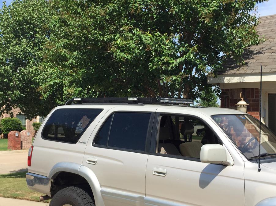

New roof rack and lights

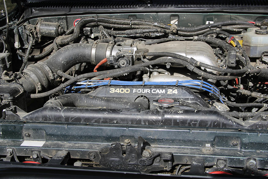

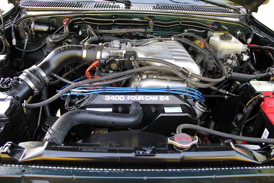

Totally. FSM and I watched a YouTube video a couple times. Had a mechanic buddy come help actually place the heads, but I've done the rest.
Nice man, I'm proud of you. Hopefully you button her all back up and theres not like a grinding camshaft noise or something from misalignment, lol.
What did you do again? Replace heads or got the heads machined? Crack in the head right?
Had a cracked driver's side head, so replaced them both.
She's all back together and seems to be running like new =)

I just don't like using feeler gauges, so checking the clearance was my least favorite part. However, since my new heads were "loaded" I was able to salvage shims out of the old heads to get them dialed in.
The camshafts were not an issue. Just have to make sure the tensioner spring within the gear is "loaded" and insert a bolt into the service hole. If the spring is not loaded, just turn it with a pulley holder to where the holes line up, insert a bolt.
My BIGGEST lesson learned from this whole ordeal is that nothing is as difficult as the internet makes it seem. Time consuming as hell, but it's all essentially just loosening and tightening bolts, and cleaning sealing surfaces.
And having the right tools helps.
We're your cams badly out of adjustment ?
Nothing on a car is really that hard once you get inside and starting learning. Its all wrenching.
The real issue is when you do all this work and your head gasket goes. Or you reused head bolts that stretched. Thats when it becomes a PITA!!!
They were not out of adjustment at all.
Totally agree. Because of that, I bought all new Toyota gaskets, and all new Toyota head bolts and had an experienced mechanic here for the preparation of the block's surface, gasket placement, and head bolt torquing.
