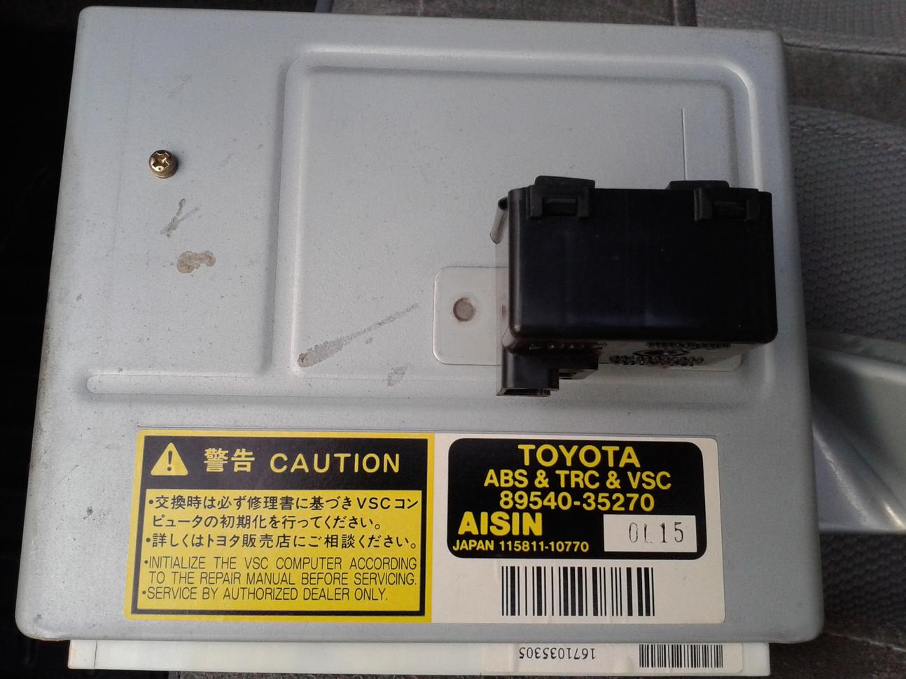

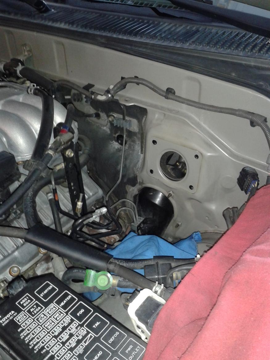

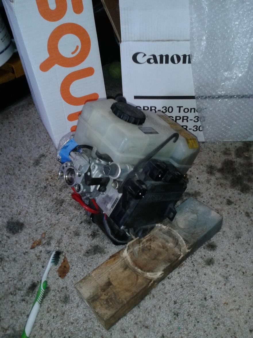

abs module and master cylinder today.

Why?
module craps out and takes out trac and abs. brake light comes on as well as causing trouble code P0500, speed sensor, which takes out speedo.
master started leaking a little. excellent shape otherwise, electronically and mechanically. i may sell it or get the overhaul kit for it and O ring it.
