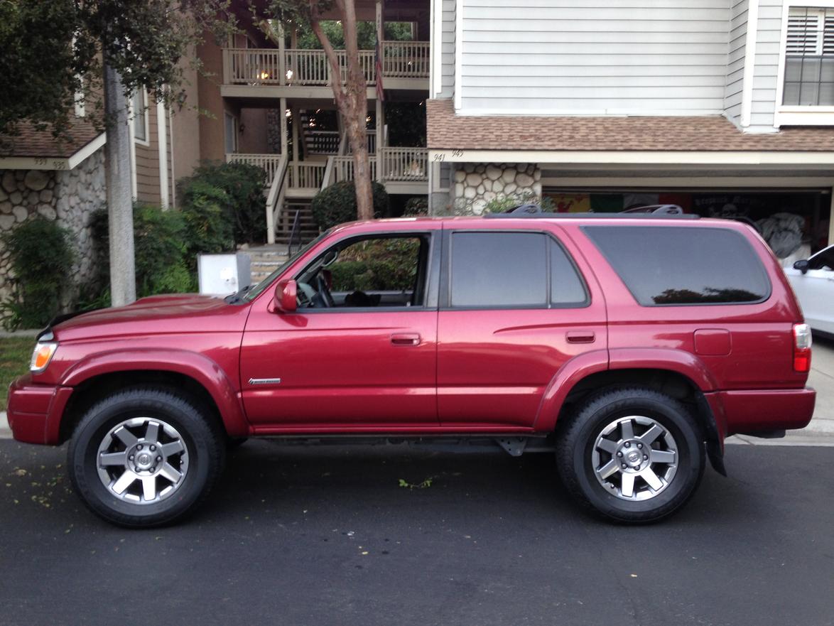

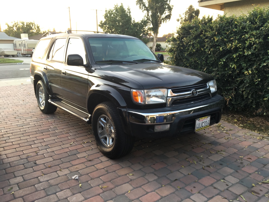

needed tires and "craigslist special" factory 2016 trail edition take offs cost what just tires on my 5 spoke 16's would have cost. Not the tires I wanted but a good buy and I'll just hammer em to and from work.
Brought the Runner into the 21st century with a Pioneer avh 5800 install, amped and subbed. Trying to figure out where to splice parking brake wire from stereo loom into constant power so DVD mode functions while driving. Otherwise, install was a breeze.
Mounted up a Craigslist special Defender rack, 4Runner- two-piece model, installed with the factory rail mounts from 4wheel. Mounted a 1in bar across the light tabs to accommodate a soon to be installed 40in led light bar. I did not want to bolt those mounts into the door jam, ouch.
Next up: new radiator. It's still the factory rad @ 128k miles but with regular coolant flushes there have been no issues, no milk shake ... Yet.

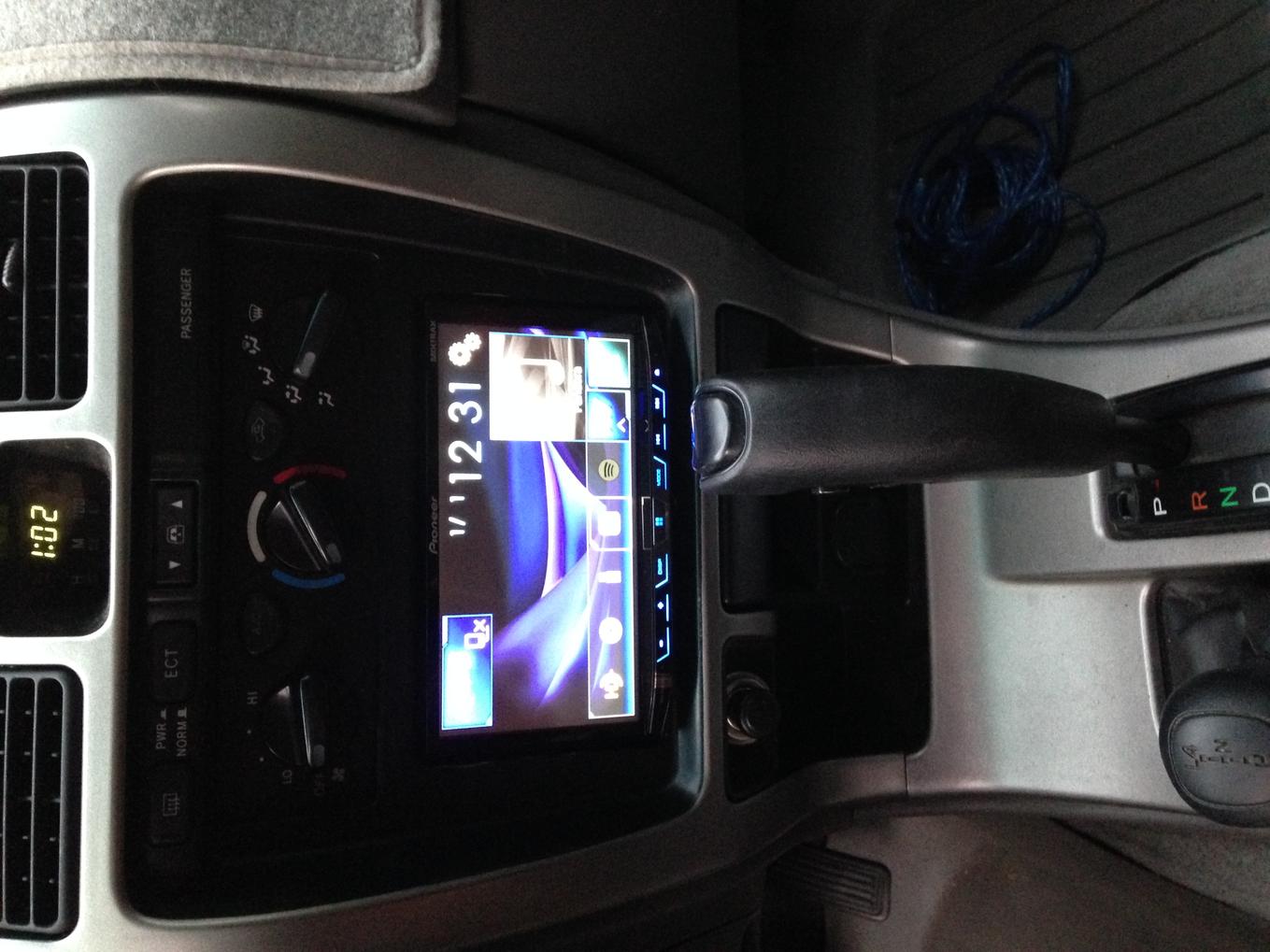

Take the parking brake wire from the stereo harness and splice it into ground. This will only work for some players but it easy and worth a shot. If that doesn't do it just get a bypass coil from amazon. They're pretty cheap.
Here is the new deck anyone know how to rotate the image? Lol... I rotated every which way before upload but no dice.
Thanks for the knowledge, dude! It's definitely worth a shot, I will try after work. I installed the whole thing in the parking garage over lunch break yesterday and today :guitar3:
Nice deck man. I just did a little research and Pioneer's AVH series uses a timed pulse for the parking wire. Grounding it will not work. My cheap Dual DV526BT has no such nonsense and grounding worked just fine. You'll need to pick up one these guys. Install takes about 5 minutes.
Buy Me...and please don't watch vids while driving. lol
Thanks a lot! What a pal. You Saved me a lot of digging around through the archives. The deck is really nice, better than any I've ever owned, it is my first touchscreen/DVD. Figured I could afford it if I installed myself (the local shop wanted an outrageous amount). I only just tuned her up earlier today, can't wait for the drive home. First decree! Thou shall blast Tenacious D!

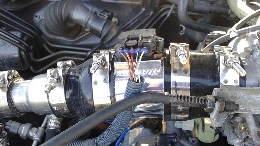

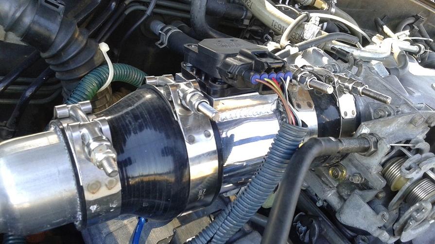

Got tired of the boost leak at my TB and the old style MAF...So, I got a used TB, a used new style MAF sensor and a Spectre #9405 MAF tube...Re-pinned the harness , plugged it in and good to go. Hopefully no more boost leaks for a while.

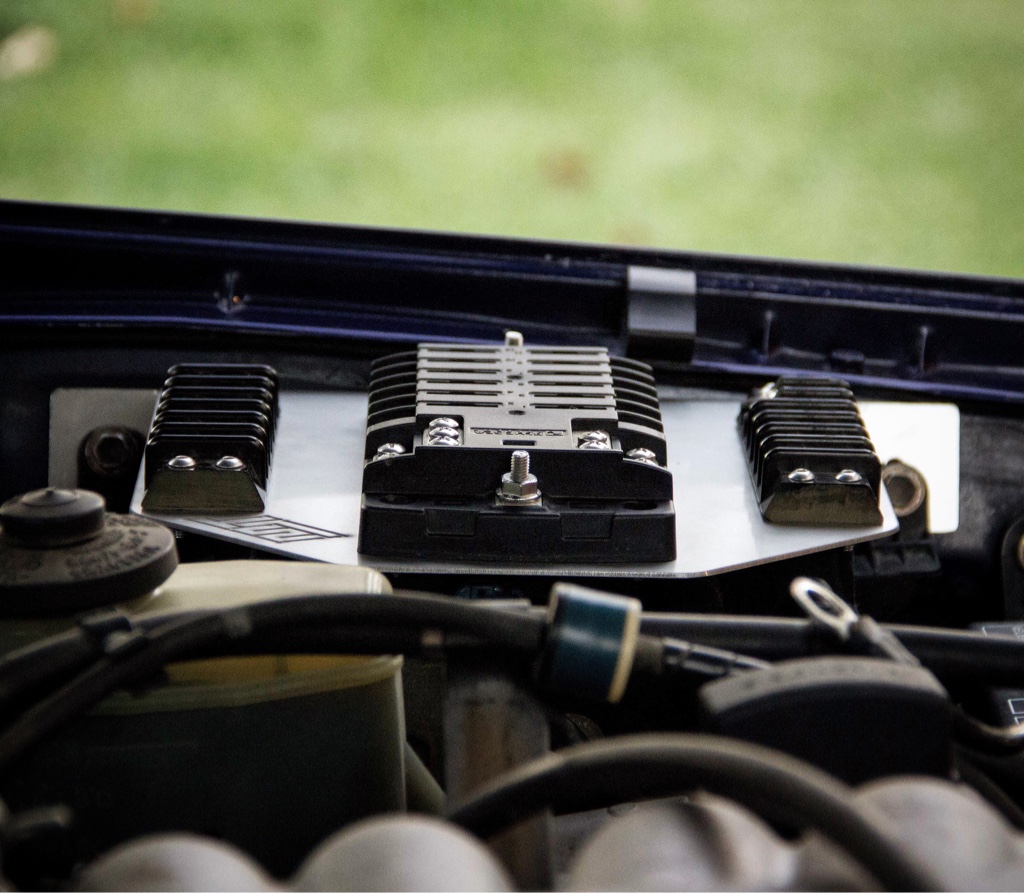

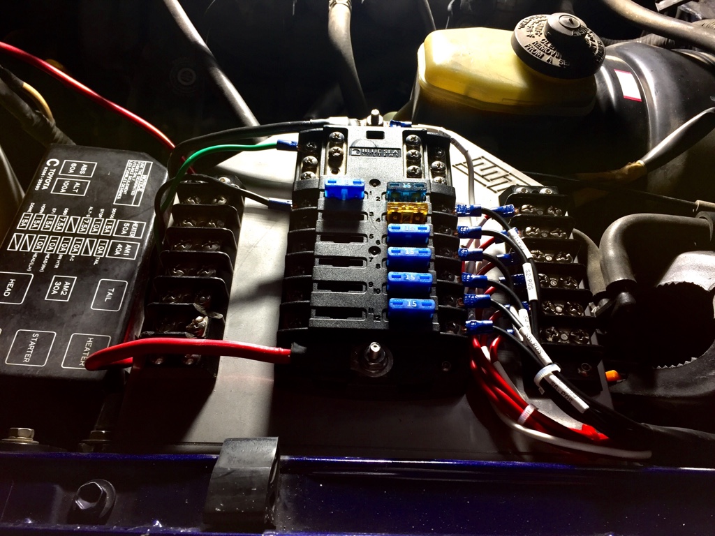

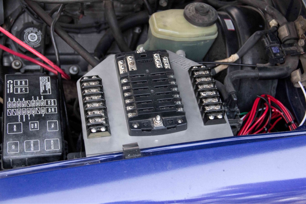

Finished my new bracket design and got it installed! Perfect fit. :) just slides into the charcoal canister bolts. take a look at my website if you're interested in a bracket. I designed it to fit multiple blue sea system fuse block models. See site for details www.4runnergrille.com
