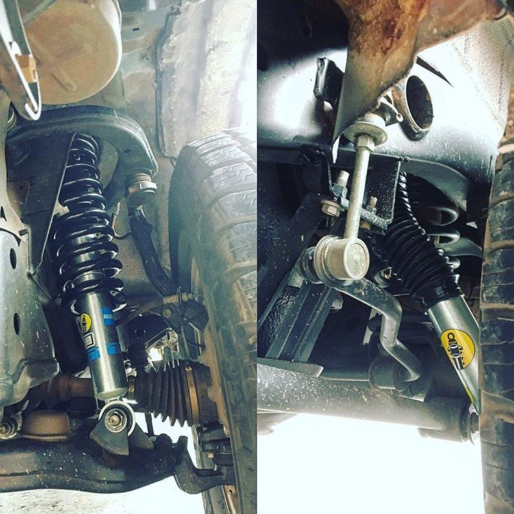

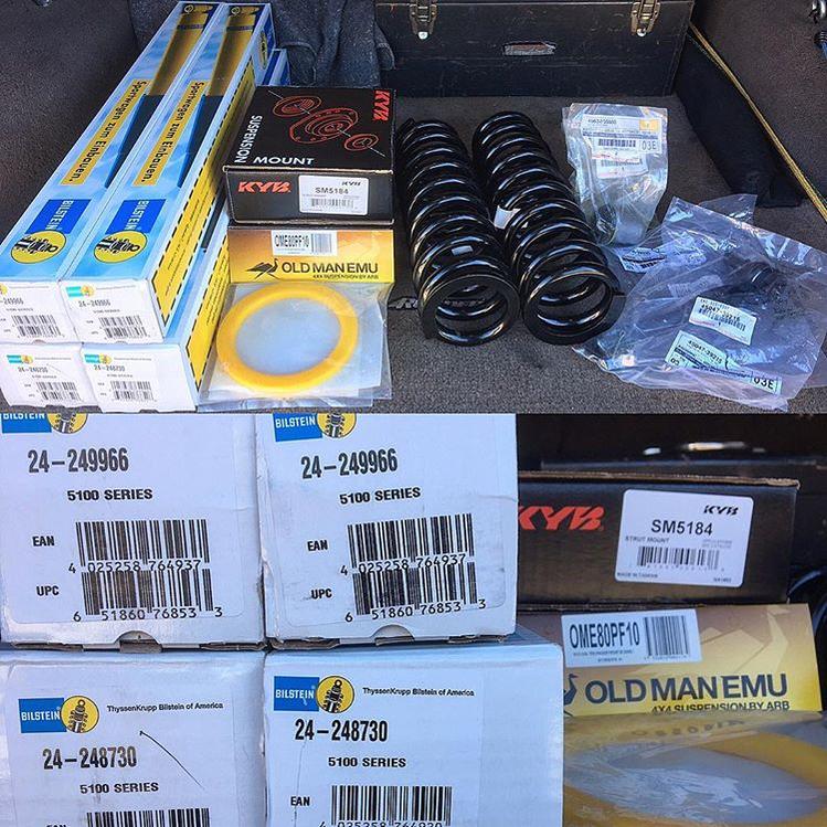

Installed Bilstein 5100s all around, OME springs, OTRE, and an alignment.

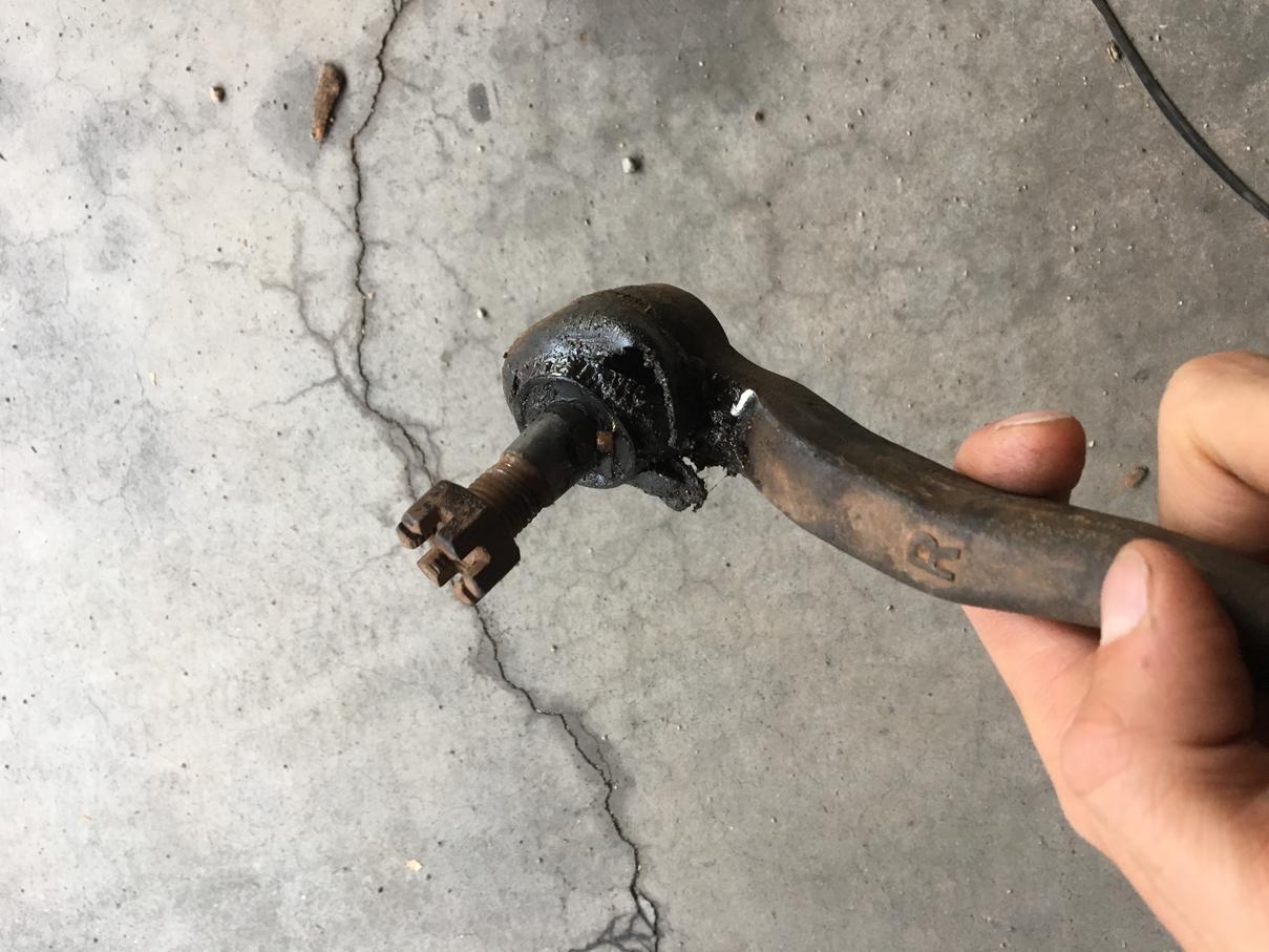

Also a good reason to stick with OEM parts. This is a generic part store OTRE that failed within a year. Otherside wasn't as bad but both were replaced with OEM parts curtousy of Camelback Toyota. The wheel wobble I had at 50mph plus is gone now (that could be coupled with the new suspension too).
