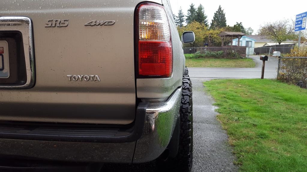

Spent the night last night putting my lift in. Had a lift party with the boys!
Then we put these bad boys in. TRD Tundra front struts.
And these OME 891 coil springs.
Along with these bilstein 5100 rear shocks.
Had to cut the old shocks out because of nasty top nuts that wouldn't come out even after cutting the dust shields and gripping the shafts with a vise grip.
While we were cutting out the rear shocks I got to work on the tires
Some nice meaty Cooper A/T3 265/75 R16s
Side by side comparison from my original 99 springs (190k mi) to the 891 OME.
Installing the last coil spring in the rear! Say hi to Jake.
On the ground looking pretty!
Before.
After (next to a crosstrek XV for effect)
I was a bit worried about the OME 891 springs being hard and not giving a good ride but boy was I wrong. They are amazing. They ride exactly like I want and they match the front struts super well. This is better than anything I expected and compared for the blown shocks and tired springs I had before it's a world of difference.
Next on the list is to get a bumper that will hang on to this that I picked up from the dealership for no money at all since it sat there for 5 years...
TO BE CONTINUED...

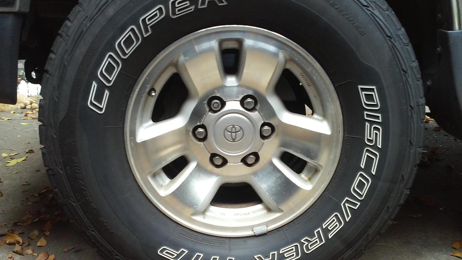

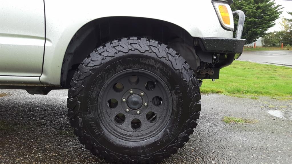

I also picked up some Pro Comp 7069 wheels. I have very minor rubbing at full lock with my tired suspension and 265/75/16s. I think this will get sorted with my new lift and SPC Light Racing UCAs.

Like the BFGs on the 7069s [MENTION=119532]Road Bull[/MENTION], I went Firestone Destination 265 75 16, on the same wheels, and rub a bit as well.

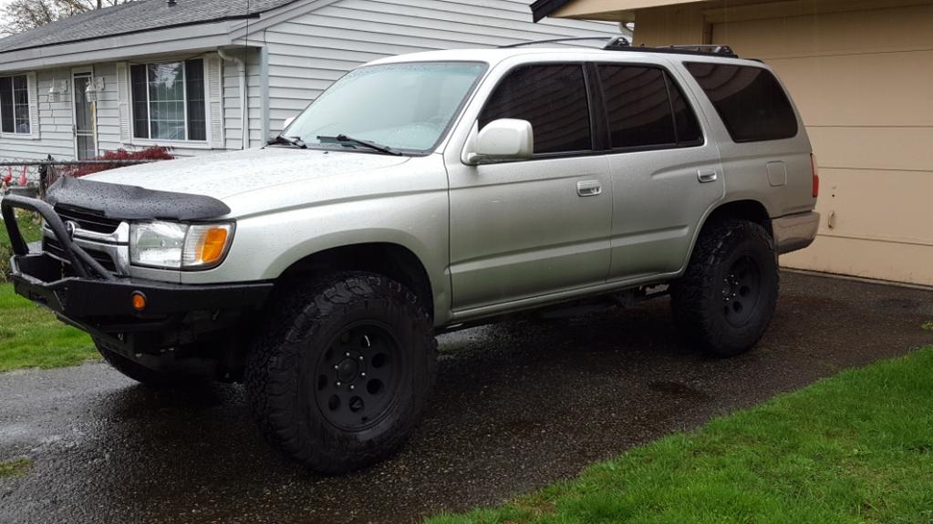

2002 T4R 3" Rough Country suspension lift, K&N intake, Method Race wheels, 33" Mickey Thompson Mud Terrain, Savage off-road front winch bumper, Warn 9000lb winch, CBI ditch light brackets, KC ditch lights.

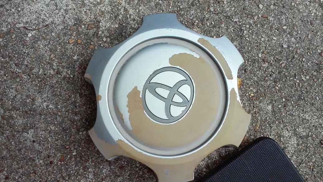

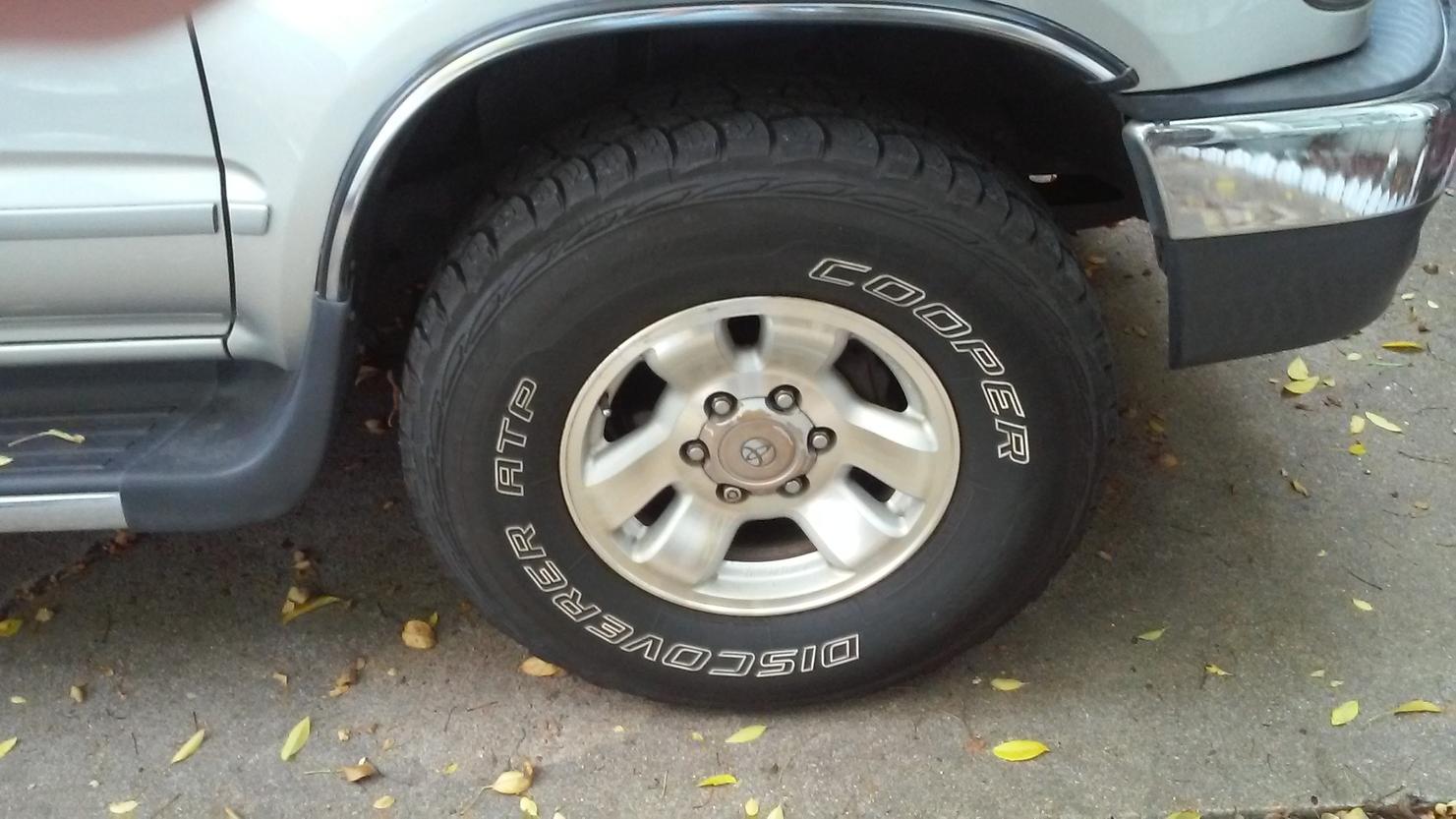

Hubcap Beautification last Saturday.
Not a perfect job, but better than it was !
Before & after:
