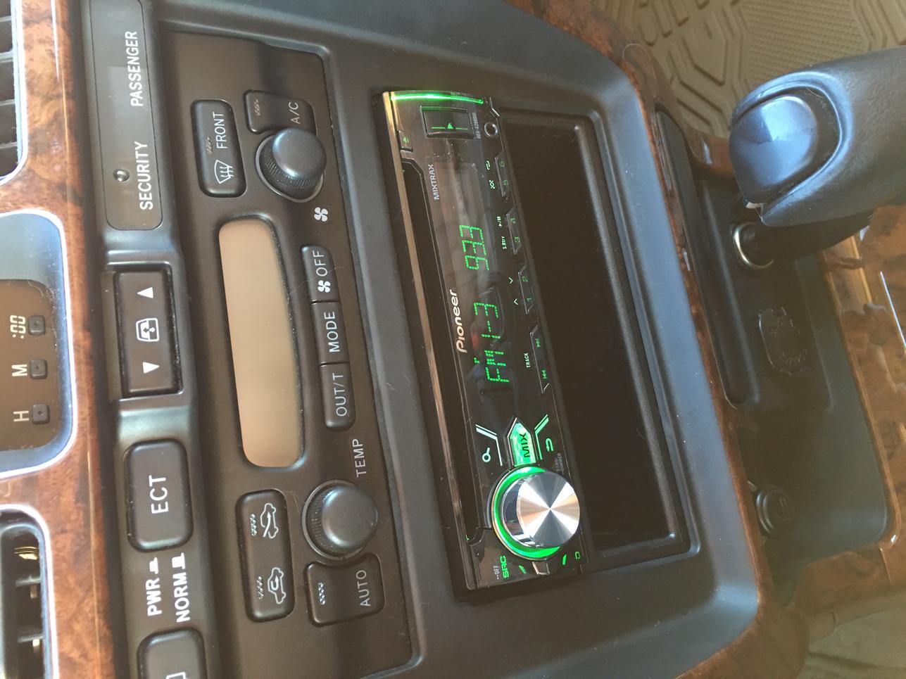

Got the factory stereo replaced with a pioneer that can do bluetooth and handsfree.
Ordered it from Crutchfield, as it comes with the stuff you need to install.
Easiest stereo install I've ever done.
Soldered all the connections at my bench, took out the stock stereo, brought it to the bench, installed the head unit and shelf to the old brackets, went out plugged it in, works. Magic. =)
Ok, the PITA will be trying to route the microphone wiring up to the visor for handsfree, but the stereo portion was a breeze. Have to figure out how to get that wrap off the driver side column (where the oh sh*t handle is).

much easier than you'd expect. I'd start with the mic in place and route the plug towards the h/u rather than plugging it in and then routing the mic, but that's just me.
should be plenty of "open" space behind the h/u to route the mic towards the "lower trim panel", (balls vent...). Removal of the lower trim panel is IIRC 4 8 or 10mm bolts? and two cables that connect the hood and gas tank latches, but you shouldn't need to completely remove those unless you want the extra room to work with.
once it's routed behind the lower trim panel, work the mic up and towards the drivers kick panel.
The hardest part will be removal of the A-Pillar, and I can PROMISE you that if you don't use an impact screwdriver (Impact Screwdriver Set with Case) you WILL strip the two philips screws holding the oh-shit-handle on.
Should be a handful of clips behind the A-Piller that should snap out easily.
Everything else should be pretty self explanatory, but let me know if you have questions
Edit: Realized I recommended the routing from the Mic-H/U, but described the process H/U-Mic. Just reverse. But it won't be difficult either way.

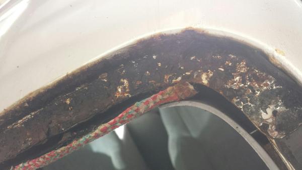

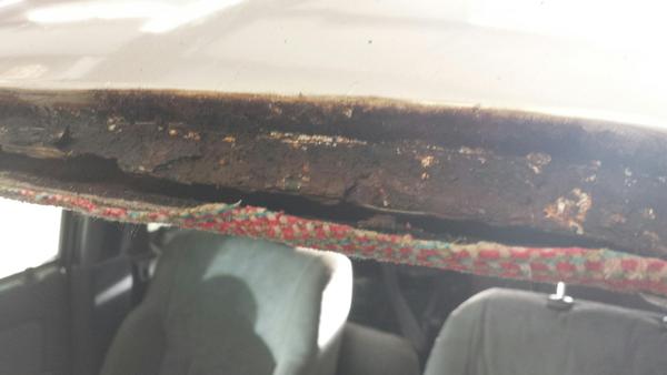

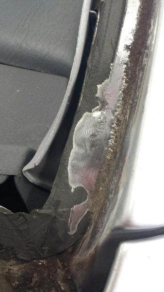

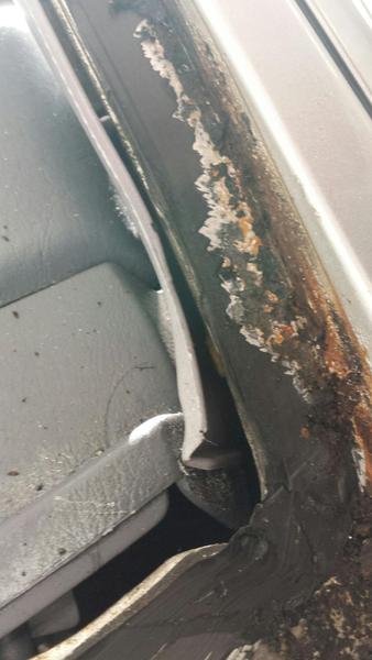

Picked up my truck after getting a new windshield installed.
Rust had formed from a previous crap install and they had to do some minor repairs.
