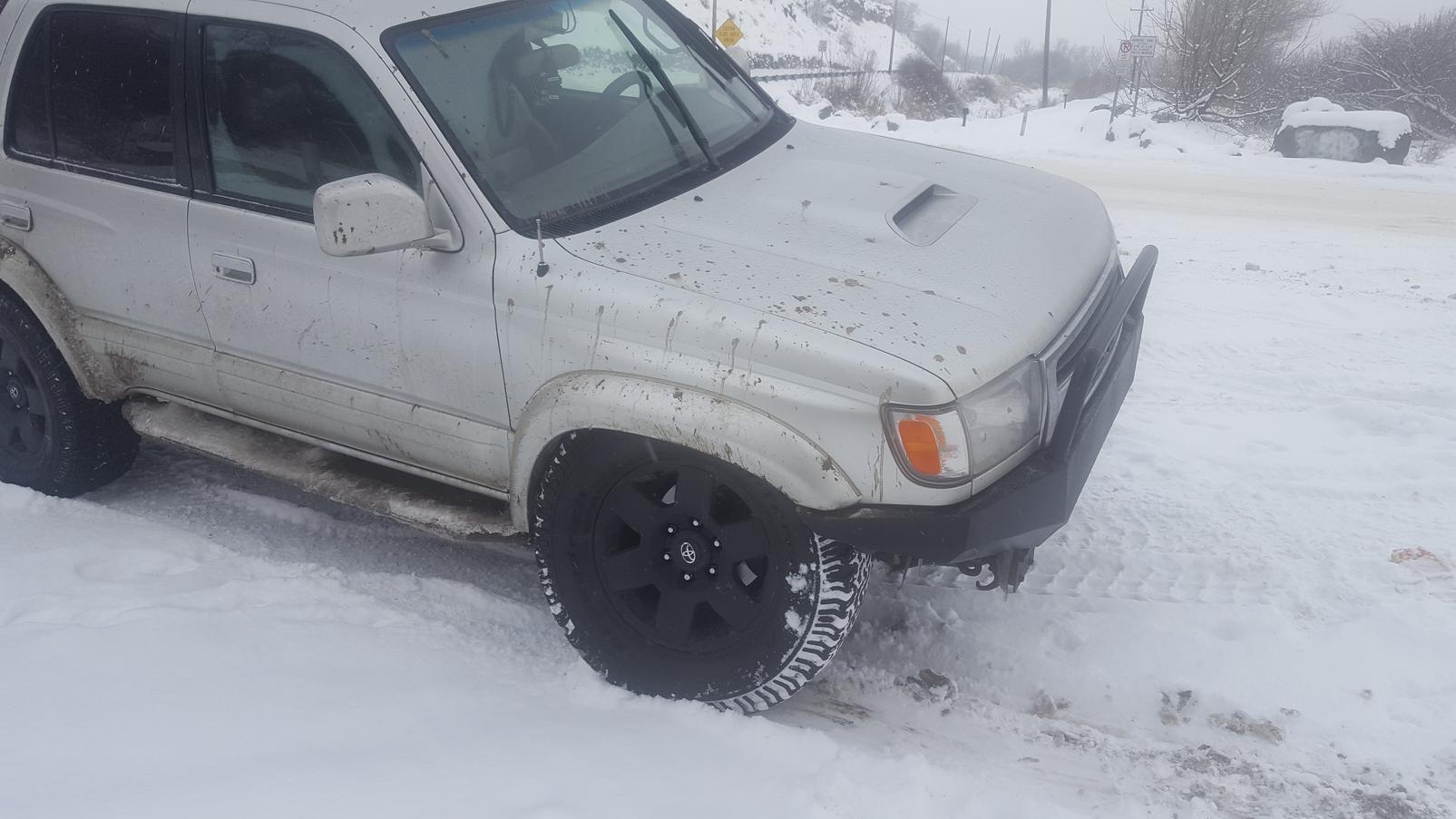

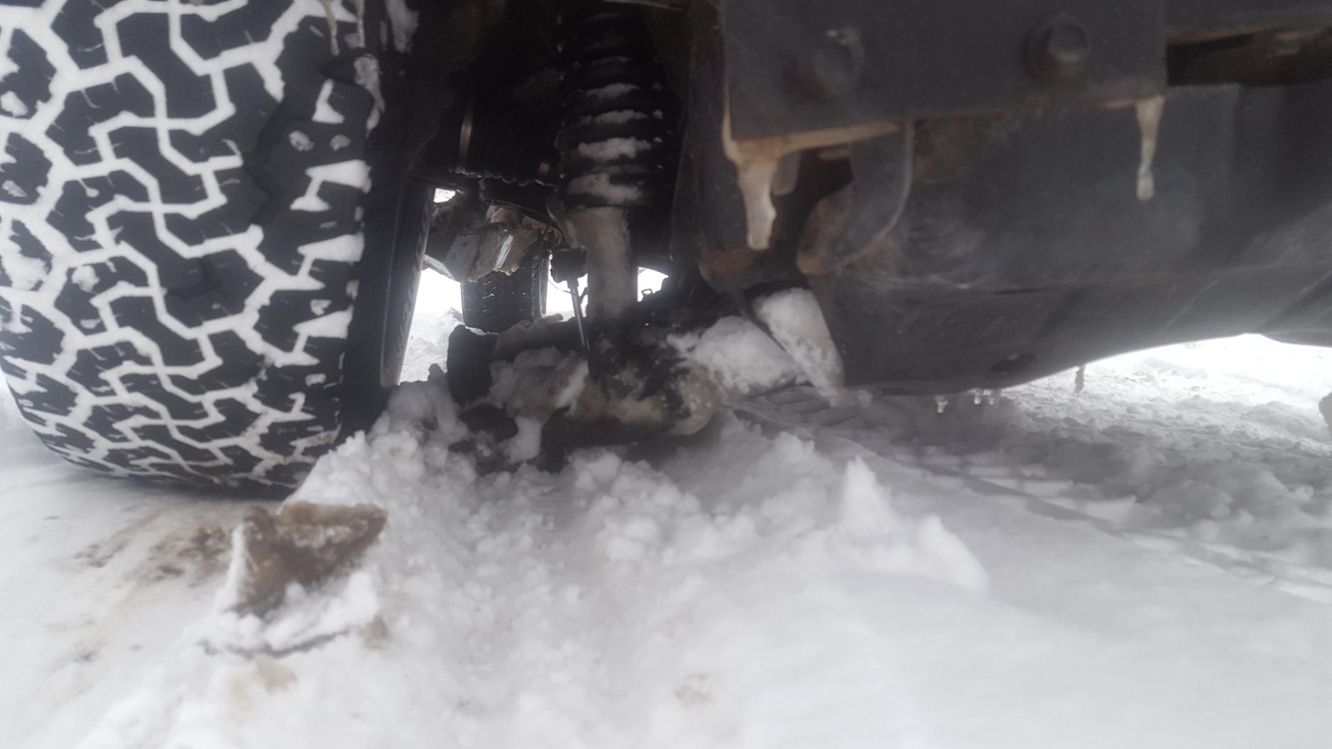

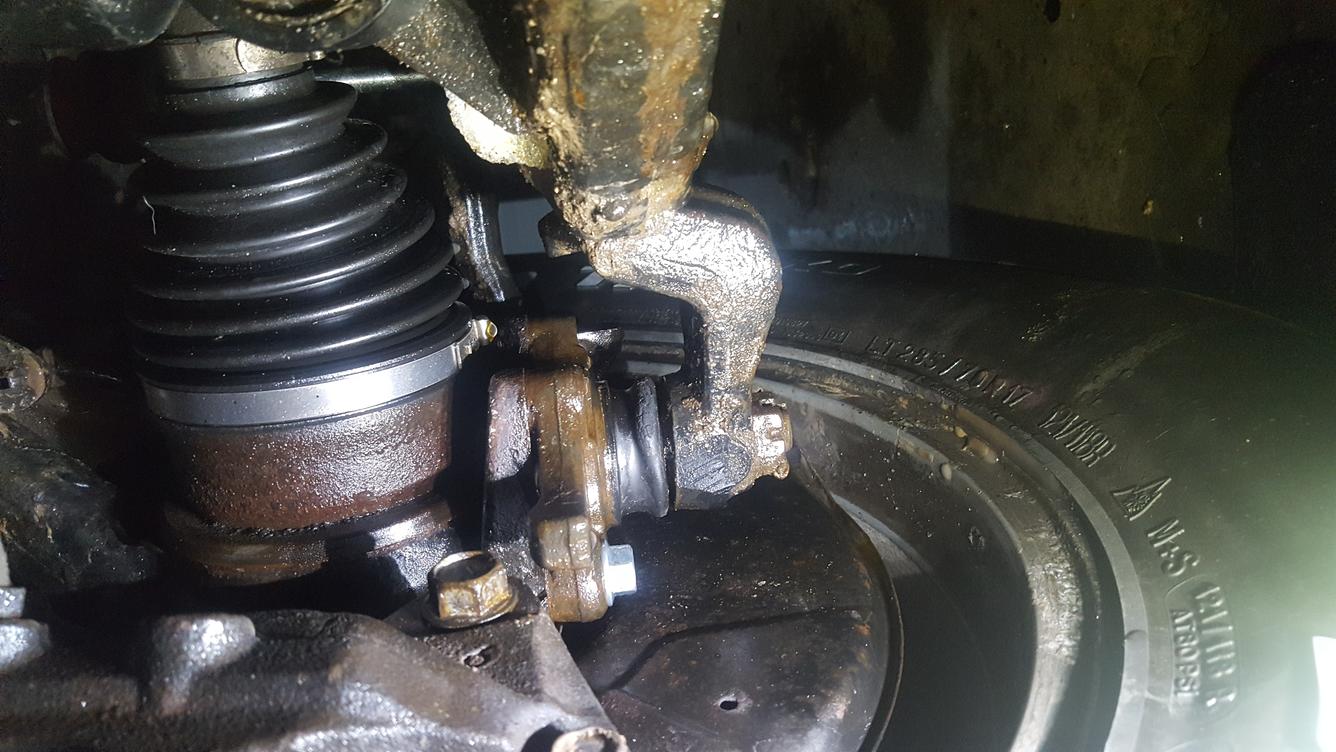

Trying to remove the snapped bolts on my lbj. Having a tough time doing though, iv tried a bolt extractor, lots of pb blaster, a torch, not much luck though. The 2 outter bolts got worked out and the 2 inner ones snapped. Any advice would be great
so your lbj failed because the bolts sheared off? Pics please
Quentin, those pics hurt to look at. I never had the 'touch' for sheared bolts (read patience).
Sorry about your loss. What was the overall damage like? Had you ever replaced your LBJ's?
The ball joint its self is fine, it mounts to the knuckle with 4 bolts, 2 of them snapped. In the picture you can see a replaced outer one and a missing inner. The only dammage iv surveyed so far is the bolts, but only time will tell. The cv popped out of the dif but i got i plugged back in so i could limp it home on 2 bolts.
Remove the LBJ if the bolts are stuck in there, then drill them out if mapp or oxy doesn't work. If they are stuck in the knuckle, I would really use the heat on them before removing the knuckle. This is where an impact is your friend...
I take it the bolts were original.....
