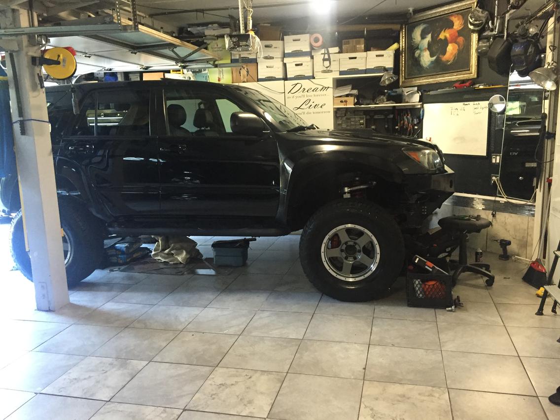

Thought you guys might wanna see a 7in front lift(lifts spindle/ome 884/ 5100-lowest). It's too much lift and I'm gonna drop it tomo. Was expecting 2in and got over 3. I'll post more pics when I button everything up.

What are you gonna do to drop it...remove the 884's?
What are you running for your rear set up?
your spring perch on your front 5100's are upside down?

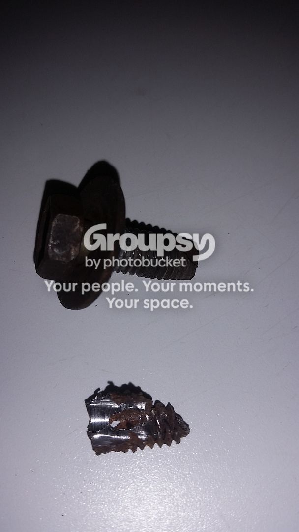

When I bought the 4runner, the previous owner warned me that there were some "stuck and broken bolts".
He wasn't kidding.
This was the very last one!
I've been drilling on this broken off skid plate bolt for years!
I got a cobalt drill bit stuck in there the first day I tried getting it out (my impatience cost me). Got some cheap left handed bits and would hit it for a half hour here, and an hour there.
When I got impatient again, I'd stop.
I finally drilled around the old cobalt bit (like 4 holes ), and used a tiny punch to push it out today. Once the bit was gone, the lefty drill bits worked like they should, and I finally beat this sucker!
The old threads were untouched. :becky:
Now to go research which stainless bolts to get, so I can put the skids back on!
M1.25 x 20mm

I'm going back to fj springs on the first perch. I might just add a top spacer to make up for the bumper. The ome's ride nicer then the fj's though.
I'm running a 3 spacer, fj's and airbags.I had a 2 allpro with 1.5 daystar and it was too stiff before. This was all before they made 3 in springs. For shocks I'm trying a 5160 with an extension
Ome is known for random lift numbers and I don't have time for them to settle. i never took the perches off to adjust them. I wish you were right though.

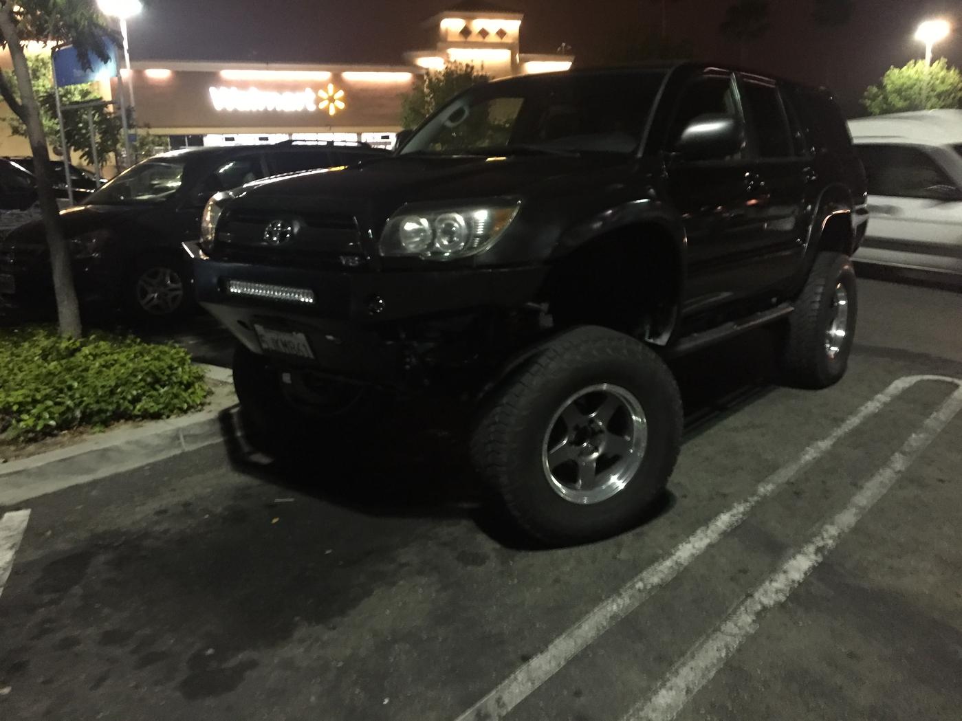

Just got it switched back
