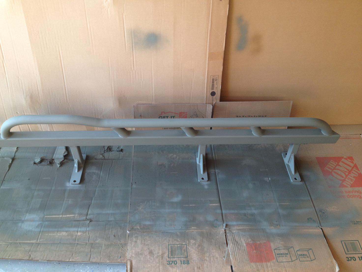

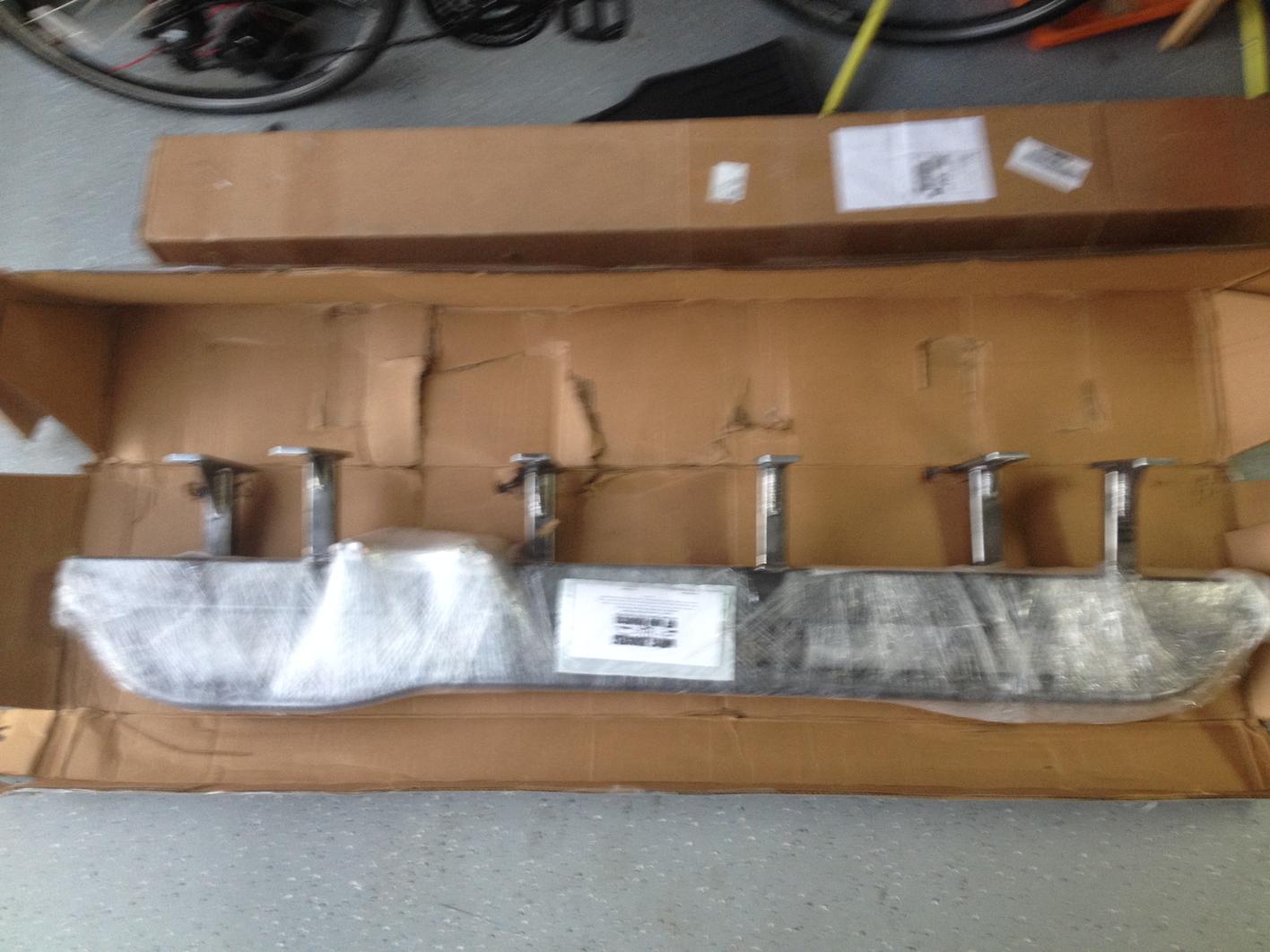

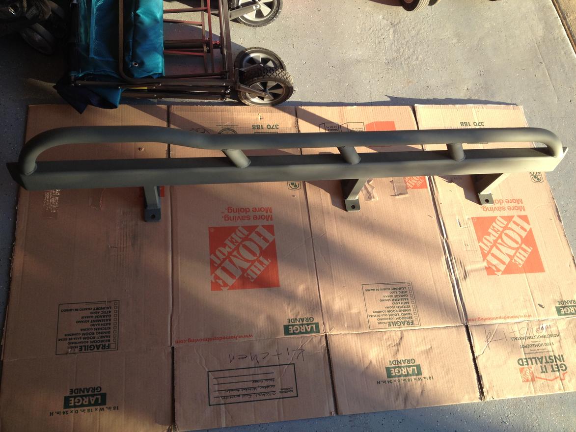

Also got to unwrap and work on these beauties. Now I just need to find a little time to install them.
