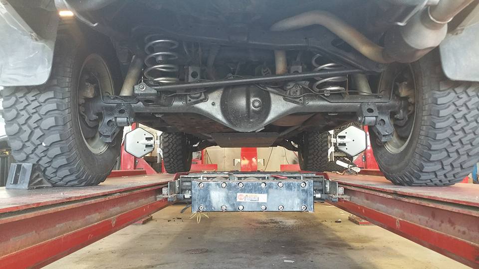

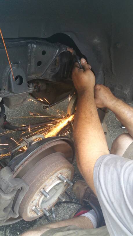

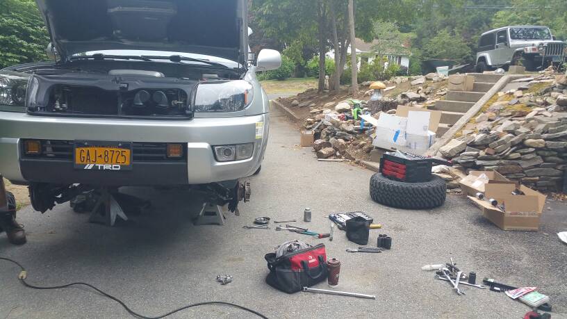

Went up to CT to visit a fellow forum member yesturday and do the complete suspension overhaul! Also took it for a quick trail run to test it out.

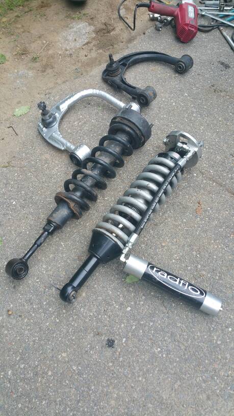

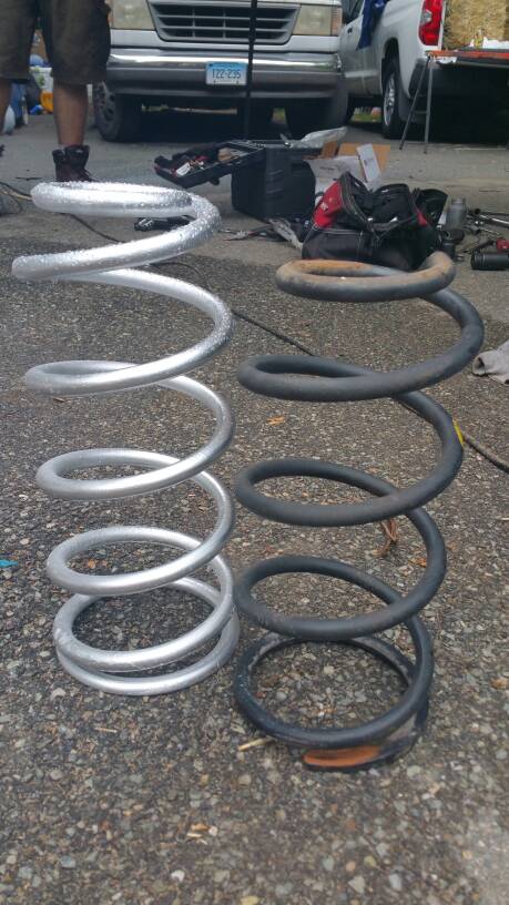

Xreas and daystar are gone along with front swaybar and I cannot express how much better it is in every way and I haven't even driven it with an alignment yet.

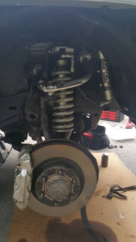

Upfront..
Radflo 2.5 ext travel coil overs with adjustable remote resi's and 700lb coils
JBA ball joint upper control arms painted silver.
Front sway bar removed.

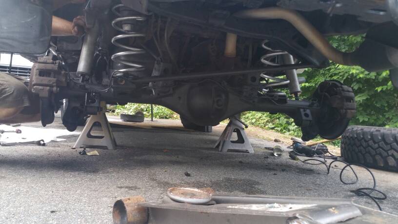

Out back..
Radflo 2.5 extended travel shocks with 5th gen radflo 2.0 rear coils and 1.5 spacers.
Skyjacker extended rear sway bar links

Looks really good man! Liking the JBA UCA's? I installed mine last weekend, and love them. Still need to get an alignment though.
How's the handling without the sway bar? Debating removing mine..
Thanks!! Jba's seem like an great product.. The giant balljoint seems solid and extremely easy to replace if ever caught up on the trail. Also parts sourcing couldnt be easier since its a GM part.
Getting the truck aligned this afternoon so ill keep you posted how those numbers come in..
Even without the alignment its a night and day difference from before. I really feel like I went out a bought a new truck. I cannot notice a difference in body roll without the sway bar on. I cornered fast a few times and it was just as good if not flatter then before. I believe that has alot to do with 700lb coils.
Also the skyjacker extender rear sway links are much more solid then stock and im sure that helps keep the truck planted.

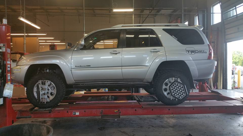

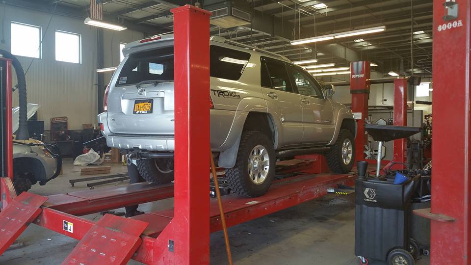

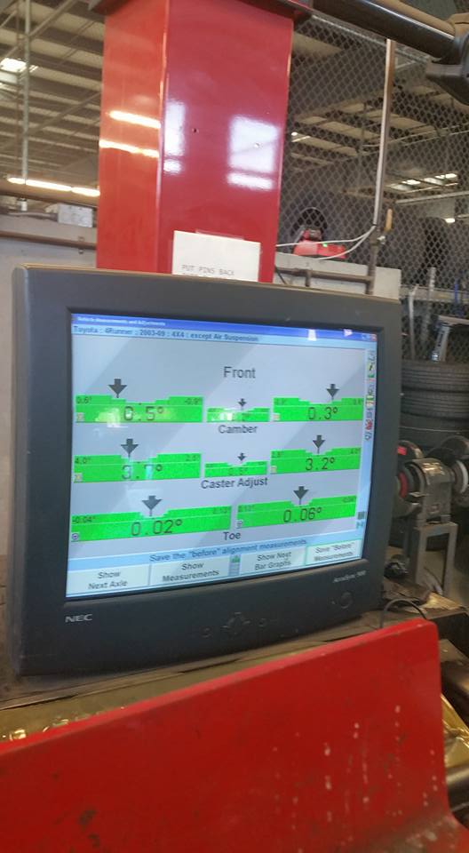

so attempt 1 for the alignment got the geometry pretty close to good but of course the steering wheel was off by 1/4 turn.. so its going back on the rack wednesday. otherwise it feels great!

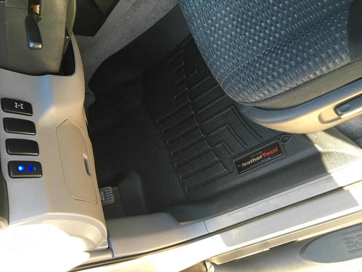

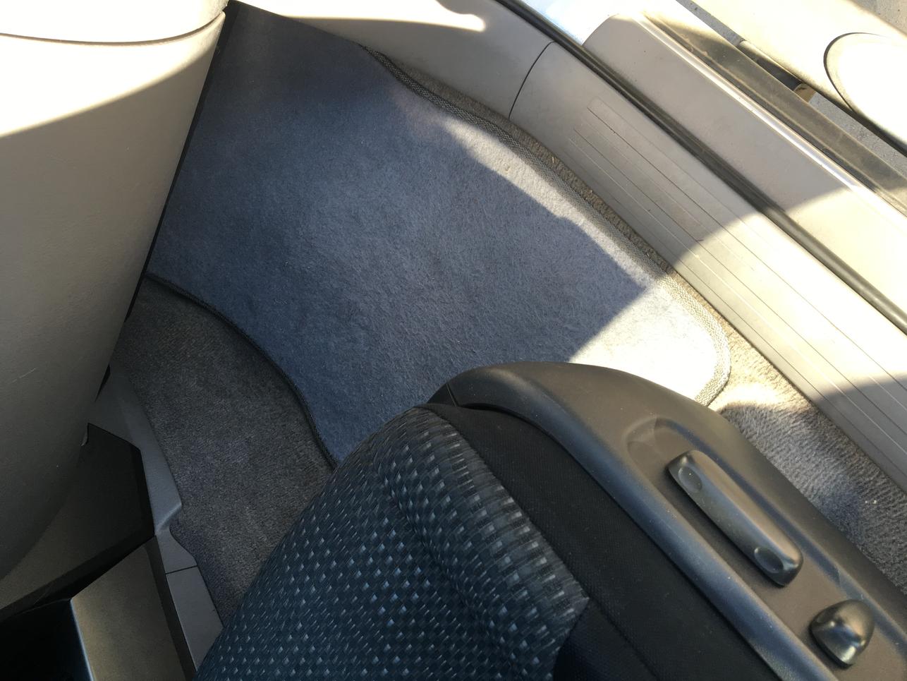

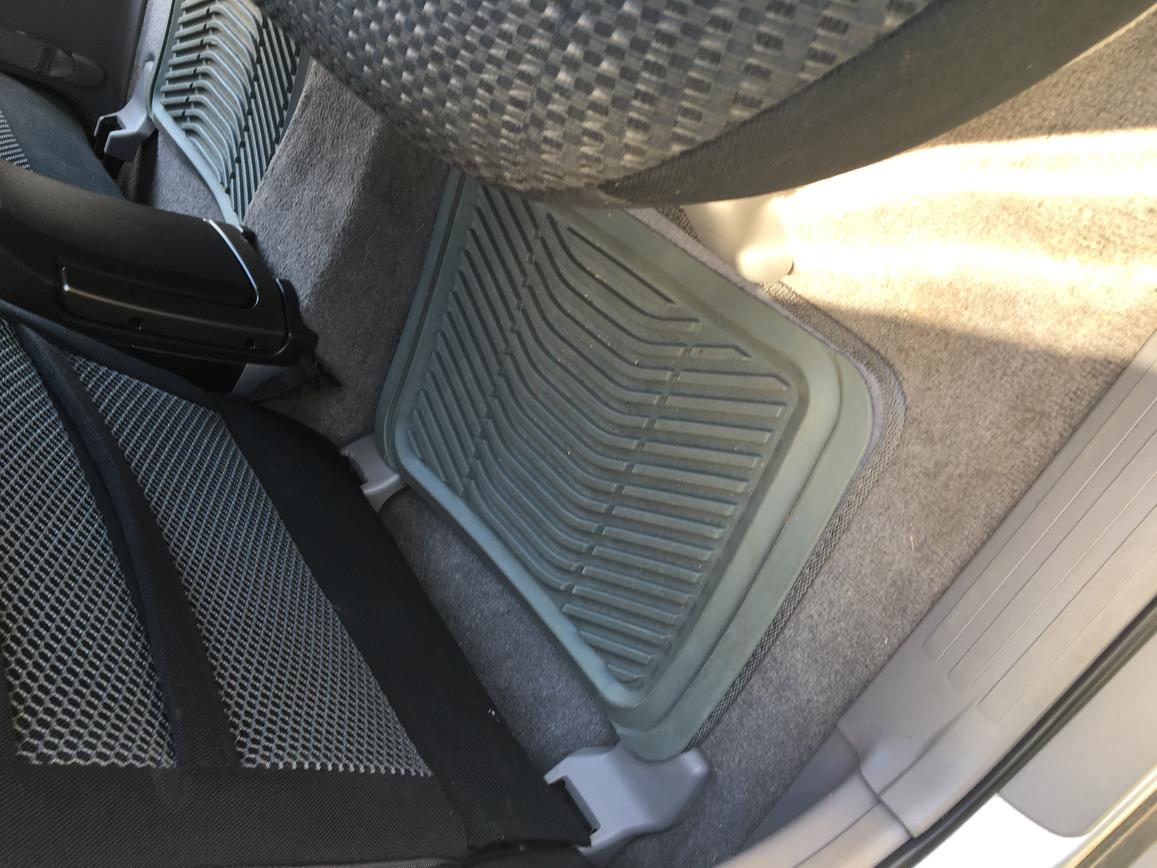

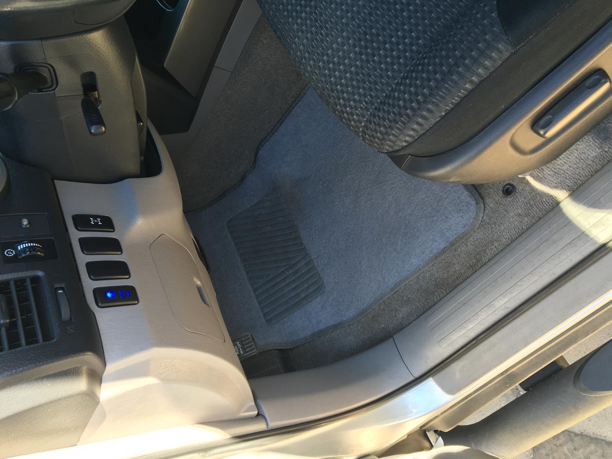

Updated floor Liners from Black Wheathertech from group buy.
I ordered 3 sets of black weathertech from group buy on 7/7/16 and got two sets yesturday 7/11/16 just waiting on Liner.
I have a few pictures to see the transformation.
First are a couple "before", then "after" of the drivers side.. front passenger and rear passenger
