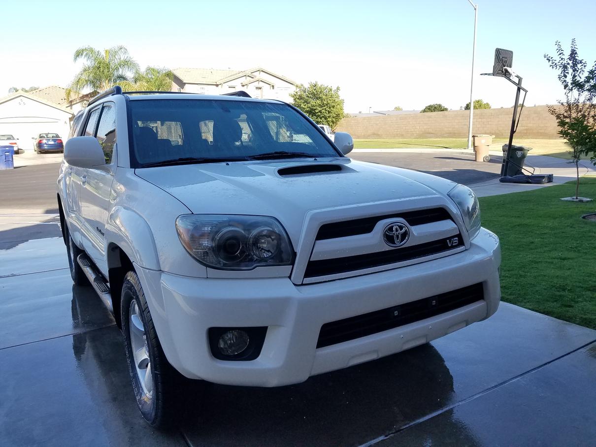

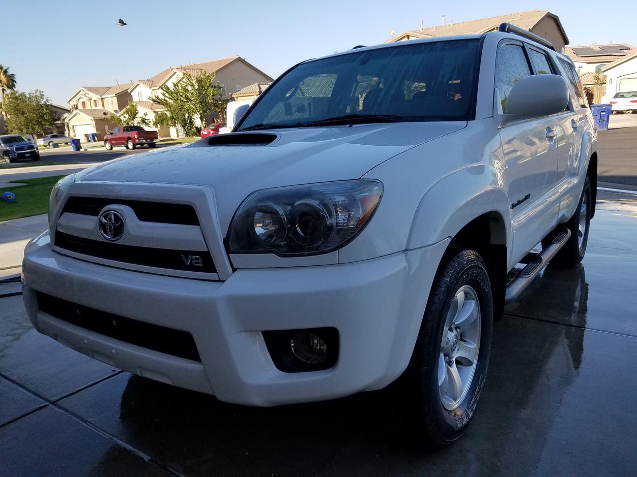

Gave it a wash and took the plasti dip off the Toyota emblem and V8 badge after installing the Limited Grill on the my Sport. Definitely like the color matched grille better. I still cant believe this thing is 10 years old already.

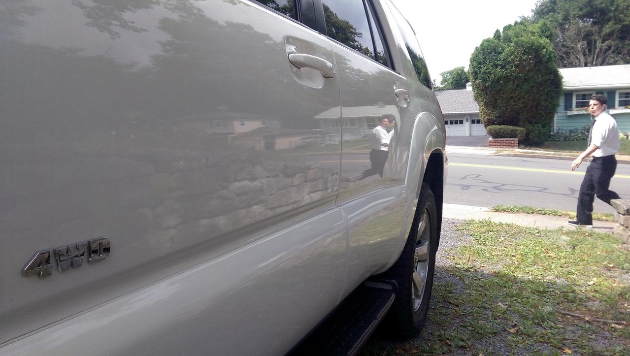

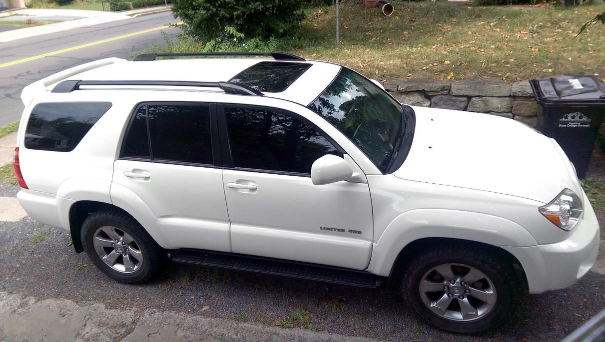

We bought our 2007 in 2012 and by all accounts the first owner garage kept it because the paint was in great shape. Our rental house hassn't allow covered or garage parking for the past 4 years it's been sitting outside in the driveway. While I've tried to keep it washed and clean as much as possible, 4 years had taken it's toll on the Natural White paint job. It was obviously cloudy, faded and covered with various contaminants. Now that we're moving in a few weeks I decided it was time to see if I could recover the paint and hit the reset button.
I started off with a wash, then clayed it, then broke out the Flex DA buffer and Wolfgang products. For extra protection I put a coat of Collinite 845 over top the Wolfgang sealant...
After 5 hours, it turned out much better than I thought it would and has me thinking I may not trade it in later this year, early next year as I was planning to when I bought my new vehicle.... It may be time to say goodbye to Carol The Corolla (2005 with 190,000 miles) instead and let the wifey drive Stella full time.
Here's the results:

Looks good! The wolfgang deep gloss paint sealant and Collinite 845 is my favorite combo! It really lasts!
