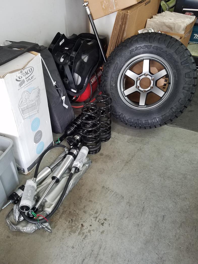

Today I adjusted my ride height on my newly installed CO's that I put on yesterday. May build my rear sway bar links today as well.
Pretty. And no that's not my pack and play. did the work at my buddies house.

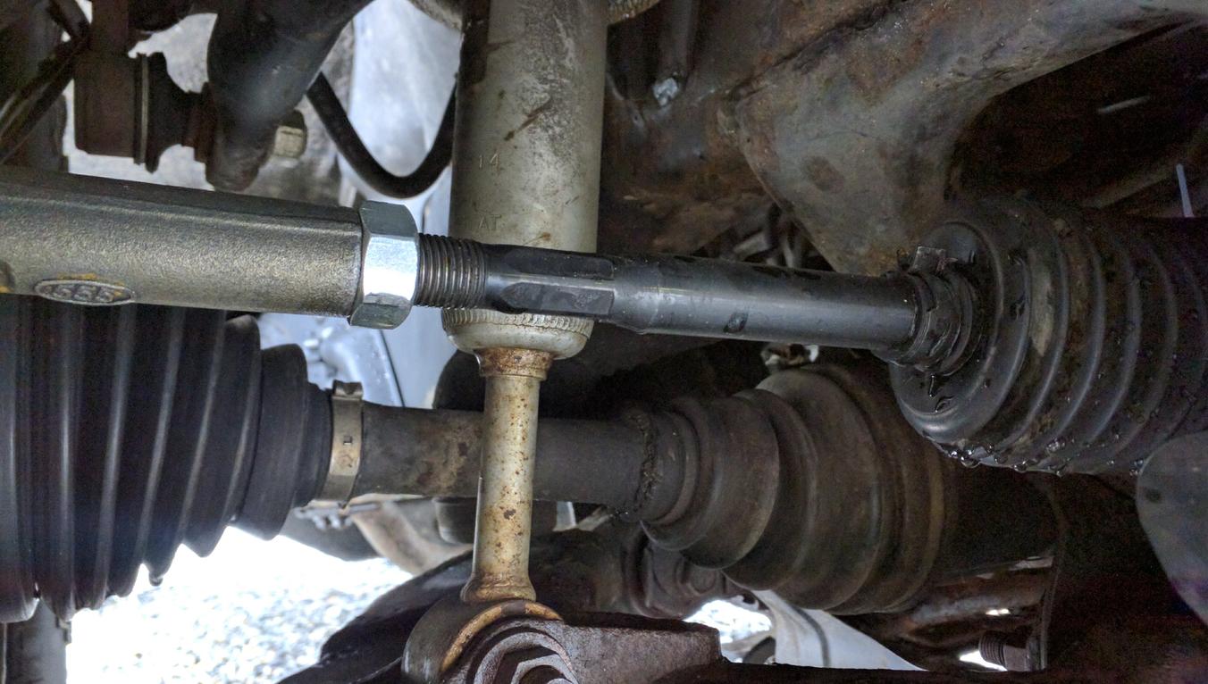

New upper balljoints warrantied from spc as well as new inner and outer tie rods. Old ones were totally trashed! Drivers side was so loose it was scary... Alignment tomorrow.

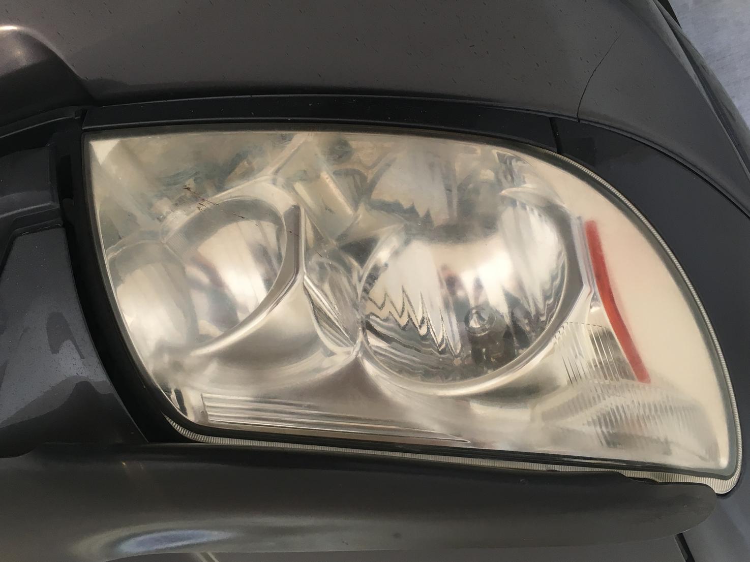

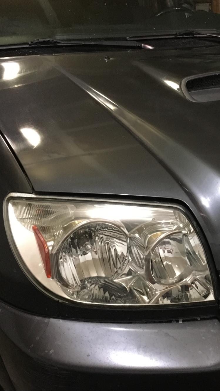

what did you use on the headlights? thanks:llama:
Wet sanded with 1000, 2000, meguiars, Polish, wax. The meguiars is a diminishing compound so it starts as a fine cutting compound the turns into a rouge polish.
Here's a before:

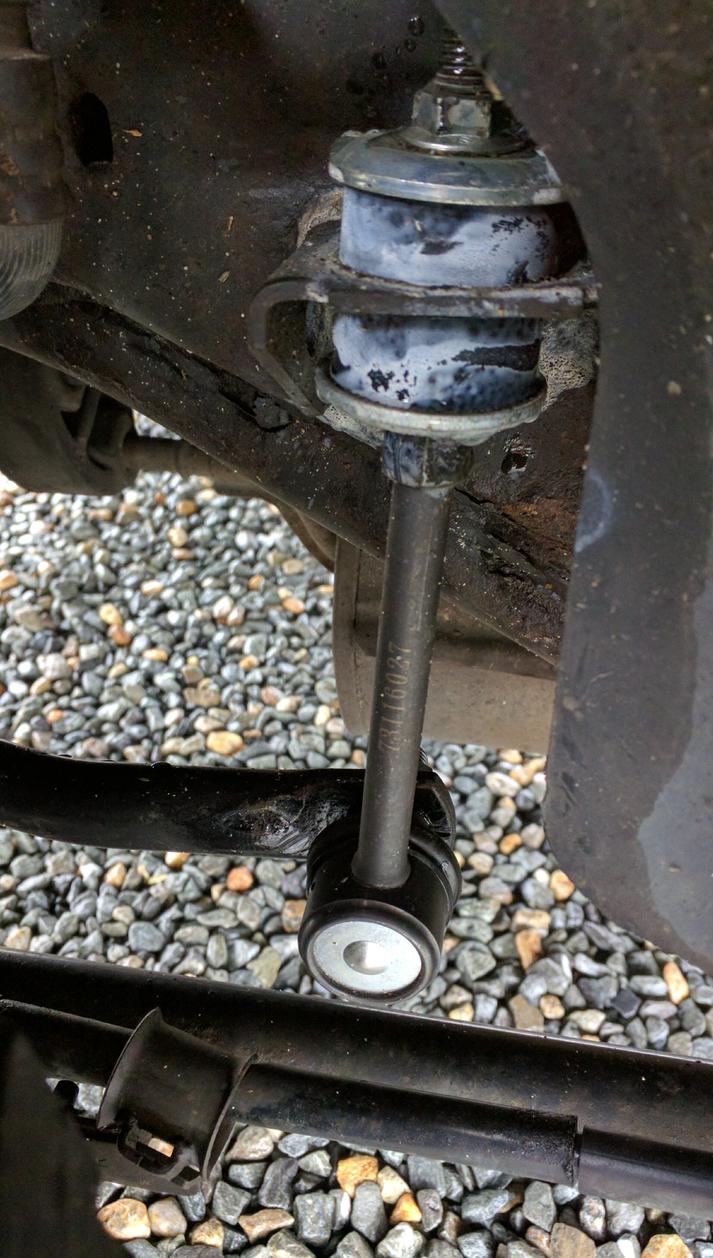

New tie rods (had to cut both of them to get the old boots off), rear sway bar links and bushings (links snapped in half, ball joint studs had to be cut). Good thing for the angle grinder!
No more clunks from the front or squeaking from the back! Whole truck runs noticeable tighter. Got the "sport" back in sport edition. Sorta.

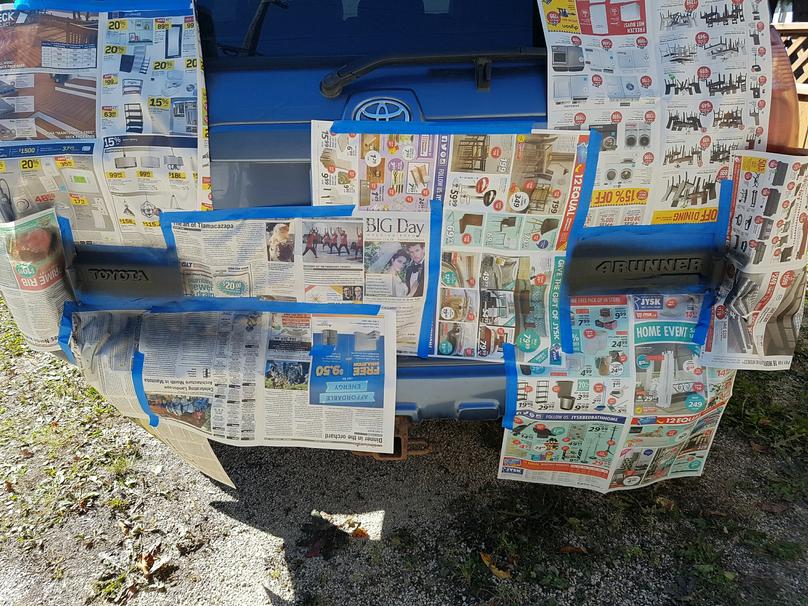

Decided to Plasti Dip the badges on the weekend
