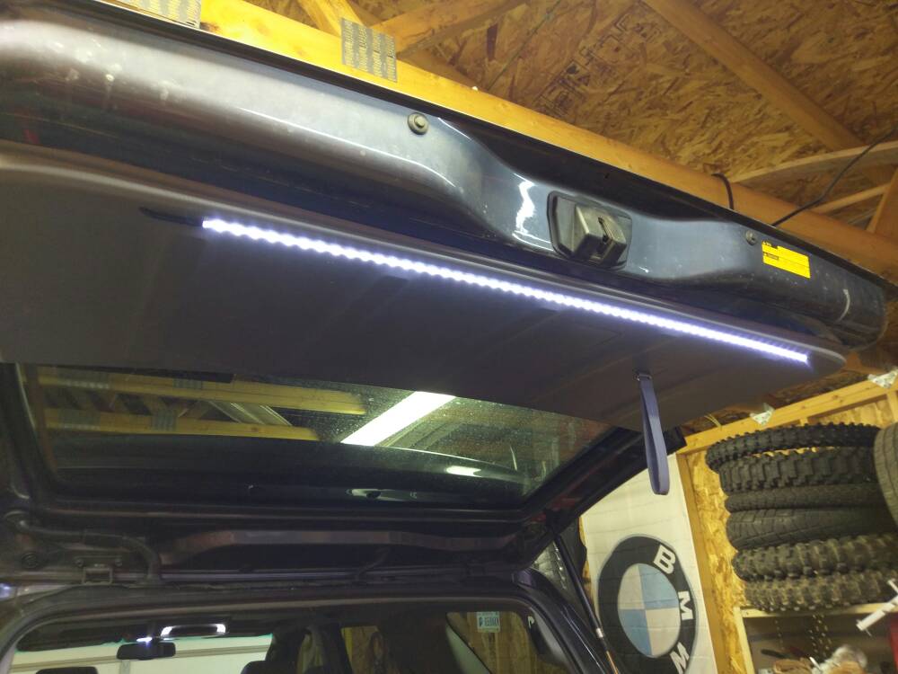

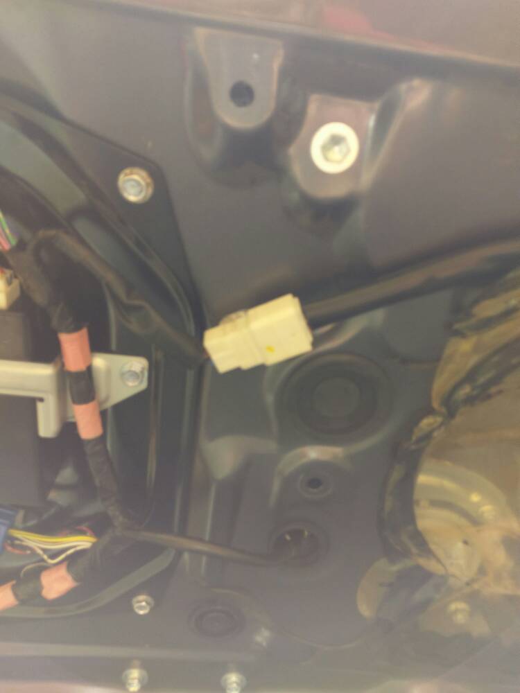

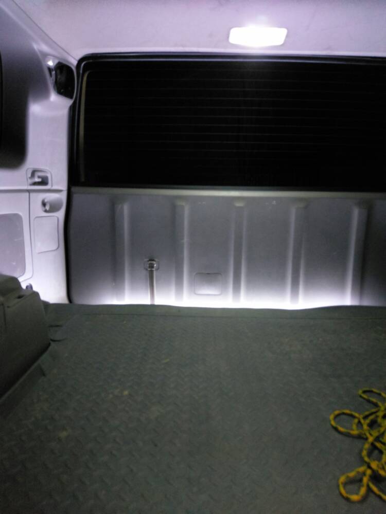

Installed a rear hatch LED strip. When my sleeping platform is installed the factory rear cargo light doesn't shine below to see what you're getting from the totes underneath and more camp light would be nice. I wired into the contacts for the rear cargo bulb so it's controlled by the on/off/door switch in the back.

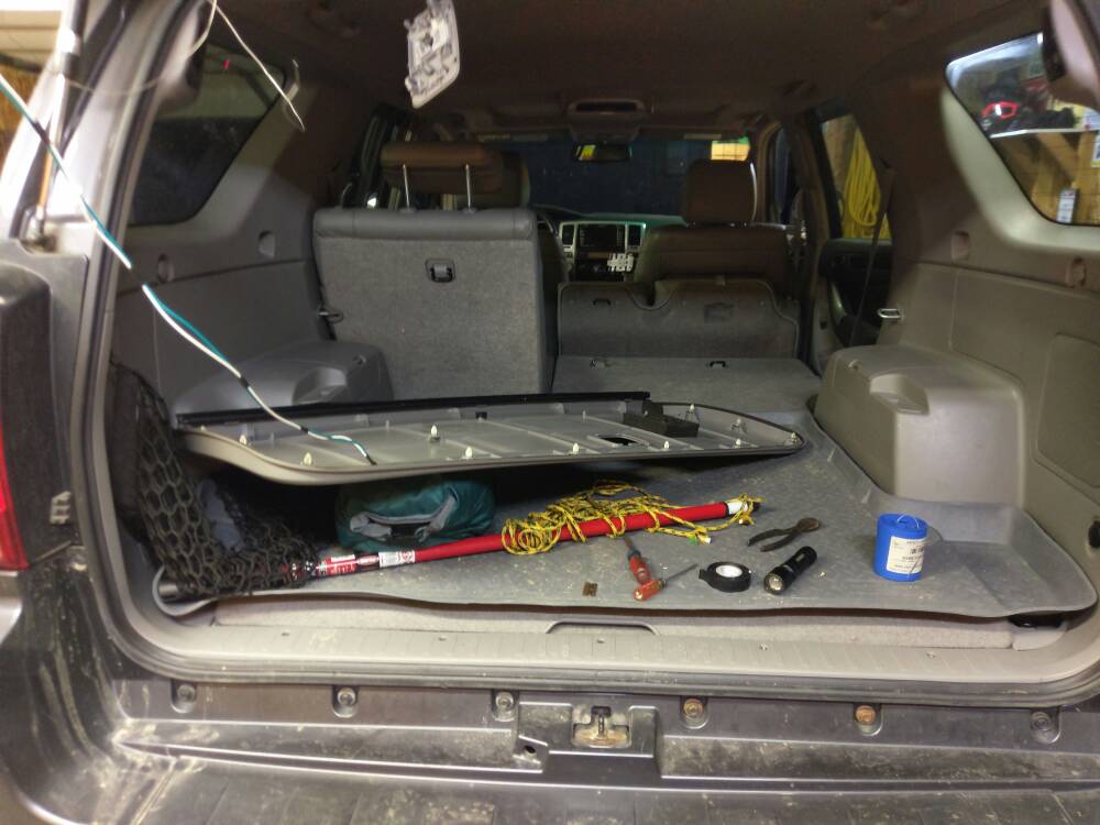

Ran through behind the panel for rear hatch module.

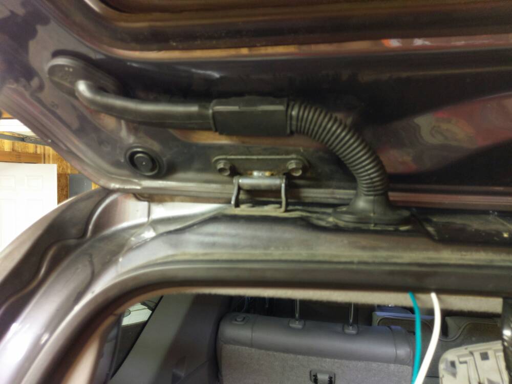

Painfully fished through factory rubber seal here....

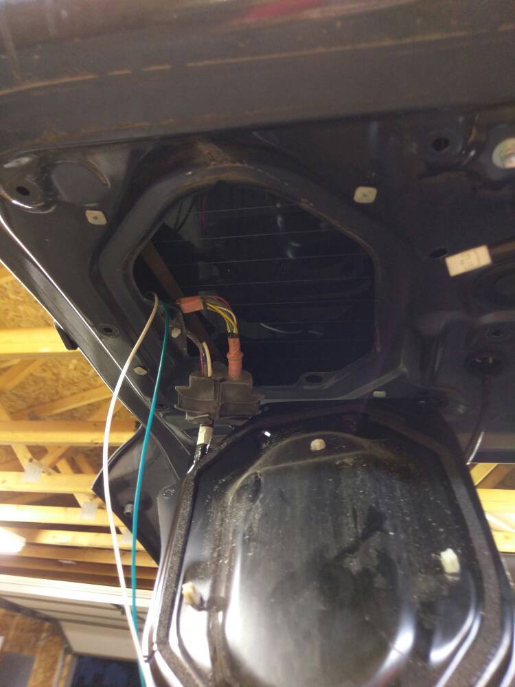

And done! Except for the panic moment when you close the hatch after and it doesn't open back up....
Turns out you shouldn't unplug the plug to the latch motor when the hatch is open or it will fault the system since it doesn't know it's location. After some cussing and foruming (thanks t4r.org!) I figured that out and unhooked the battery. Bye bye radio stations but after a normalization the hatch worked again.
This plug.

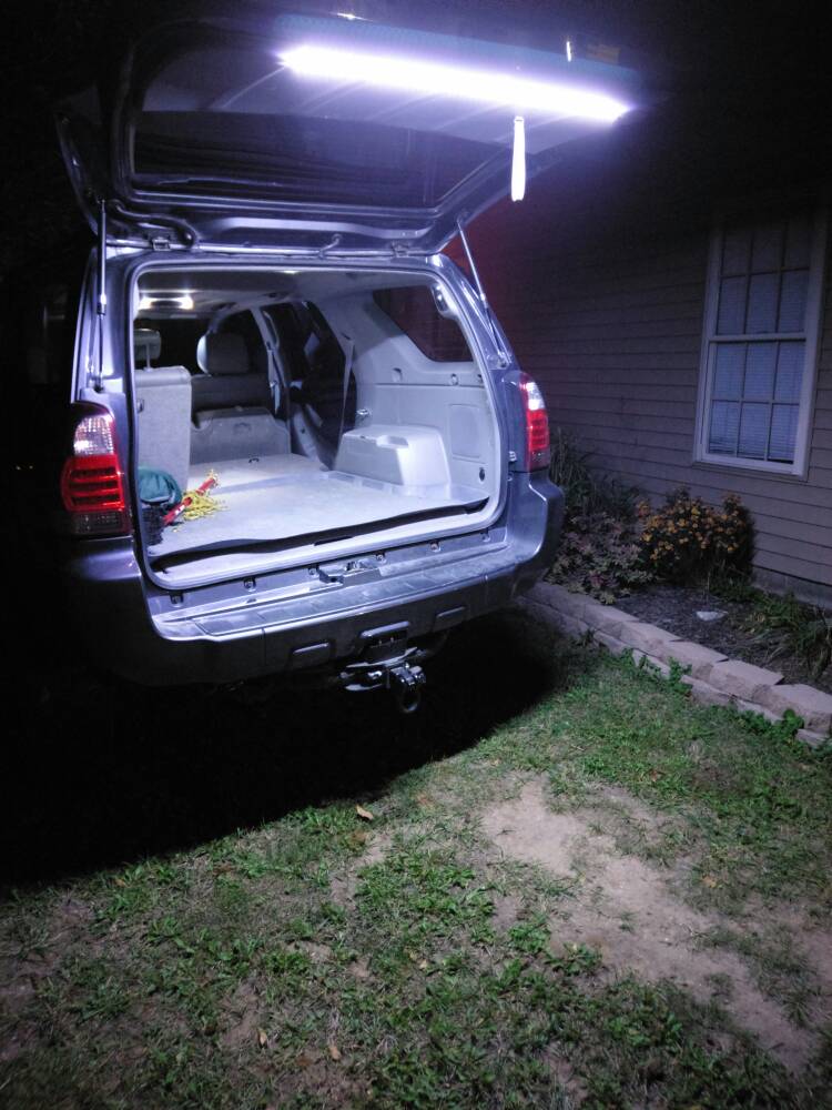

And here's the light it throws open and closed.
