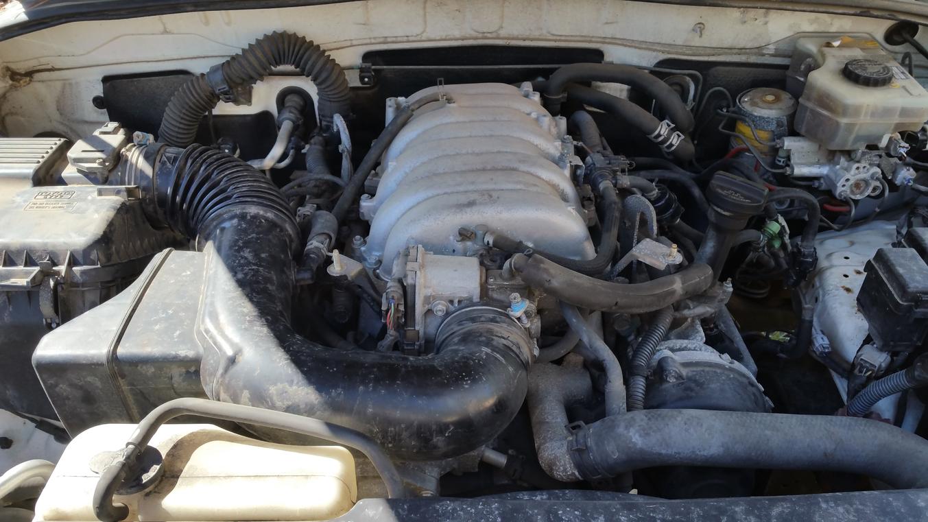

I haven't driven my t4r in 3-4 weeks. I have been saving money because my commute was much longer than normal. Here's the deal. While the truck was not being used, I cleaned the throttle body while it was still in the truck and tinkered with some things (nothing else mechanical). I just drove it for the first time and my idle seems a bit high. Not bad, but a bit high. Who knows. Maybe I just forgot how my truck feels. My question: What do u you guys normally run at idle? Anyone experience a higher idle after cleaning the TB? (Yes I am mechanically inclined. I'm just bouncing ideas around)
03 V8

Disconnect both battery cable ends. Touch them together for about 10-15sec. Reconnect them to the battery. Start the vehicle and let it relearn throttle stop.
I get that the ECU needs to relearn the air to fuel ratio. I fully expect it to come down. It just caught me off guard being high. Maybe it was the exhaust that made me over exaggerate. I just wanted to confirm a normal idle RPM range, and to be sure that my experience is normal for this particular vehicle.
Side note. What is the benefit to touching the cables? Strictly for my curiosity
Touching the cables together dissipates any electricity still in the system, if you will. The computer can still hold memory for a little bit when the battery is disconnected.
Yes the high idle is normal. You just cleaned out the carbon on the throttle plate which took up the gap that is now there causing a high idle.
