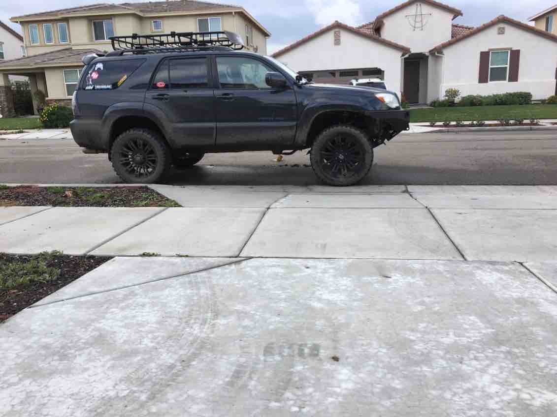

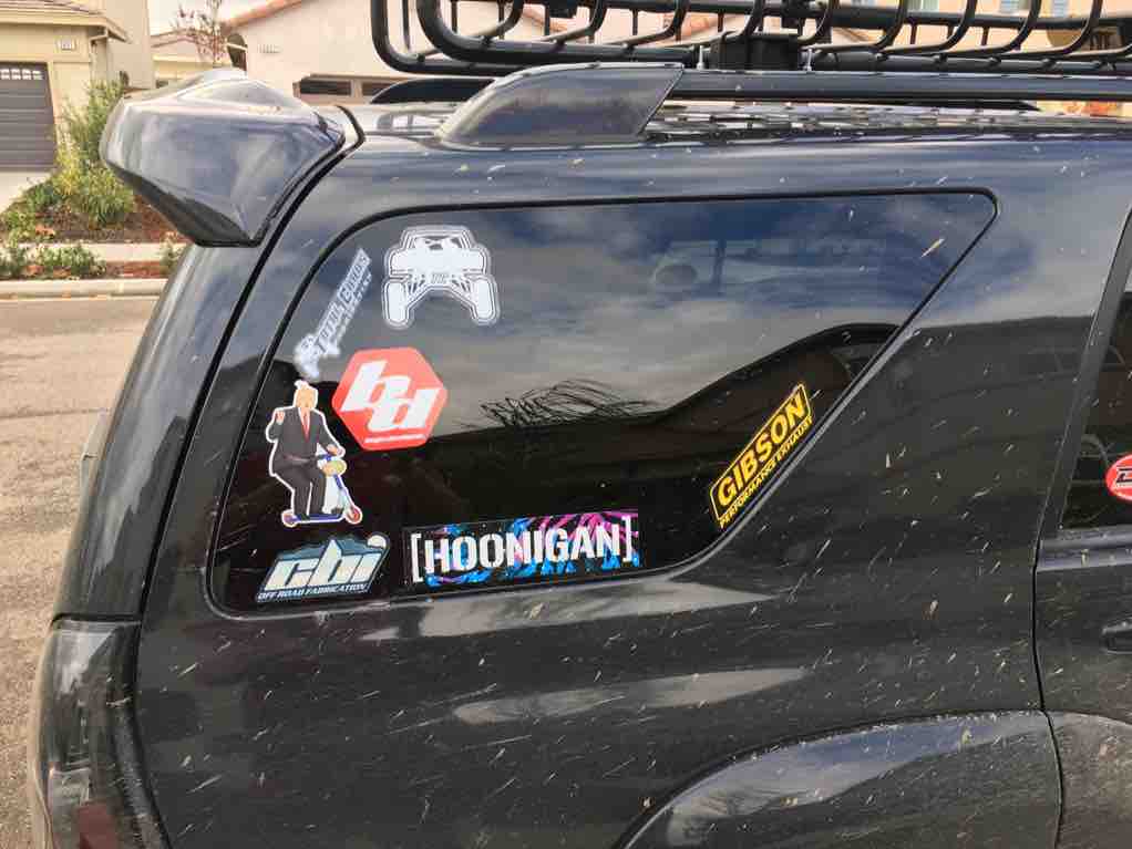

Got her aligned and surprisingly they exceeded my expectations of numbers. Drove down the road and got a new muffler installed then played in the mud for a bit since it finally rained out here. Lastly added some sticker bling! [emoji41]

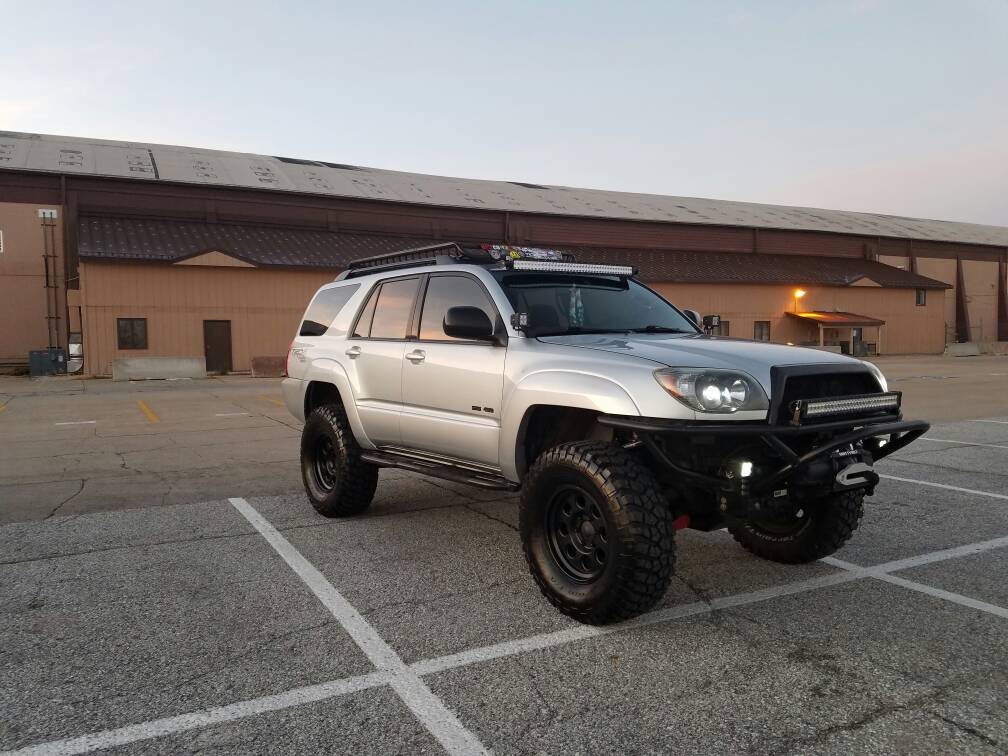

Went out to take some pictures and enjoy the nice day!
I also put my "Ordinary Overland" decal on and re-installed my Front Runner jerry can holder and Plano rifle case on my Front Runner rack.
