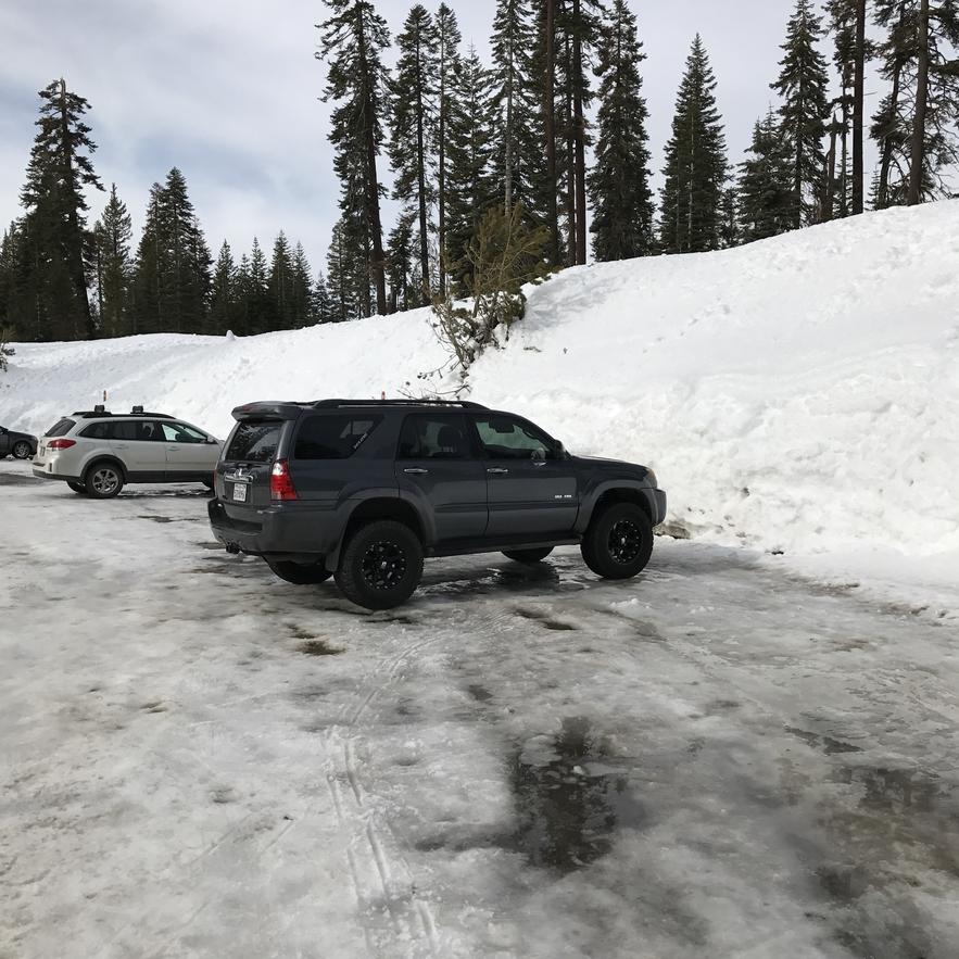

Took her to the snow.

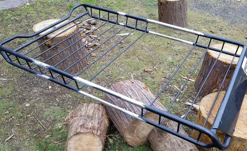

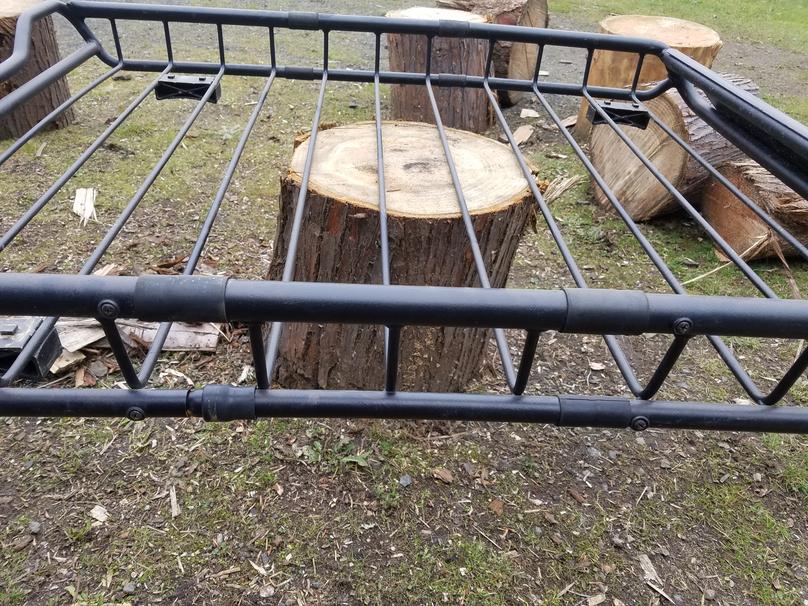

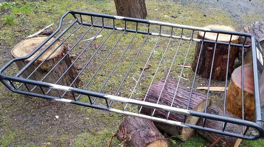

scored a free roof rack a couple months ago but it was just too short for my liking and it screwed together so you could add an extension and I didn't like that or the little rubber sleeves that went over the seams either..so i welded up the screw holes and went and got some 1" and 3/4" steel tubing for the top and bottom bar and some 1/4" for the floor.. still needs paint or powdercoat but got all the fab done today..can't complain about it I'm very happy for the I'm $17 bucks into it.. I added 12.25" in overall length, waiting on the bedliner to dry and ill get some more pics
