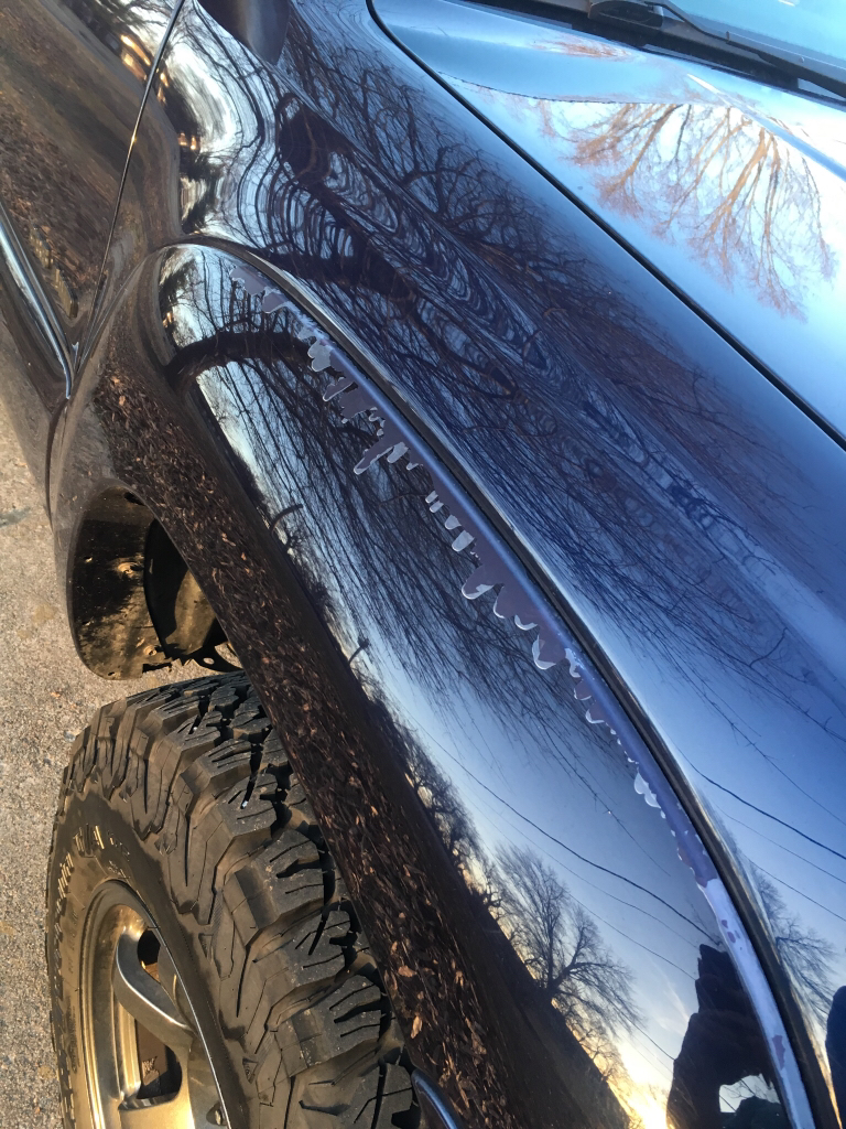

Any of you guys have any suggestions on the best/cheapest way to repair this chipping clear coat on my fender flare...it drives me crazy

Body shop will probably be expensive if you dont mind a little project tape it off and sand and paint. Just an idea :artist2:

You need more trail pin striping. Lots more. It will make it a lot less noticeable.

That's what I was thinking, sand it as good I can then spray clear over it myself. I'm thinking about having the whole thing repainted in a few years anyways, I was just thinking maybe someone else had this Problem and could share how they fixed it for cheap

If you do this yourself, I would recommend that you respray the entire fender flare or you'll notice where the OEM and new clear come together, and make sure when you sand that you do "wet sanding" with the correct type sand paper, start with 400 grit in the area where it's chipping and work your way up to 1000 to 2000 grit to smooth out the clear coat, you don't need to start with 400 grit on the entire flare use the finer paper only where there's no chipping, use a water hose while sanding to keep it wet and to flush away the sanding dust, once you start seeing the colored paint on your sand paper you need to go real easy or you'll risk takng it down to primer.
When you respray it with clear do 2 to 3 thin coats, let each coat dry throughly and do a very light wet sanding with the finest paper, ending with the final coat.
agreed with the above comment...and you should definitely use a 2k clear if you don't have a gun try the spray max 2k clear In a rattle can, it's automotive 2 part clear with hardener just in rattle can form. work awesome and lays out very nice, it'll match your factory clear nicely
