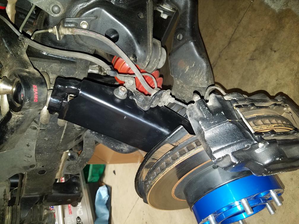

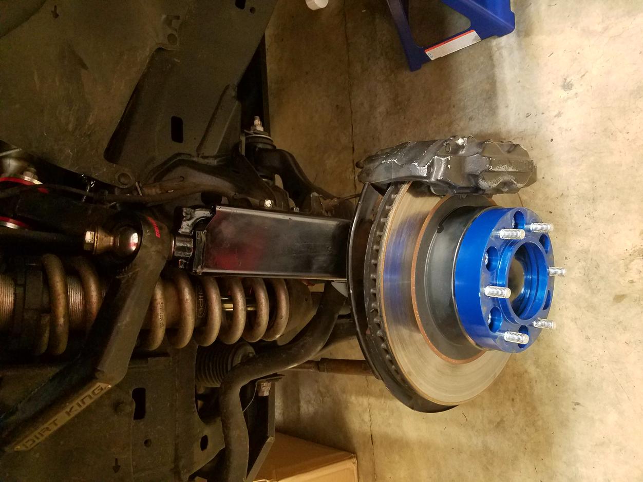

Changed my right side front axle shaft (tore the boot when I did the lift.) I also installed the inner knuckle seal and the seal in the diff. Went a lot easier than I expected. Almost a piece of cake! Hoping to do the left axle Thursday or Friday. Now I have to find some nice rugged, and maybe longer boots, to rebuild my removed axles for spares. I believe I read somewhere that Tundra boots are heavier and have more stretch and fit our axles. Can't find where I read that. Does anyone have any info on that? Maybe it was Tacomas, not sure. It would be nice to have some extra stretch to help mitigate the strain the lift causes on the axles.

I just rebooted both of my axles- screw from the RCI LCA skids will tear into them at full flex. In the process I called a few places that make HD axles to see if I could get whatever they used and they use the OEM on the outer and one used the inner while the other used the red one (I don't remember what it is) on the inner. They said that because it is like a hard plastic they prefer to use them. FYI

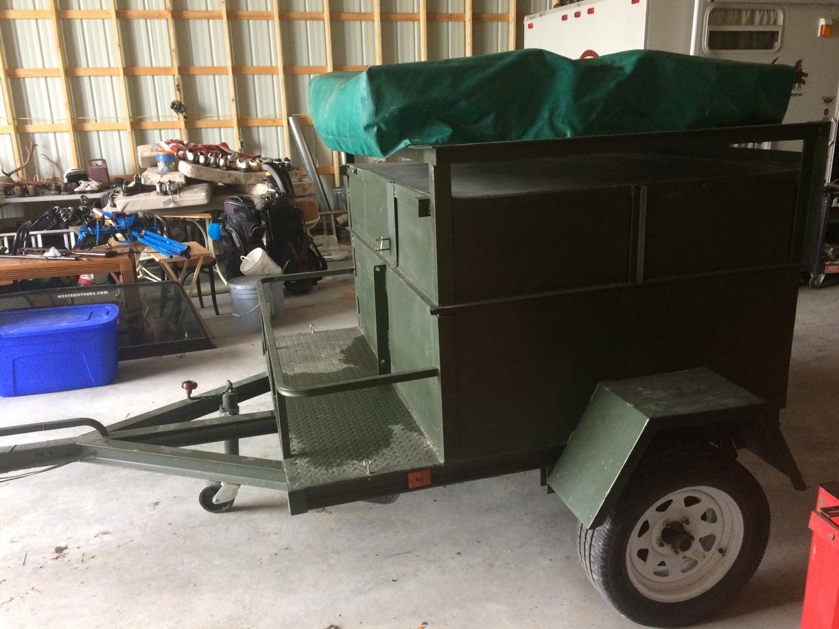

Purchased a Craigslist Special last night, and hooked her up to bring her home! Homemade steel expedition trailer with RTT. Solid. Good tires. Pulls great. Has brakes, and hope to hook them up soon.

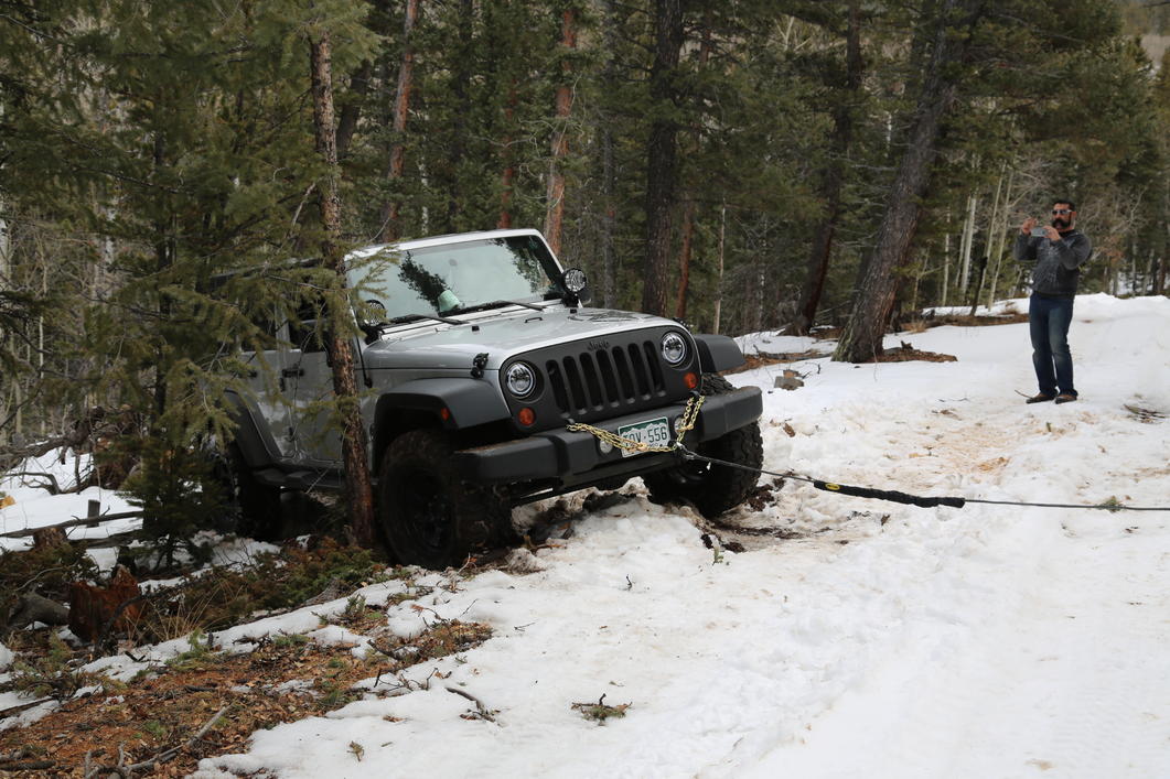

I was up at cabin doing some 4 wheeling in the snow. A jeep pulled over to let me get thru a narrow trail. He got stuck and I got to use my winch! He did not have rear diff. lockers, so he could not get out. I did a 45 degree pull with winch and it was a breeze to pull him out.

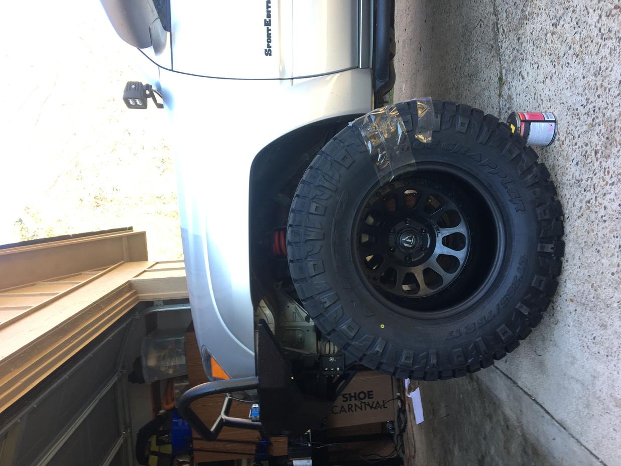

I got these in today. Should be going on tomorrow. 285/75r17 Nitto Ridge Grapplers . Yes 75. Lots of trimming to do but go big or go home. Sorry they're sideways. I'm on my iPhone.
