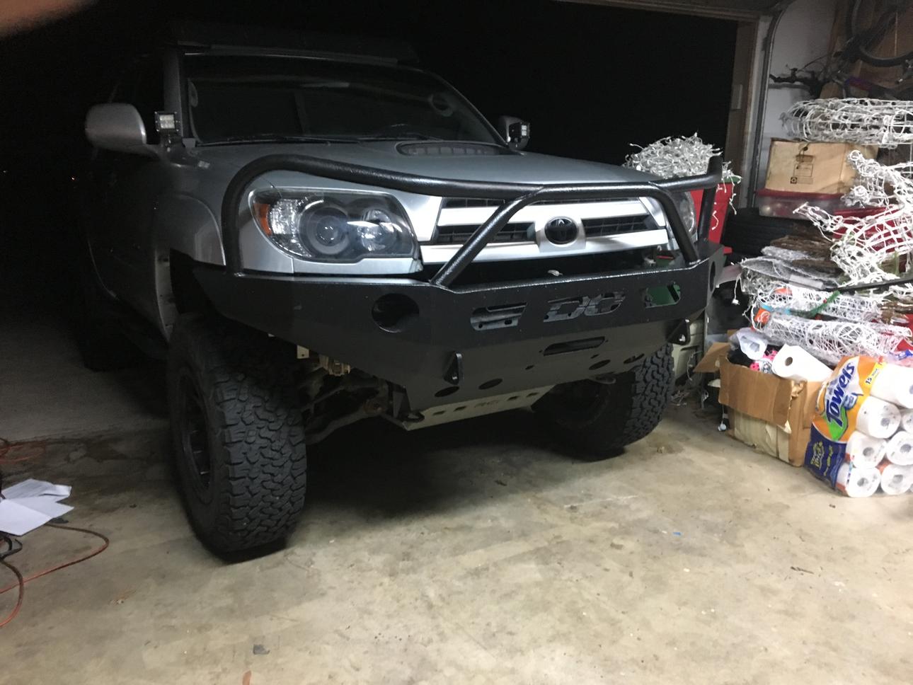

Got the bumper all mounted up today. I will take some better pics in the daylight sometime soon

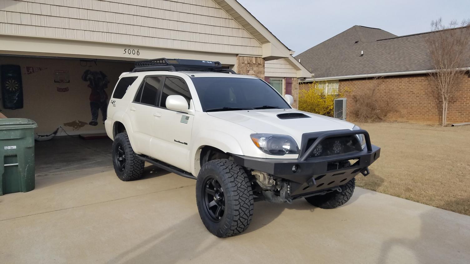

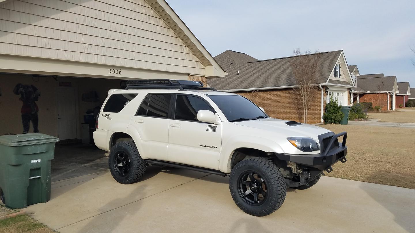

Got my RR2s and Nitto Ridge Grapplers installed. Along with my 4xInnovations sliders, and a custom built front bumper.
