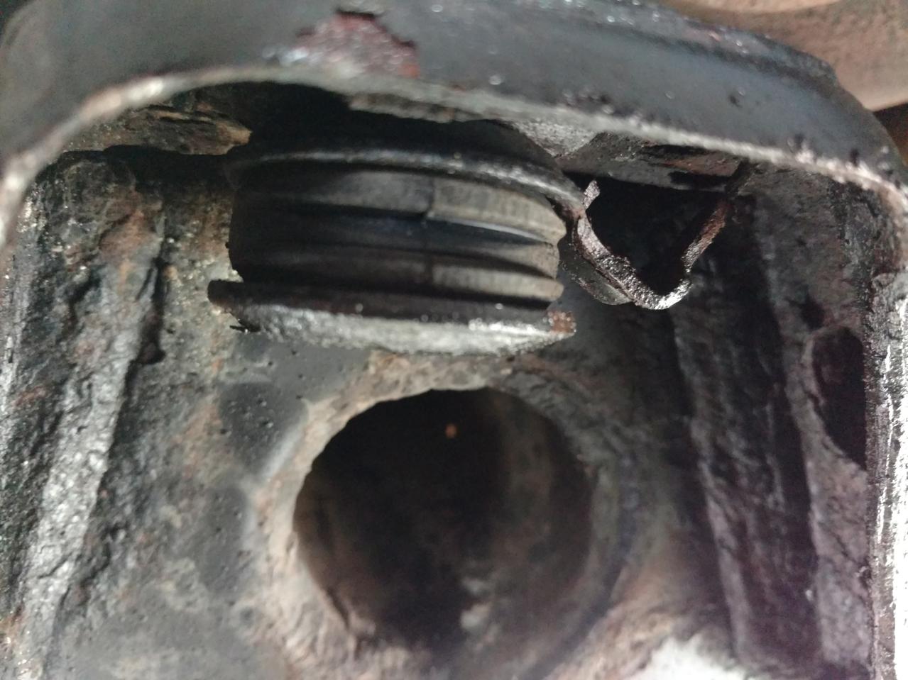

I tried cutting them off under the top bolt. No luck. Ate the blade right up. Cut the shock rod maybe?
Update: got the rear shocks off but now the bushings are lodged in. See picture. Took a pry bar to it and it's real stuck. Also, the xreas shocks bolts are different than the Bilstein's, any one else have this issue?
You have a friend or family member with a acetylene cutting torch?
