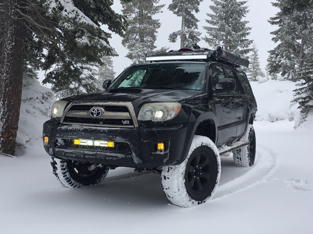

Replaced all light bars and wired them up.

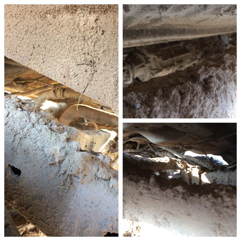

Took a look underneath my truck today and now thinking I need to clean about 100 pounds of dried mud off my frame. Sure wish mud could be a protectant undercoat! ��
Lawn sprinkler underneath the truck worked for me. I used a rotating sprinkler and moved it around periodically. That softened the mud enough a powerwash at the local carwash could get the last vestiges out that wasn't on my driveway.
Also paid a pro detailer $120 today to clean the interior. After three months in AZ on dirt roads there was so much dust in every crevice I was happy to pay a pro to clean it.
The sprinkler is a brilliant idea, thank you!! And enjoy your squeaky clean truck! Every few years I get a pro detail and enjoy it very much, especially since we live on a dirt road (understand about the dust for sure!). :)

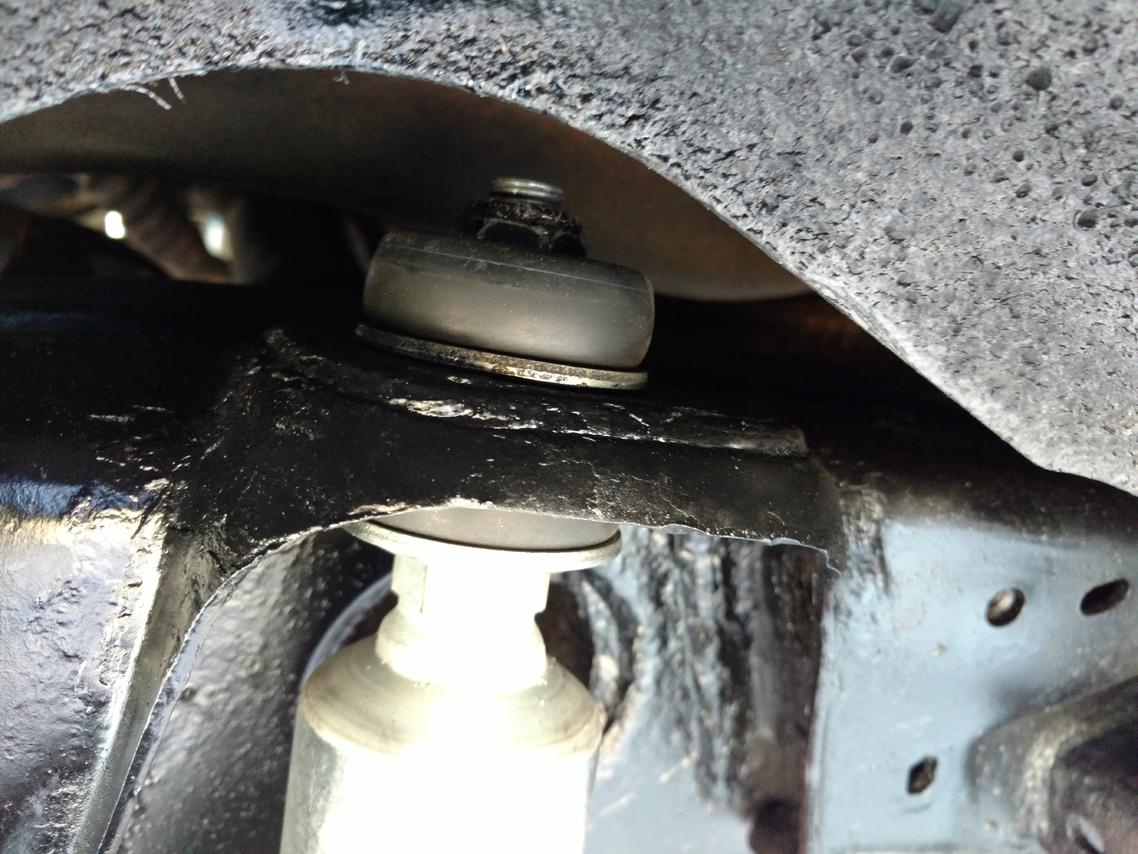

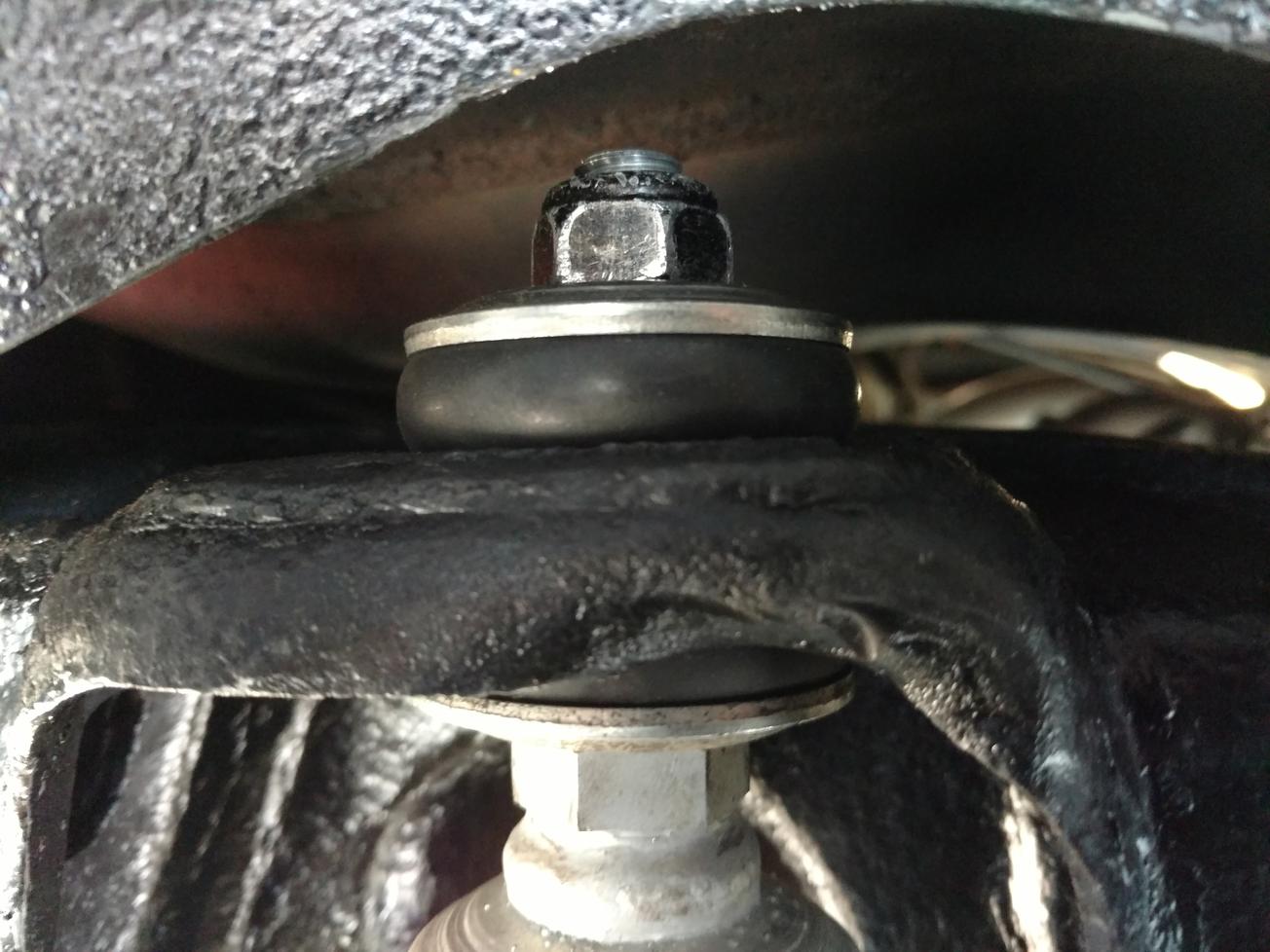

Update: you guys said hammer out old shock bushings. Bingo! It worked. Got the rear shocks on. Now my final dumb question. How does the hardware go on the Bilstein shock? See pictures, thanks.

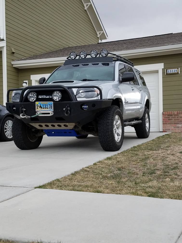

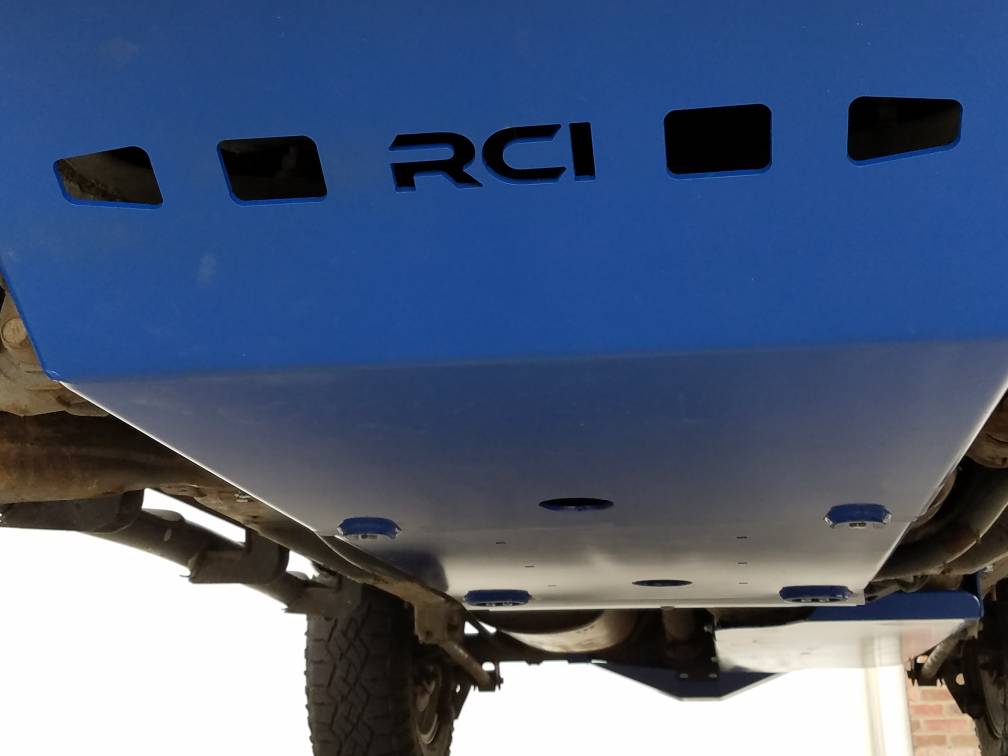

If you are going to get up on rocks with them, take them off and weld in some bracing. Lots of room and long spans with nothing. Otherwise yours will end up like mine- ~~~~
Looks good though. Like the blue. Funny, cause I'm blue and went silver. Haha

Im new to WY, im over in Cheyenne. Overall, my rocking days are done I plan to Overland this rig now.
