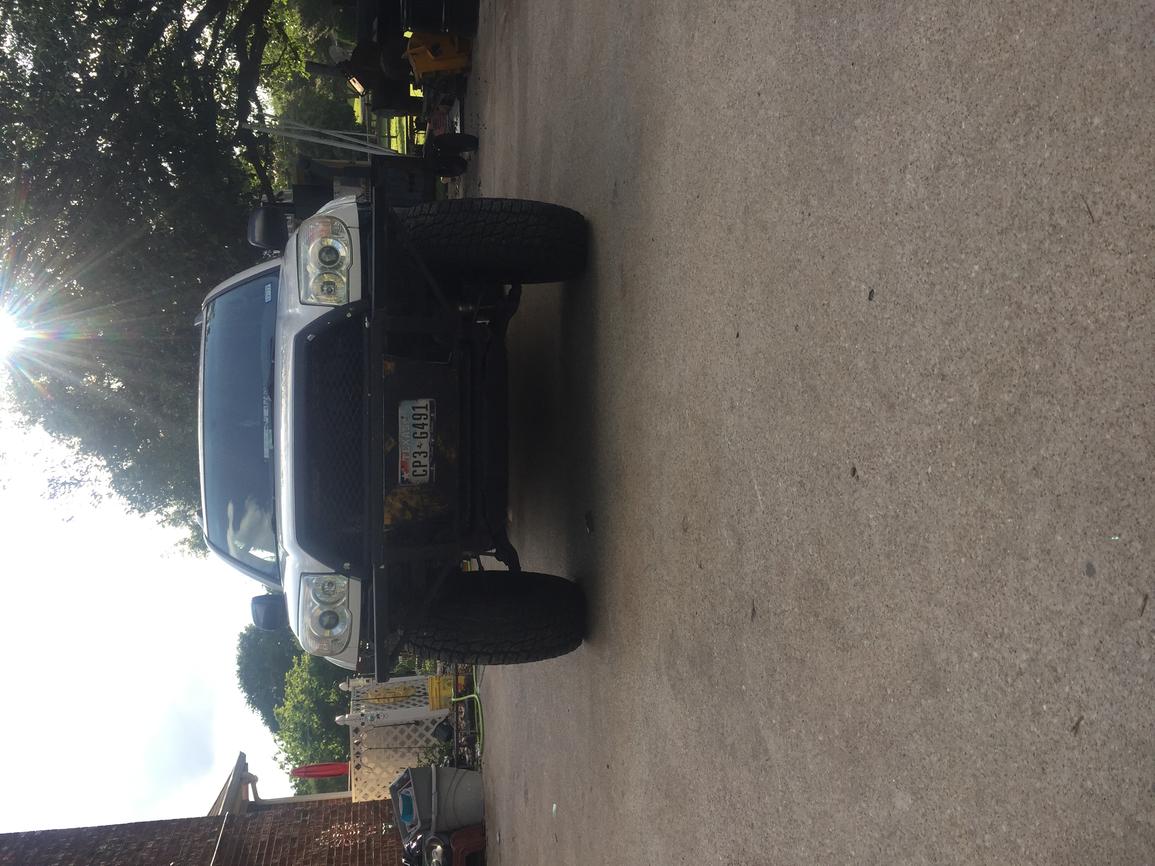

Installed OME 886 and 90000 in preparation for bumper and winch. Makes me want to upgrade the read to some long travel coils

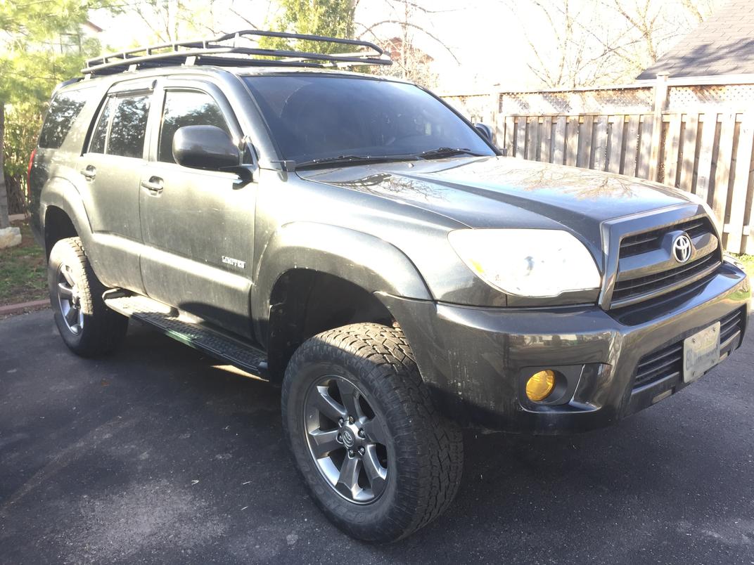

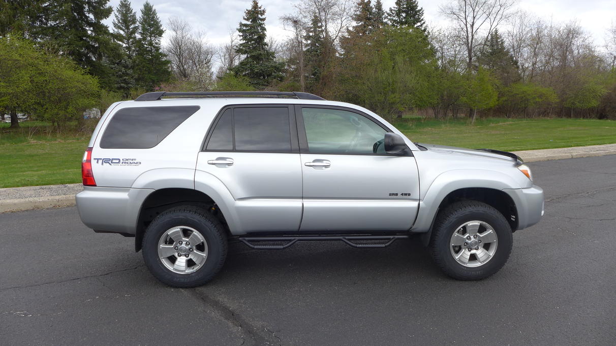

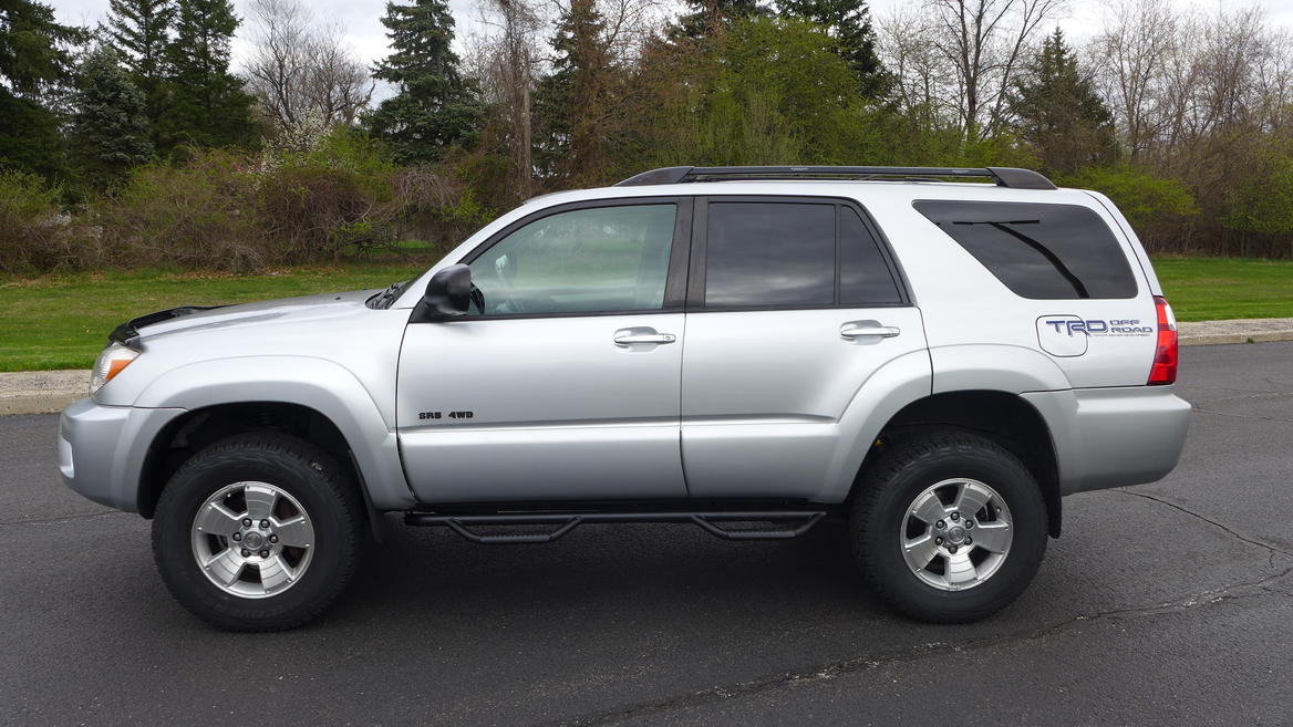

Installed some N-Fab nerf bars. I like them. They look pretty good and are functional.

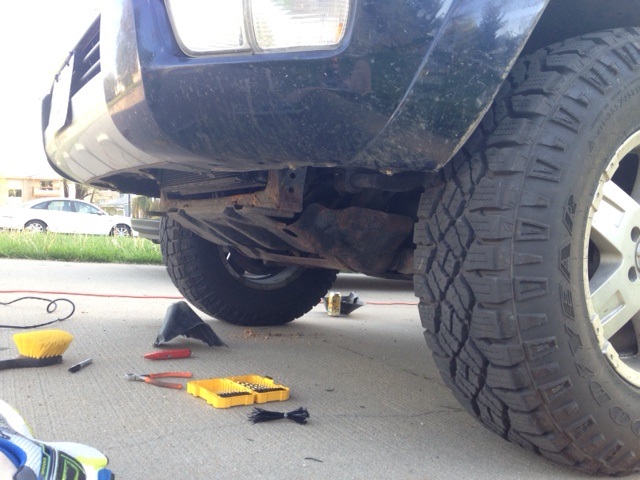

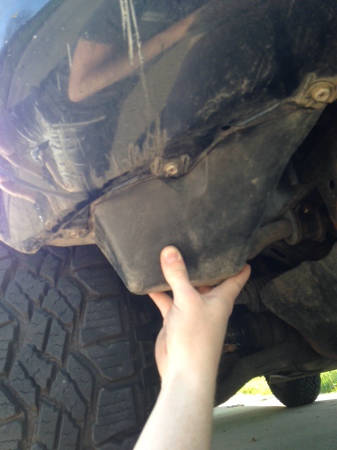

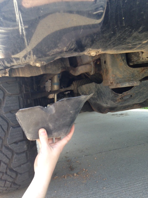

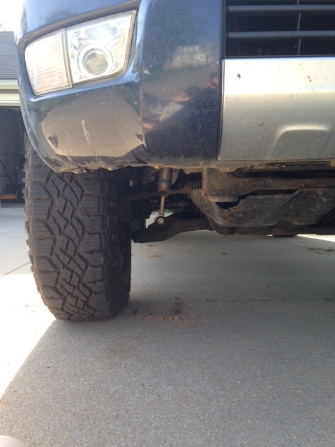

Trimmed front bumper/inner fender liners

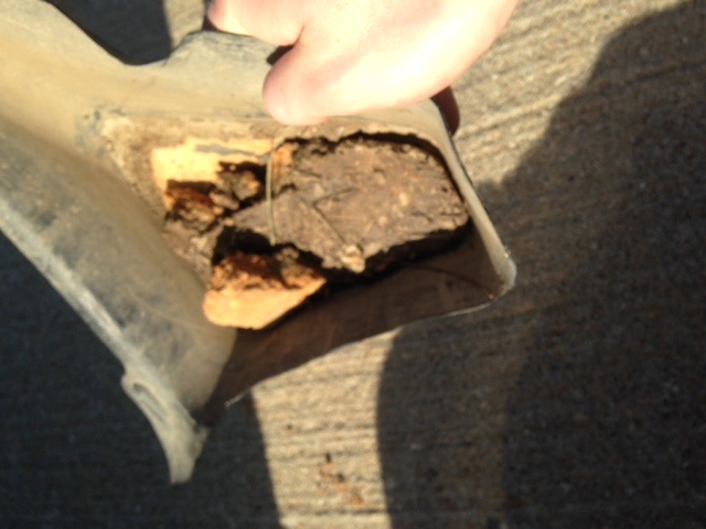

I got a hair to trim the front bumper just because (trail rash is already prevalent, and paint damage is borderline severe). The passenger side catch had about 3 lb of mud/clay/stone fragments caked in it and there's no telling how old/how long it's been there. It looks a lot better to me!

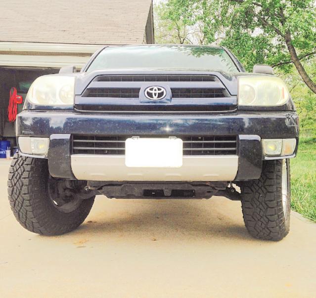

Lowered my left coil over a smidge after installing a top spacer a few nights ago now that i filled up with gas, both sides have equal preload and sits pretty dead level with a 3/8" top spacer on the drivers side
That's a great idea! One day I noticed the catch on my rig was leaking water and I put my finger in the hole to clear the rock that was plugging it and a ton of water came out. What did you use to cut off the catch?

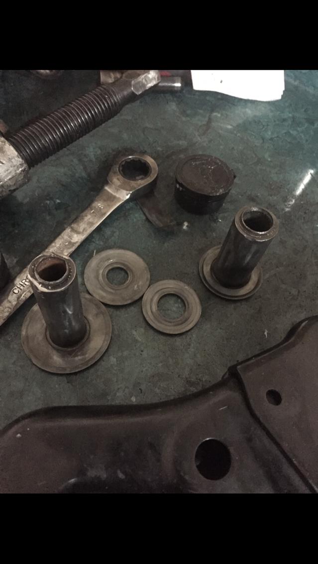

Grinding LCA bushing washers and burning rubber! Going all poly control arm bushings to tighten up some slop.
Great feeling, i used a balljoint press and torch to remove the rubber then reattached the washer looking part with the same press and a 1/2" extension rolling the lip to secure the two.
A box knife, actually! I put in a fresh blade and got it done in a few minutes after sharpie'ing a line. However, the first chop wasn't enough so I did this yesterday in about 1.5 hours time. Just something as an excuse to be outside and make the 4Runner a bit more unique.
