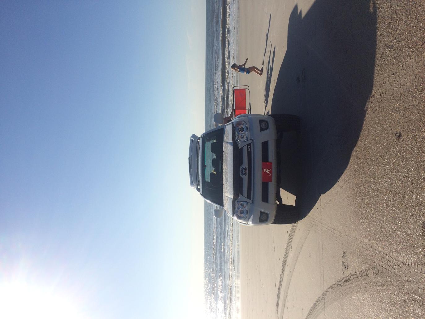

Took the 4Runner and family to Fernandino Beach

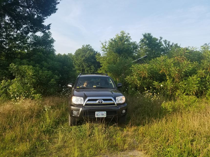

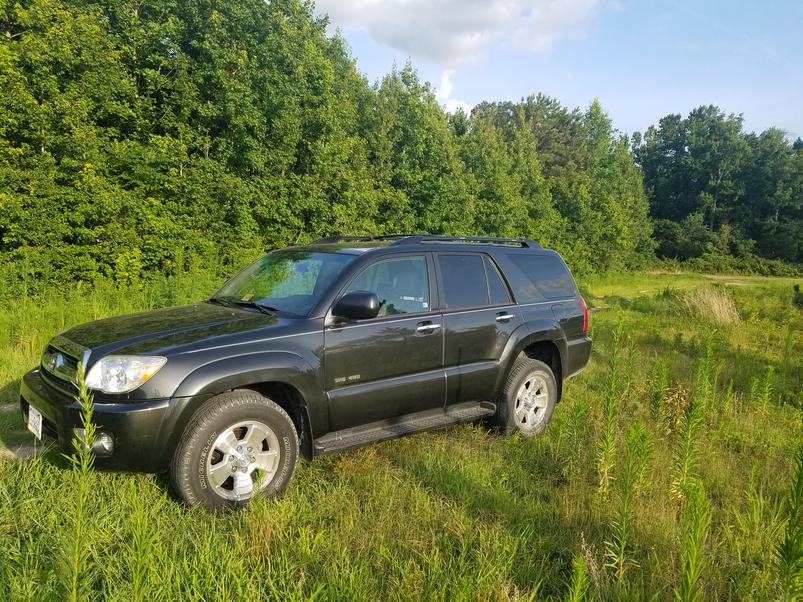

Quick ride down to Cavalier down in Chesapeake.

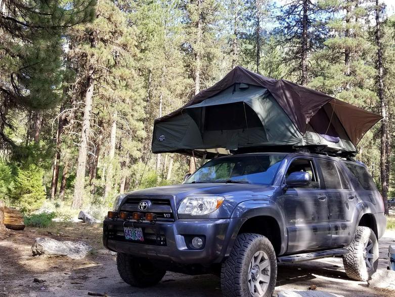

Drove 1200 miles yesterday and today. Stayed the night in Idaho at Black Rock campground. 20 miles off the main road. Fun area to play around. Woke up and drove to Grand Junction, CO. Tomorrow heading to Silverton, CO for 4 days of off roading and playing aground!
