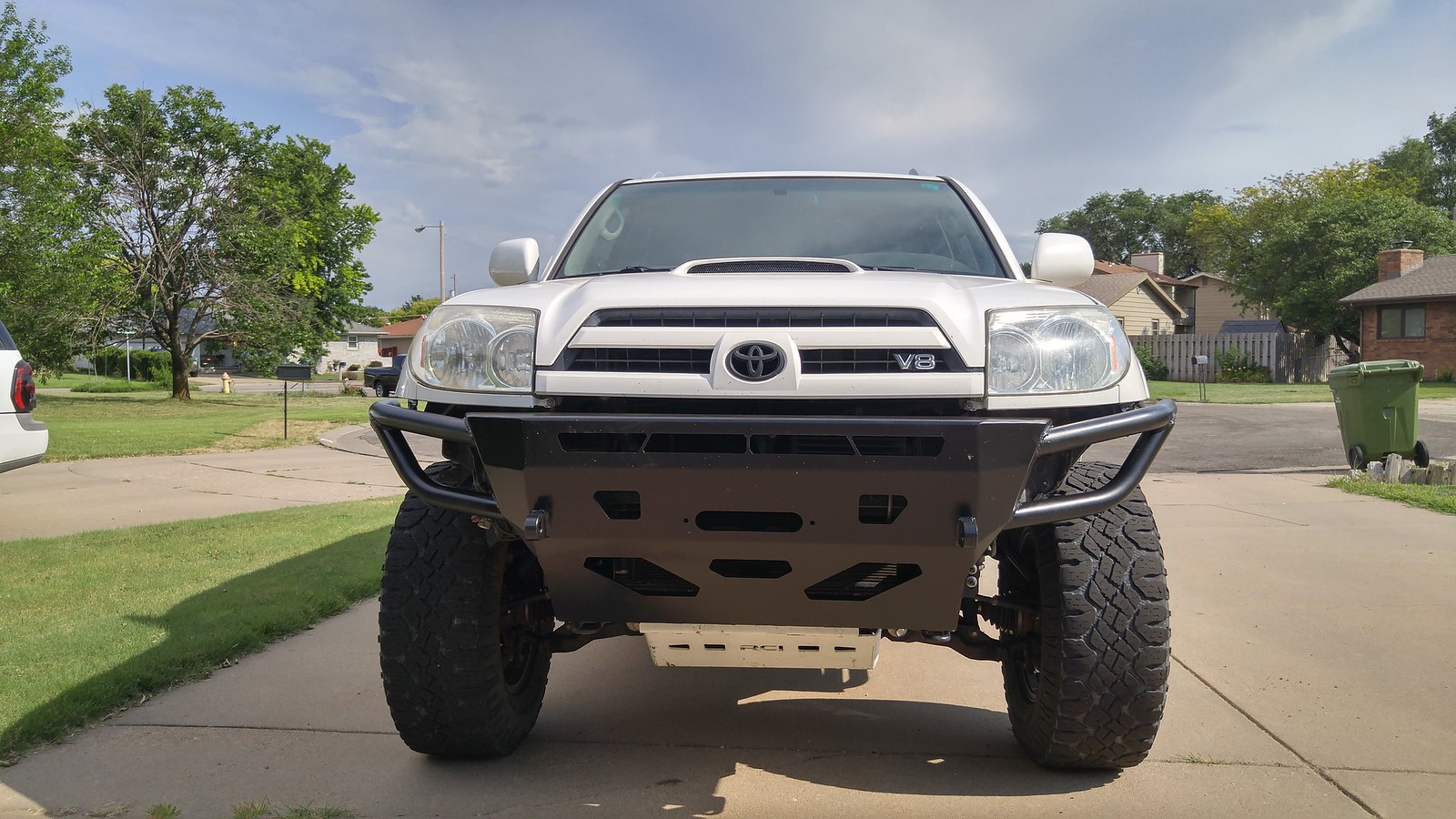

I did this yesterday so I hope it counts...
Welded my front bumper together. Check out the build thread for the longer story and more pics.

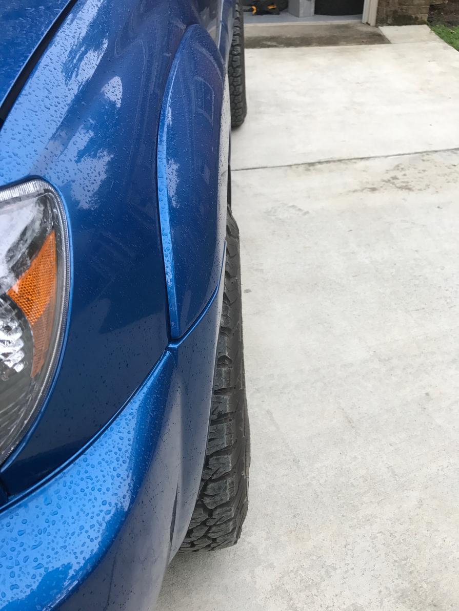

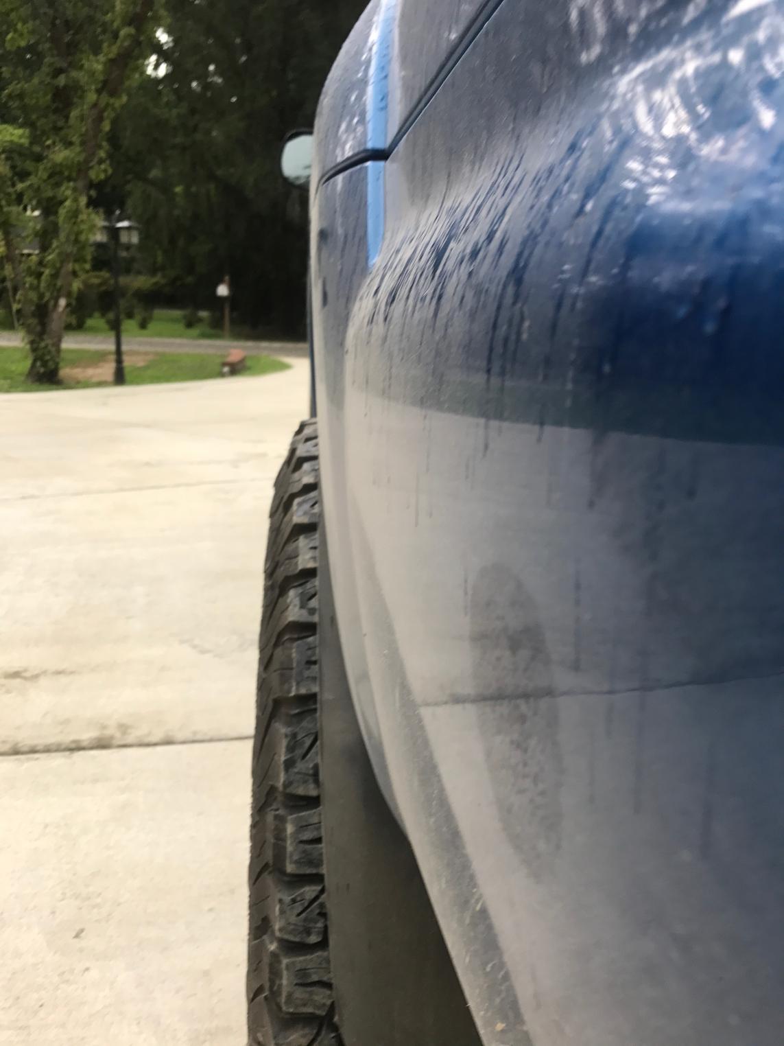

I also put on (at least on the rear) 1" wheel spacers I found online. The reason I went with these instead of ST is because I already have wheels that are -12mm offset. But they still were not enough for me. The were just flush. The 1" spacers make it look just right to me. Not enough to give it the "jeep" look, but it does look tougher. And believe, me, I have read every post I could on spacers here. But I do not do any offroading. Occasionally dirt roads at slow speeds.
Tomorrow I will put on the front spacers.

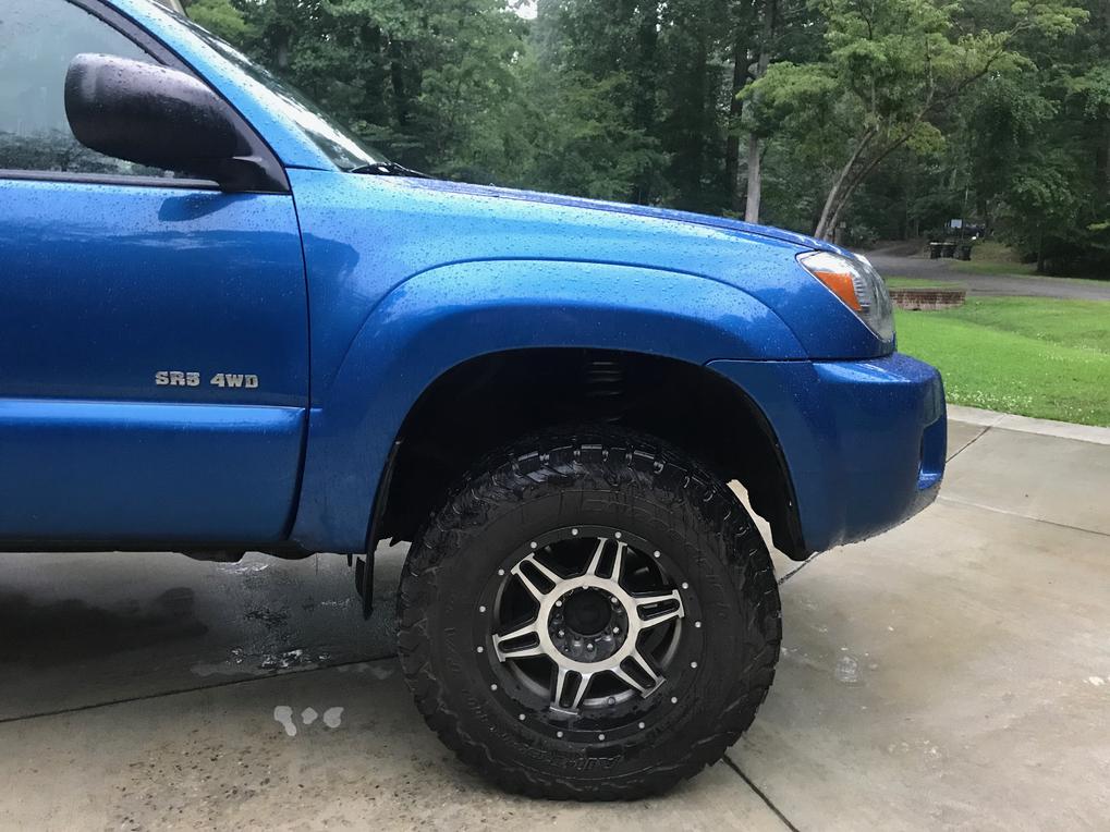

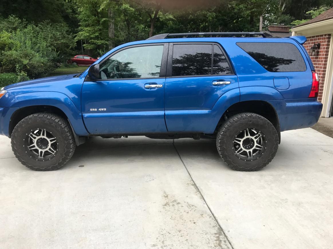

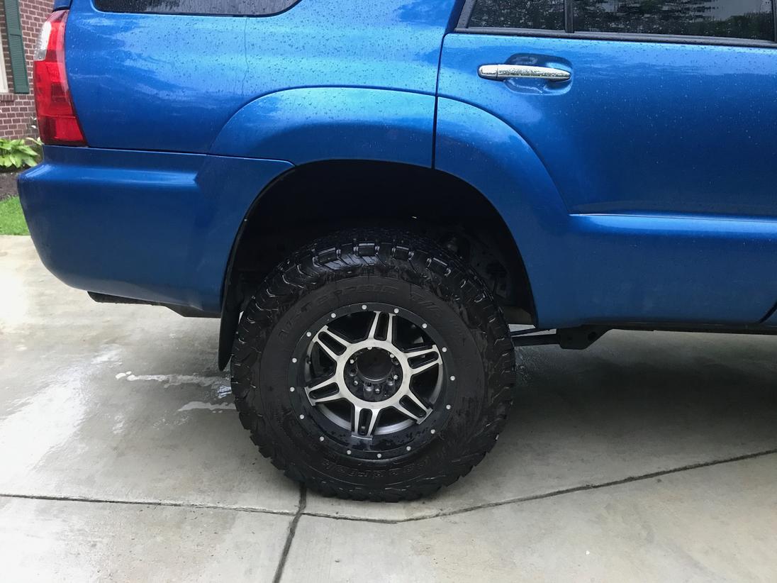

As stated in my post yesterday or the day before, I took out the DS spacer and old springs in the rear and put in new ones from Toytec with no spacers. I had also purchases a 1" rear spacer that allegedly fit my vehicle, thinking I wanted 3" of lift in the rear. Turns out the spacers did not fit, but the lift I got from springs along was plenty and I was not disappointed.
But it gave such a rake compared to the front (Billie shocks on 0 setting with new Toytec Springs) that I figured I would make it up by adding the TOP1 spacer that I forgot to install when I had the chance two weeks ago.
I figured it would go easier because I now knew what I was doing. But it was a little trickier than I thought. I was going to simply use the no spring compresser method and lower the LCA, leaving the shock mounted to the top plate. I planned to unbolt the three shock threaded bolts that stick up thru the shock tower, lower the shock/spring assembly enough to be able to slip the 1/2" spacer in place, then shove it back up there and attach the three nuts back and be done with it.
But when I tried it, it looked like the spacer would drop the three bolts farther down and limit how many threads I could get with the nuts. I wanted to be sure that the bolt threads at least came out the top of the nut, but it didn't look like it would. Somebody that it familiar with it can probably confirm if I was being to cautious, but I decided to go ahead and pull the assembly out, take the main nut off of the shock itself (boy, that spring will make that shock shoot across the floor if you aren't ready-haha!) and replace the three shock tower bolts with the extended ones from Toytec that came with the spacers.
While I had it apart, I decided to go a step further and move the Billie setting up one notch from 0 to .85.
I put everything back together. It was a little tighter going back together and I needed a longer bar to use for leverage on the LCA, but it is all done.
And I am SOOOO glad I increased the Billie setting and added the spacer. Now the 4R has the lifted look I have been wanting. The space between the top of the rear tires and the fender is about 8.5" (on BFG KO2 275/70-17). The space between the top of the front tire and the fender is 7.25". So I have a very slight rake, but it looks good.
To tell you the truth, the Daystar spacers just did not make it look like I originally hoped for when I began this project a year ago. But now, holy cow, it really looks like I'd hoped for. The 285's get mounted tomorrow.

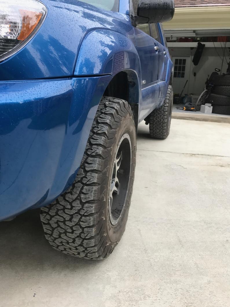

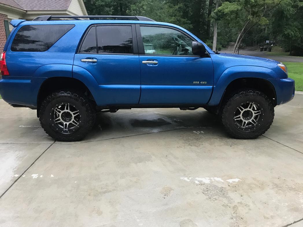

Here are pics from today after I got done with the front spacer and Billie adjustment. Sorry for the light, it is raining outside.
I'lll send some more pics Friday with the 285s after I get it washed. And as always, let me know if I can answer any questions!
