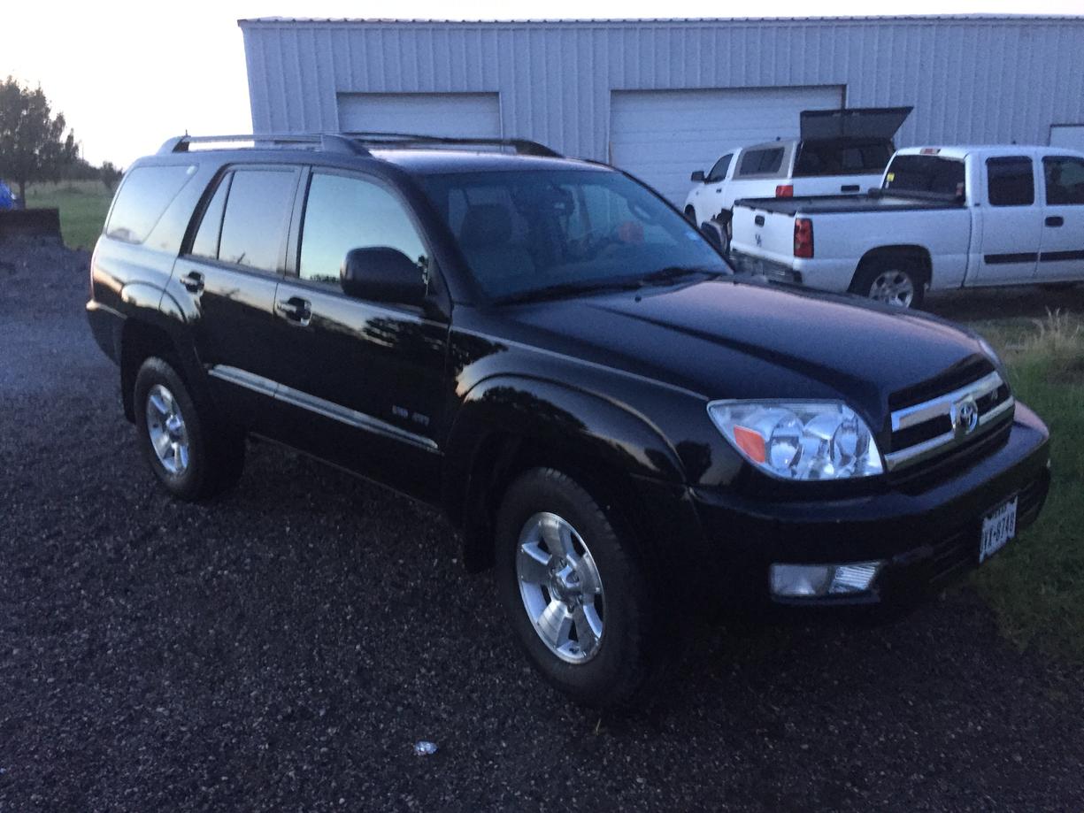

Hey guys my name is Noelle I am looking to buy a 2004 4runner with that 126,000 miles on it. It has had regular upkeep and quite a bit of work done to it timing belt changed 1 time and water pump changed twice, with only 1 owner. I live in Colorado, it is a 4x4 and I'm just looking to see if I'm getting a good price. They want $9900 for it. Please help thanks!

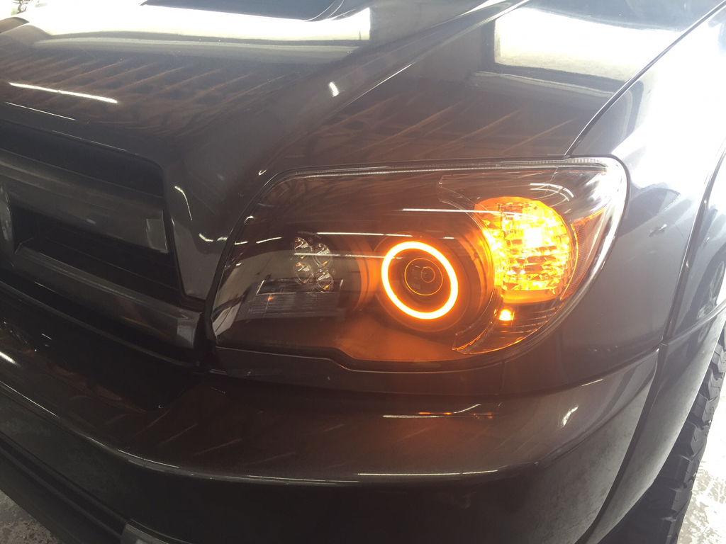

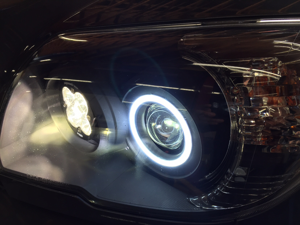

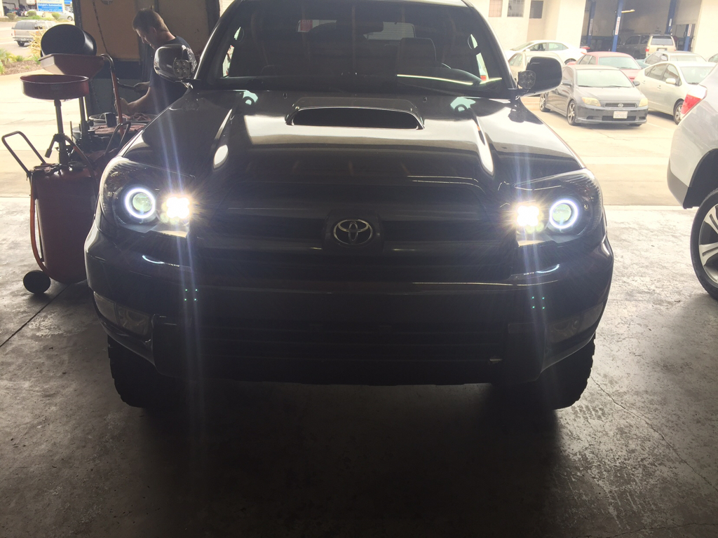

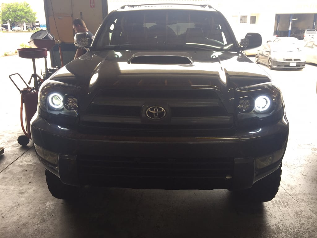

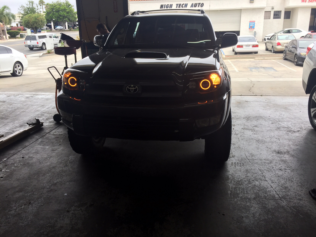

Finally did the 06 headlight conversion. I did step it up a notch. Haven't seen anyone do this and a friend of mine works at Baja Design. So I got a pretty good deal on some Squadron Pro spot lights to use as high beams. Started with Depo's. Got them apart and and started to cut the high beam bezel to fit the BD lights. Added Morimoto switchback halos. Re wired the turn signals. Did the auto headlight conversion. All plug n play parts from the dealer. Added a Drl relay. My T4R didn't originally have drl's. Painted all the chrome flat black. G8 led's for the low beams. Aligning the high beams was the hardest part. I couldn't get the video to load but when the headlights are on the halos are white. They turn orange and flash with the turn signal. Also flash orange when in the drl setting.

Definitely like the looks of everything you did they came out *****in looking, very well thought out with perfect looking end results. Job well done.
The only thing I dont care for and that just me is the color contrast of the light output of the (high beam) squadrons and your( low beam) led bulbs & halo ring..just one of those small details that Im particular about. It would bother me if they were mine. My .02
But its not that often you'll have them both on at the sametime anyways.
But they do look awesome brotha, nice work.

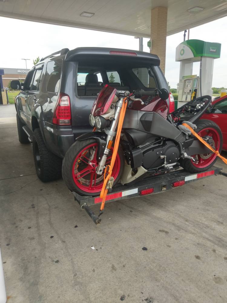

Made a 5.5 HR haul back with this new toy. Time to join yet another forum. 4runner handled it very well with 35psi in the airbags before loading the bike on. Bike + hauler weigh around 500 lbs together. I did pull the seat and battery from the bike to make it less top heavy (would have preferred empty fuel tank too) and ran a strap from up high on bike frame to 4runner hitch chain hook for a little triangulation to help with the front to back stability. Hauled great! Versahaul sport rack.

Cool headlights! I've thought of doing some LED's in my high beam but was concerned how the plastic housing would handle the extra weight/leverage of the LED lights mounted in the high beam bowls.
Are you mounted directly to the back of the housings or mounted onto the high beam reflector bowl? Any vibrations when going over bumps where the LED's bounce around?
Props for the creative idea.

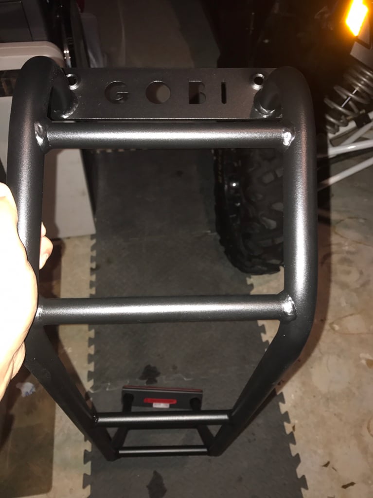

new parts for the wagon!

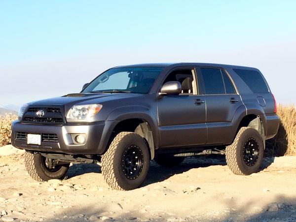

Swapped my tires onto my SCS wheels and installed my temporary grille.
Here's a crappy low-res image because :worthless
tracygray-albums-tracygray-picture47479-8-2017-jet-black-ray10s-mounted-temp-ebay-grille-2-0-installed.jpg

These look freaking amazing. I would fail inspection instantly here in VA (I got failed for HIDs in my fogs this year), but God would I love to have em.
