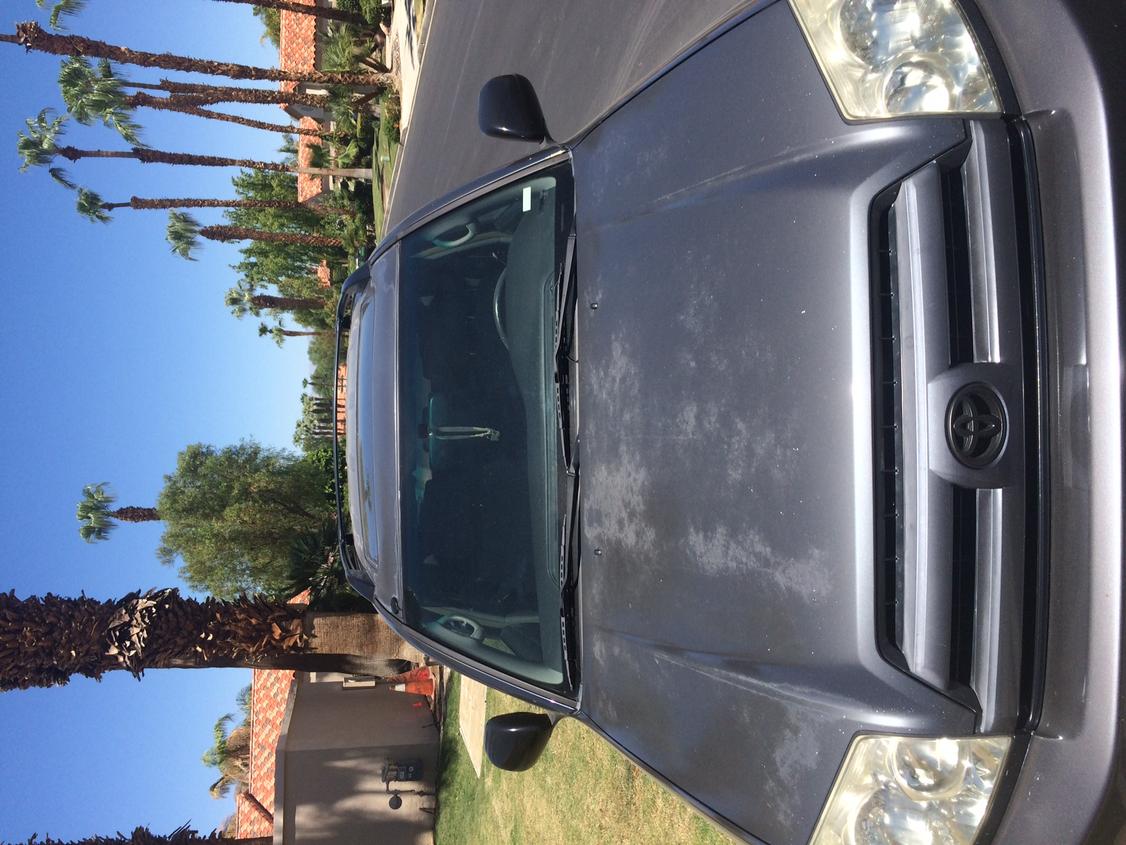

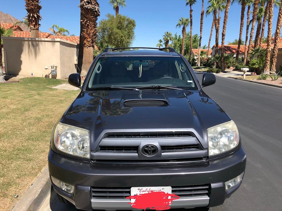

Replaced my roasted factory hood with a new sport hood! I'd been wanting to do this swap since I bought my 4Runner in April. I ordered a CAPA certified hood from JC Whitney and the various scoop parts from a Toyota dealership in Florida.
Had a local body shop that has done work for us before paint and install the hood for me. I was on a bit of a budget, so I didn't have them blend it with my fenders. They still did a fantastic job matching the colors up. Not to mention, I finally have my sport hood!

That is something Ive been wanting to do. How did the aftermarket hood fit? did it bolt up without any issues or does it not fit as well as the factory hood did?
It bolted up with absolutely zero issue! I had read a few horror stories about the cheaper hoods not being a good fit so I opted to spend the extra on a CAPA certified one. Turned out to be the right idea! My guy Vince at Caliber Collision told me that normally the cheap replacement hoods are a total crap shoot when it comes to getting a good one. Which is why most repair shops only deal with OEM or CAPA certified parts to begin with
