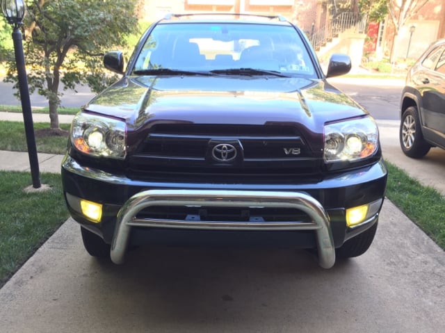

Got a lot done Saturday night...
- Installed 06+ projector headlights from Rockauto.com.
- Replaced the melted fog lamp harness so that the HID relay harness will work without issue. Bad connection caused it to flicker on and off.

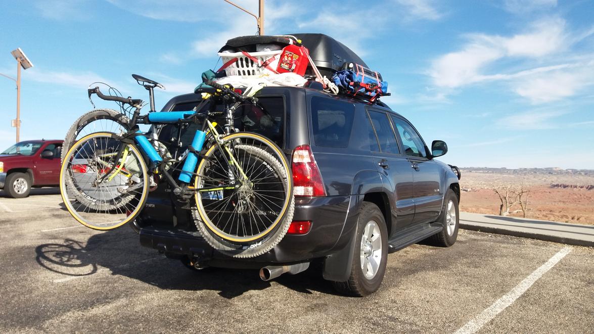

I added 2 ski racks, 3 bike racks, a laundry hamper, a cargo box and more... oh, wait just moving from Vegas to South Carolina. 750 miles yesterday through the mountains and stopped in Boulder to visit a friend. Almost 18mpg so far at 5-10 under the speed limit.
Truck still has rake loaded down this much. I love the factory cone shaped progressive bump stops. No hard hits on big bumps.

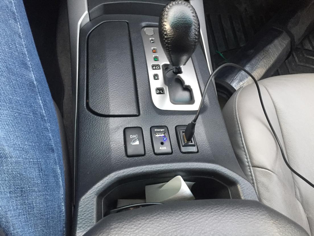

I did the HCF delete and installed a jumper wire for constant 12v to my outlets. The jumper wire was a complete pain in the ass because the aftermarket security system wires were in the way and they were tight! Managed to finally get to the relay and it works like a champ.

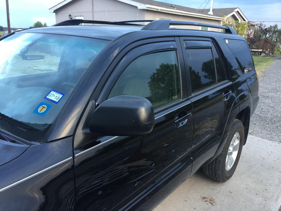

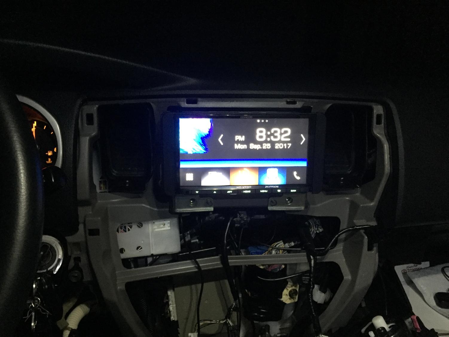

I finished my stereo install with a USB port that I bought for my car play connection and I installed some AVS in channel window visors.
