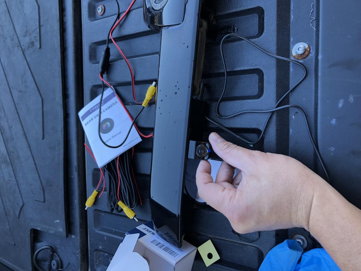

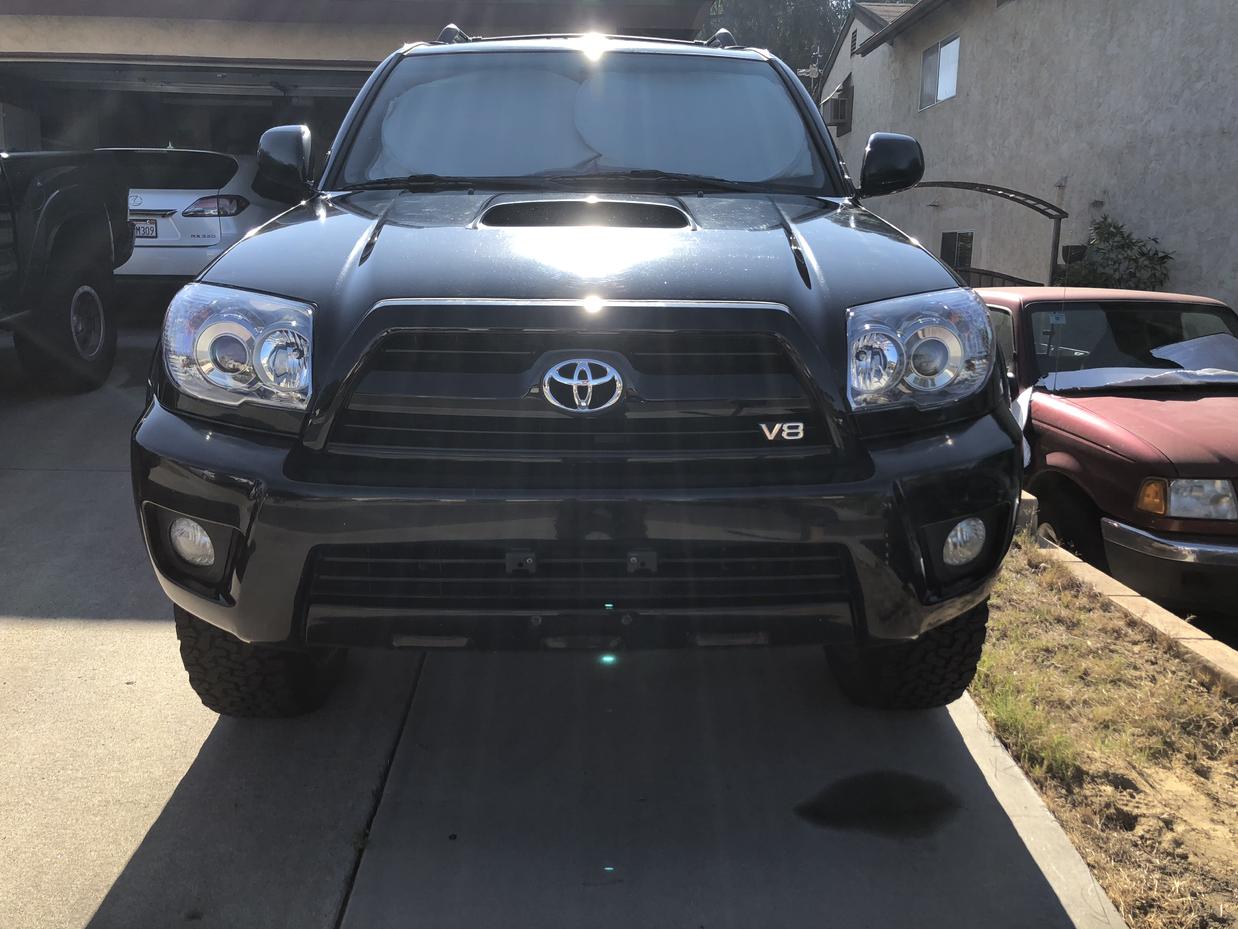

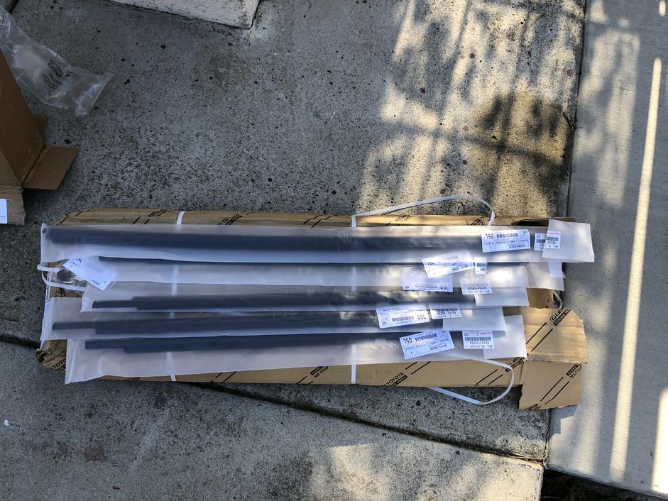

Ordered and installed the color matched limited grille, ordered new window moldings, in process of a back up camera install

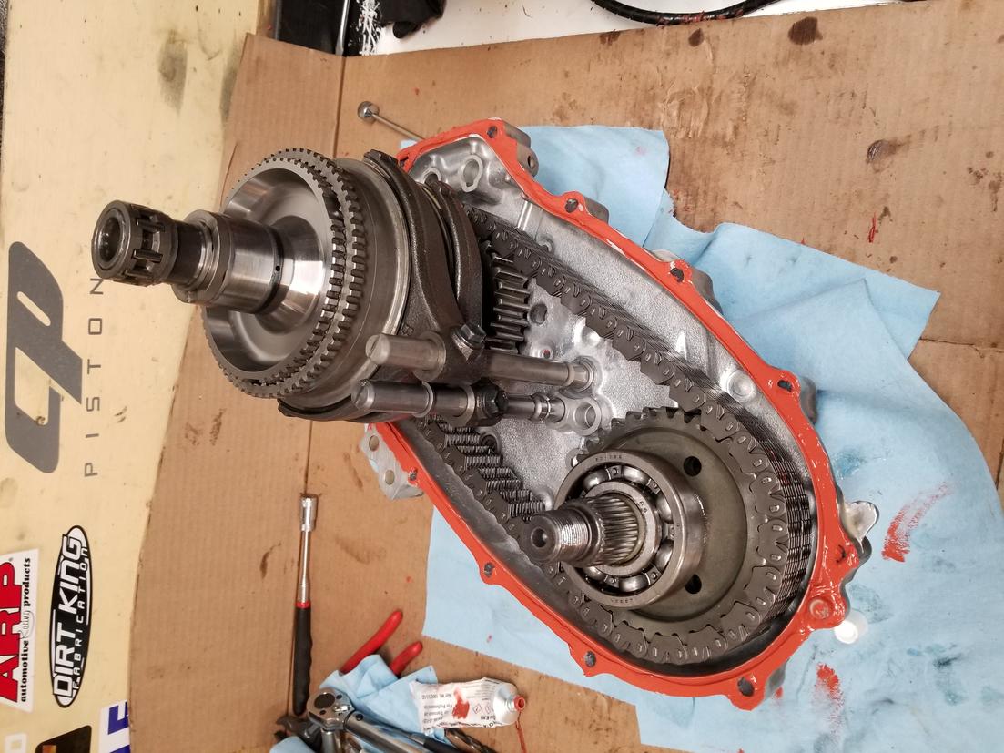

Replaced transfercase actuator. Used one from Aisin rather than Toyota this time. Works much better. Thinking the one I installed 2 years ago from Toyota was defective, it was always a little sticky and finicky. This one engages instantly everytime. Yahoo!

Impressive job! Was it difficult to replace the actuator, I know the dealer charges quite a lot for this.
Not hard, took may be 5 hours. I also replaced all the seals though. Dealer goes by book time. Book time tells them to pull the tranny. In reality you can drop just the transfercase, takes about an hour, then a hour to split the case and hour to reinstall.
This is assuming that you know what you are doing. Realistically, 10 hours for a person starting from scratch. Half a day for me to take the transfer case out, half the day to put it in.

This is true. Although I only started working on Toyotas in the last 3 years, I used to be a Subaru mechanic and have a lot of wrenching experience.
This job is not hard, I think anyone who can pay attention to detail and has a mechanical aptitude can tackle this, but it would take 1-2 days for them. I personally think timing belts are much more involved than this, so if you can do that....
