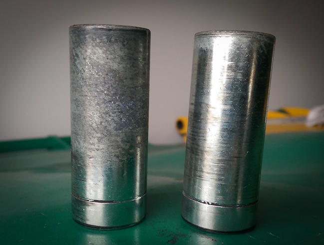

Regrease SPC UCAs
Installed the SPC 25480 UCAs around Labor Day of 2016 and greased IAW MFR specs. Fast forward to late this Fall and I start hearing a creaking/squeaking noise coming from the driver's side. With a little help from this forum, I highly suspected it was the UCAs making the noise. So...today...while we here in St Louis enjoyed a 65 degree day, I pulled them off, pushed the spacer out and found them void of any grease or, for that matter, any grease residue. Dry as a bone.
I had some Prothane super grease handy and packed it in there as much as possible. In just a few hours I had both sides done and all is quiet again! ;)
Here's a pic of the spacers after about 16 months of service. The heavily scored spacer is the one closest to the steering column. (call it the 'inboard' perhaps)

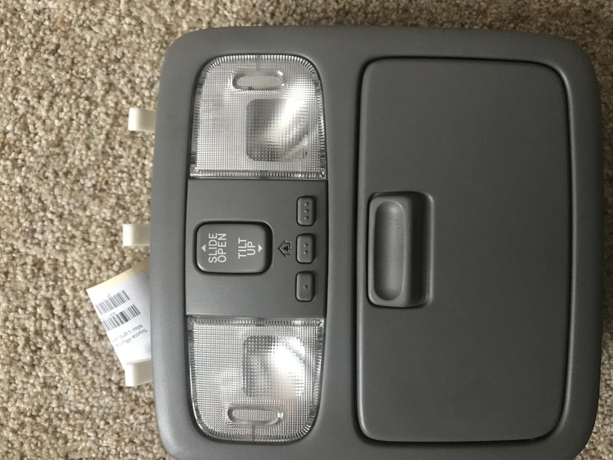

Put a Homelink console in!
I have been looking for a good deal on a Homelink mirror or console in. I found one after all these years finally! 39.99 shipped off of eBay.
I am so excited to throw that piece of crap garage door opener in a drawer!!!
Anybody want to buy my old one?
