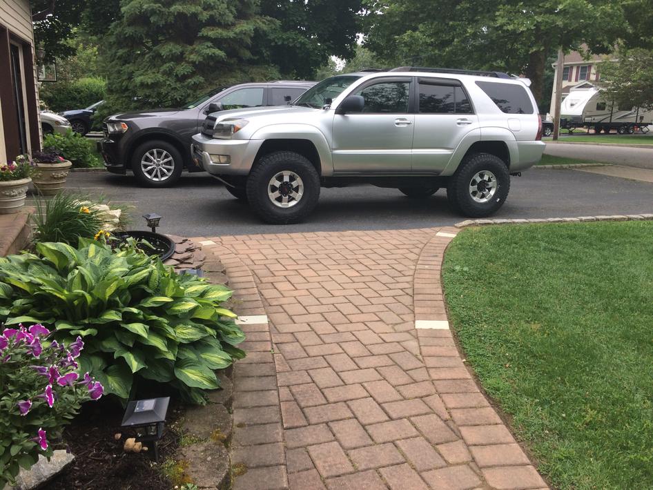

Wildpeaks in 265/70/17
What model ARB is that? It is absolutely not the one designed for a 4Runner. Not only is the bumper itself incorrect but it doesn’t look like it has the correct mounts.
Was thinking the same thing. Almost looks like a 5th gen one?

This bumper is an '06+ model and my runner is an '03, which is why you see a bit of a difference. Seeing the installation instructions for the '03 bumper versus two brackets for this '06 version is like night and day (I'm sure I'm missing a couple small things as well). I will post fitment pics in my thread so people can use it as reference in the future.
Sorry brother that is absolutely not an 06+ bumper. My ARB for my 07 looks nothing like that and mounts nothing like that.
You were sold the wrong bumper. See below for the correct pics without ridiculous gaps or improper mounting brackets. Google ARB 4Runner to see an 03 with the proper bumper.

Here's the sticker on it:
My mounting isn't finalized since I'll have to take off the bumper soon to fix the winch--that's why you see the huge gap. ARB specs about an inch of gap between the bumper and front fender, and I guess that's because if there's an impact, there'd be less damage to the fender. Do you have pictures of how your bumper is mounted (brackets and all that)?
Possibly just a typo but “Corporation” is misspelled on the sticker.
I think what he's referring to is the sides of the bumper and how it doesn't flow at all with the angles/contour of the fender flare. Even if there was no gap, it just doesn't add up. It looks almost like one designed for the 2014 4runners. Here's how it should look
https://www.justdifferentials.com/ARB-3421500-p/arb3421500.htm
Yeah that makes sense. I can see the side fender contour is different. Weird how the sticker says something different. I can live with it--as long as I have clearance for the hood and headlights I'm okay.
You have a 3421520 on there, you need a 3421510. you have a 2010 4runner bumper.
ARB is SO nice to use one sticker for all the 4runner models.
