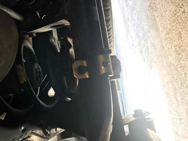

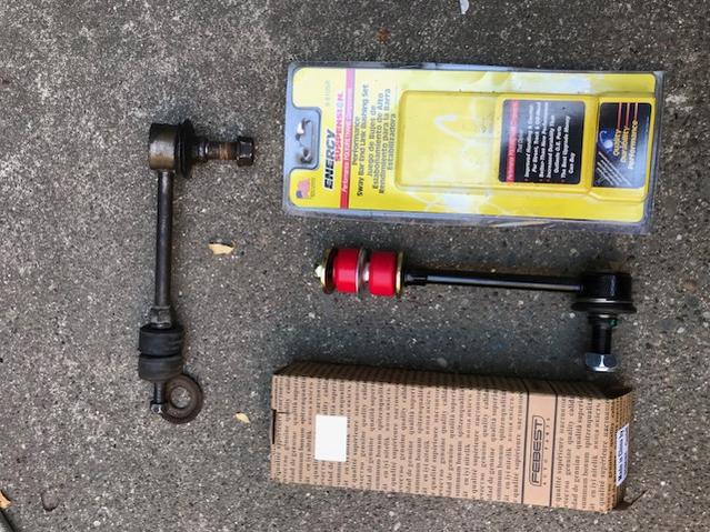

rear sway bar bushings
Finally finished the job. Sway bar bushings (greasable Prothane) went in a few weeks ago. End links with Energy Suspension bushings went in today. If you do these, I have the following suggestions:
1. Don't do just the bushings. Be prepared with new end links as they may need to be cut out and the seals may be shot anyway.
2. Lift the car and pull the wheels. I did it without, but there's not a lot of room to work. Might have been quicker overall to pull the wheels and put them back.
