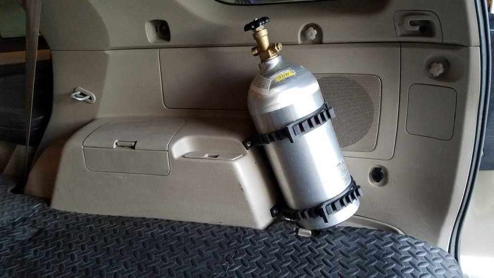

Mounted my CO2 tank today using two large Quickfist. Used #10 self drilling screws and it feels very sturdy. The Quickfist were $6 each on Amazon with free shipping as an "add on".

That will be a projectile in an accident.

Good point - quickfist is very secure and I was thinking of just mounting the tank and using for off-roading. I will be removing the inner panel and securing better so the quickfist doesn't strip out the screws. Looks like there is some sheet metal behind the panel to use for securing. For now, just using a ratchet strap wrapped around valve hooked to the rear tie down as a backup.

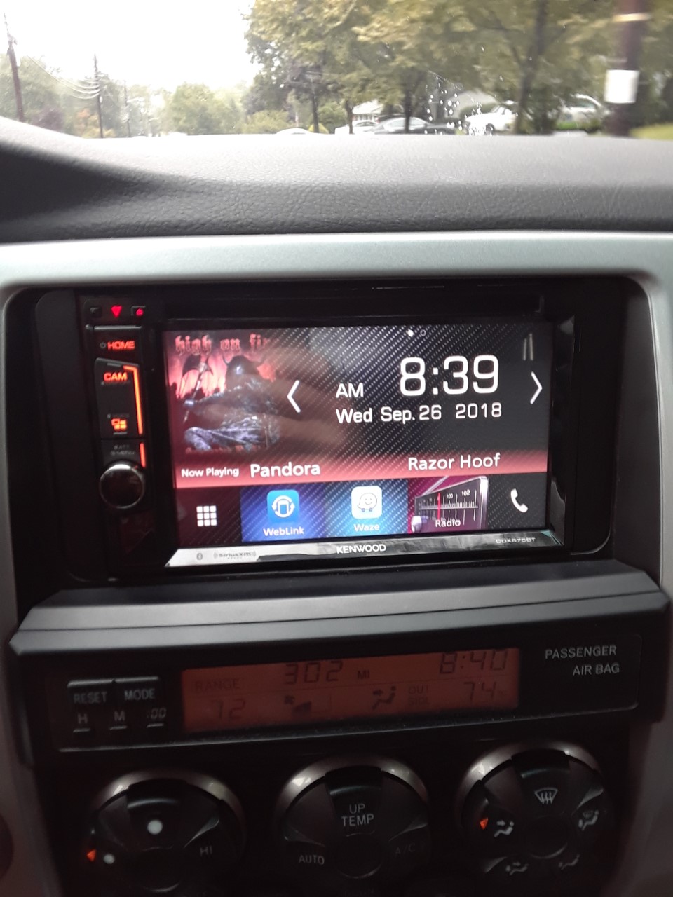

Well, it was Sunday to be exact. New Kenwood DDX575BT head unit. Pretty cool upgrade. Got all the equipment from Crutchfield. HU, DataLink box, and wiring.
Regarding the radio install. Last item outstanding is how can I extend the USB cable to the spare ports next to the DAC in front of the center console? I attempted to use a general USB I had laying around the house, and no luck. Any suggestions on what you Kenwood owners did to get the USB extended to the center console? Thanks! Danny

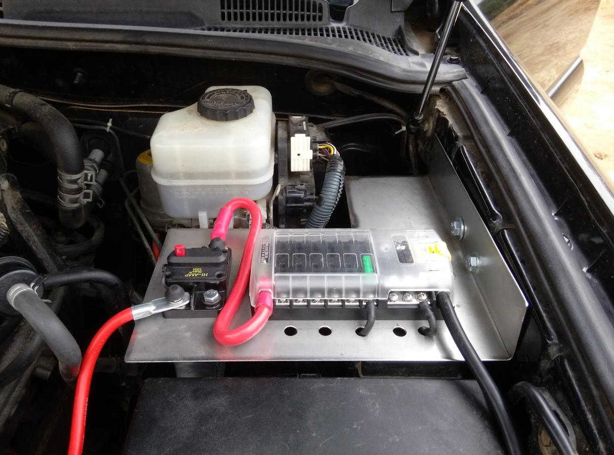

Finally had time this weekend to install a BlueSea fuse block. Had someone at work help me make a tray out of aluminum. Now just need to hook up everything.
I'd be slightly concerned about running wires through those holes without some kind of grommet to keep the edge from wearing through the insulation due to vibration in the long-term. Wouldnt really need to worry if it was all just ground that went through the holes i suppose.
