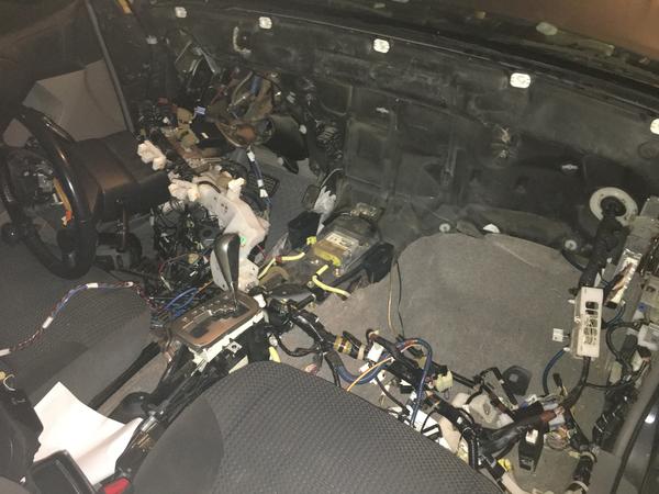

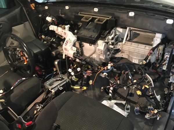

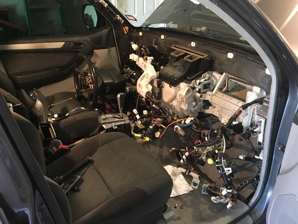

Evap went out. with help from a friend, replaced evap, compressor, condenser, dryer, and expansion valve. back to blowing cold just in time to not need it for fall. lol. took about 8-10 hours. not bad with extra set of hands and eyes working on the dash. it was a beast. saved big money though and learned a lot. worth it. pics to come later. :police:
Pics of the 10 hour ordeal. That includes evap, compressor, condenser, dryer, and expansion valve. for the amount of money it saved me, I would do it again. defiantly have a friend to help.

Wow, what a ton of work! Maybe a silly question, but did you have to tow it to a shop to refill/charge the system? I’m pretty sure the new compressor would be damaged if you start the vehicle without adding the charge and oil.
This was in my garage at my house. I used the cheap 8 dollar cans of r134 from autozone. yes, I got in the zone!
I have the gauge set and it was pretty easy. we filled the compressor with the correct oil before we installed. we would have been done on day one, but when we got to hookup the lines to the compressor, the bolts were a little short. old compressor had bolts tapped into it, so it was a nut to remove old compressor. new comp, I had to go to lowes the next day to get two new bolts that were just a bit longer. not a big deal at all, just frustrated that we were down to the last two bolts, and couldn't get finished same day. lol.
You have to have the system evacuated. They put a pump on it and basically suck all the moisture and contaminants out of it.
If you don't do this you will blow the new compressor. May not happen today or tomorrow. But it will happen. Spend the $150 and finish the job correctly.

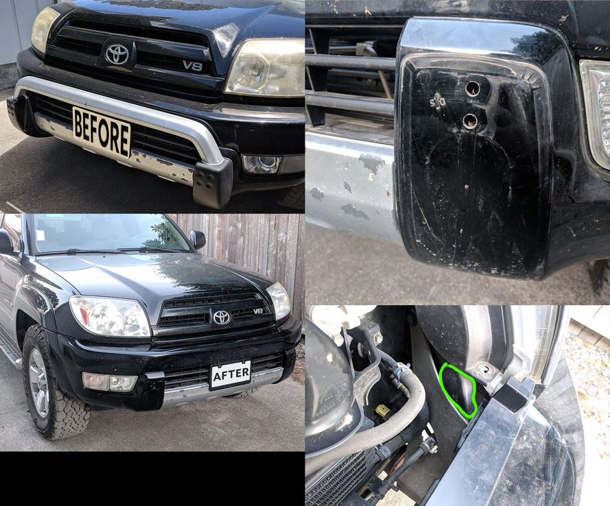

FINALLY got rid of the underbite bull bar. I wanted to do it without removing the bumper, but just could not figure out how to get in there. Finally last night I tried going in from right above the bumper with the hood open.
I felt two bolts right where the bull bar connected on both sides. It was JUST possible to get a ratchet wrench in there with a deep socket.
Absolutely hated every second of doing it. About 40 minutes of ratcheting them out. If I was lucky, I got two clicks out of movement each time. Probably 20 degrees, so each thread took ~18 times moving the wrench to get past. Along with it being at a terrible angle, falling off the nut occasionally.
Other than that, it wasn't too bad. And it just popped right off after. Although now there are two pieces in there that are kinda loose, but without the bolts from the bull bar, I don't see what they could attach to. A part of it is highlighted green in the picture. It extends forwards and down and has a bracket that sits against the back of the front of the bumper, and the screws and nuts of the bull bar were holding it in place. Not sure if re-securing it matters or what. It's still attached back further it, it just moves slightly side to side now near the front.
