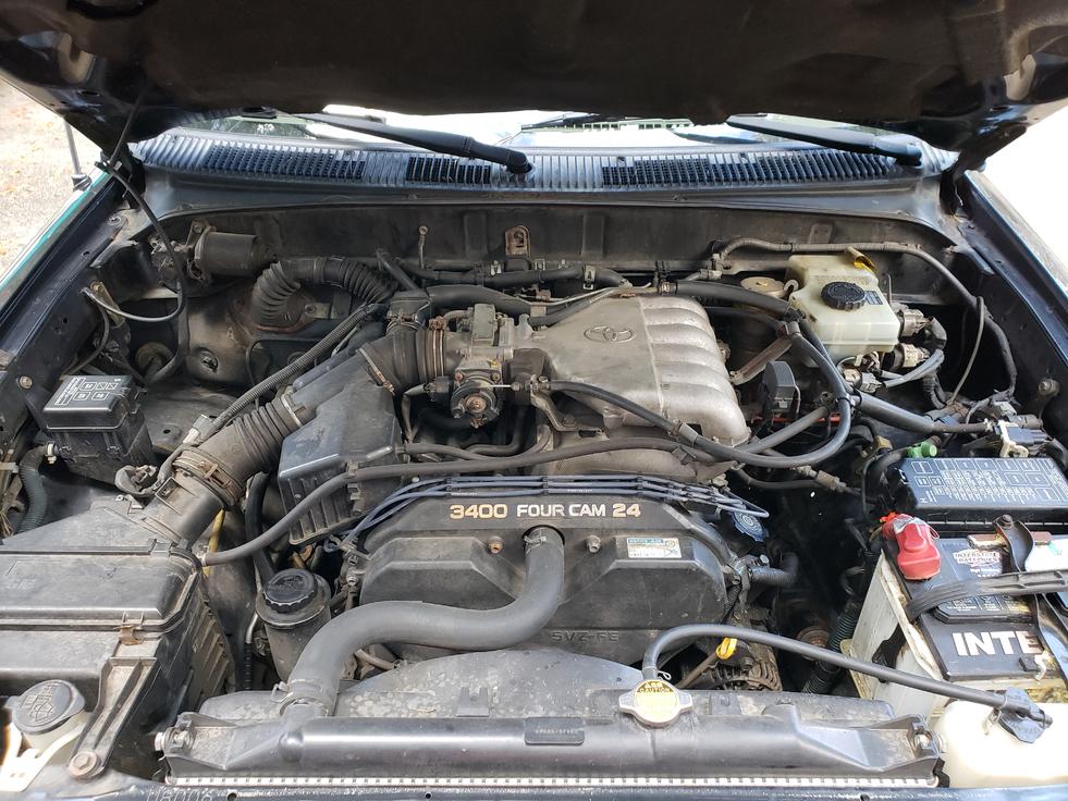

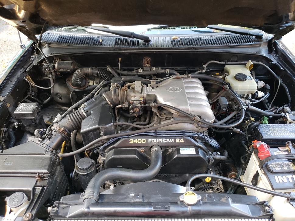

Cleaned the engine bay today (was much needed ). See the before and after.

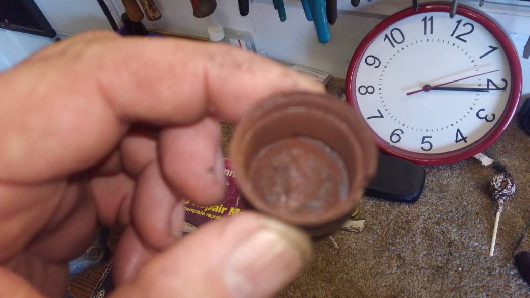

Fixed my clunk
Found the problem
Also threw in some new cv's
New ujoints on front shaft

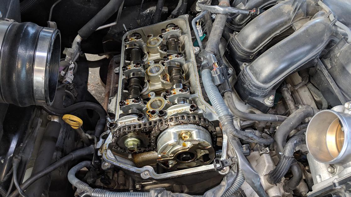

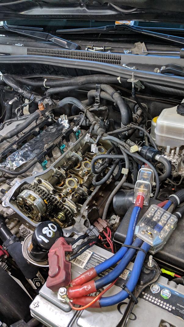

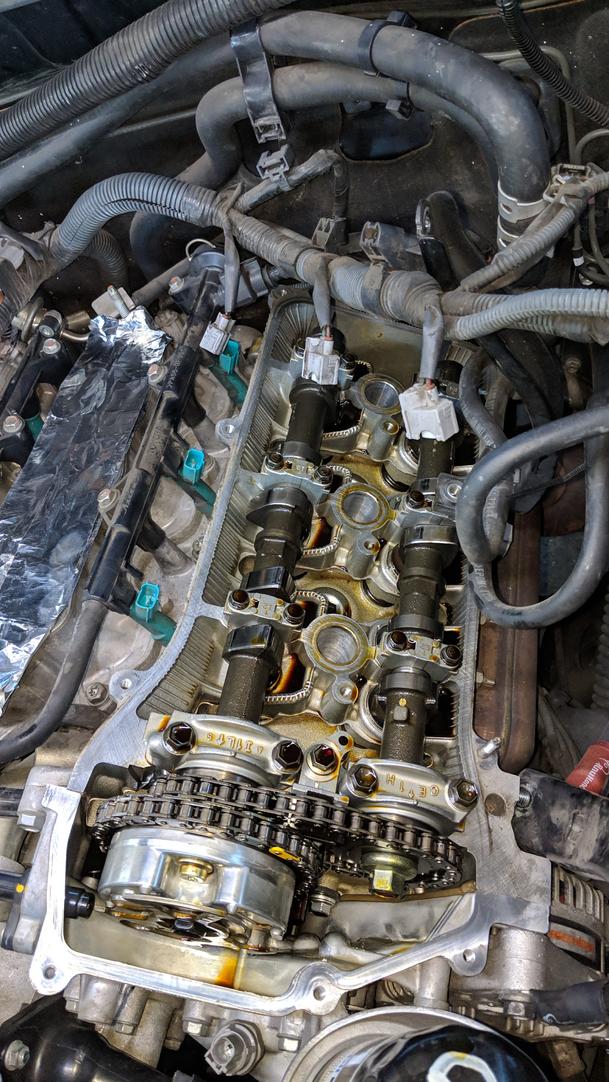

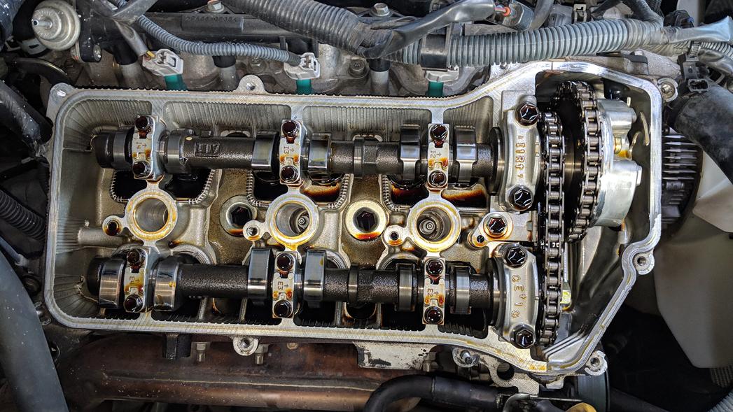

well it was yesterday, if you guys follow the facebook post, did my valve cover gasket and also spark plugs and a new belt tensioner. cleaned up the throttle body and maf sensor. looks like my filter might need a cleaning also, to do the belt tensioner, make sure to unbolt the ac line bracket on the left of engine, this way, itll give you more room to move the compressor out the way, also needed to remove the front skid plate to do the compressor.
everyone says i have some very clean no sludge. all mobil 1 extended oil with the m1-209 filter (bigger), this is at 10k intervals.

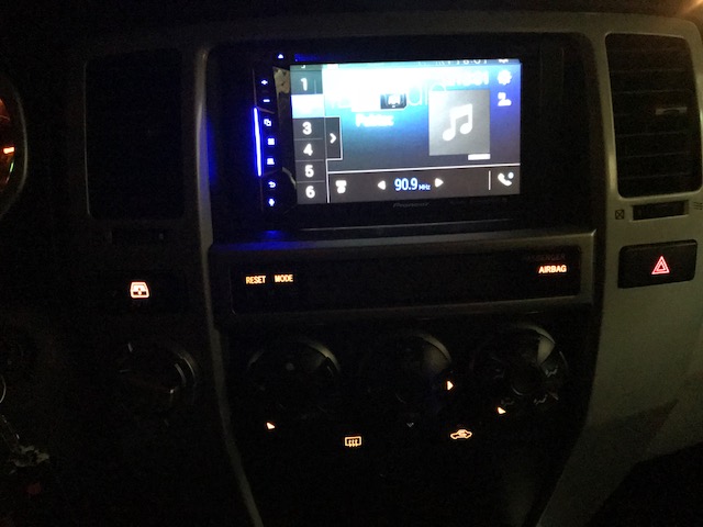

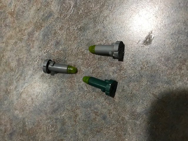

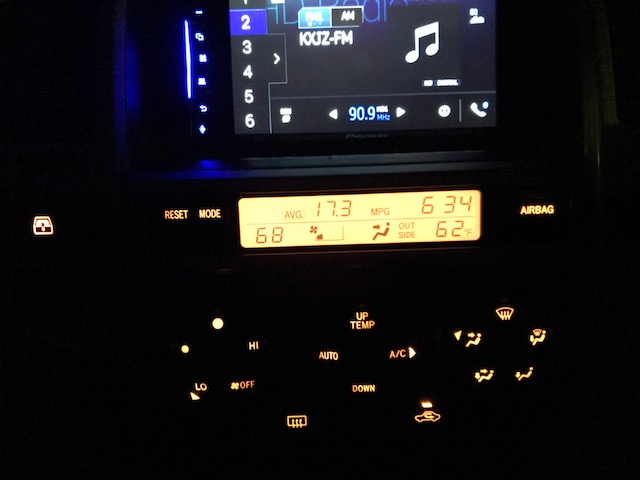

Let there be light
Did this. Makes it a lot easier to operate at night
