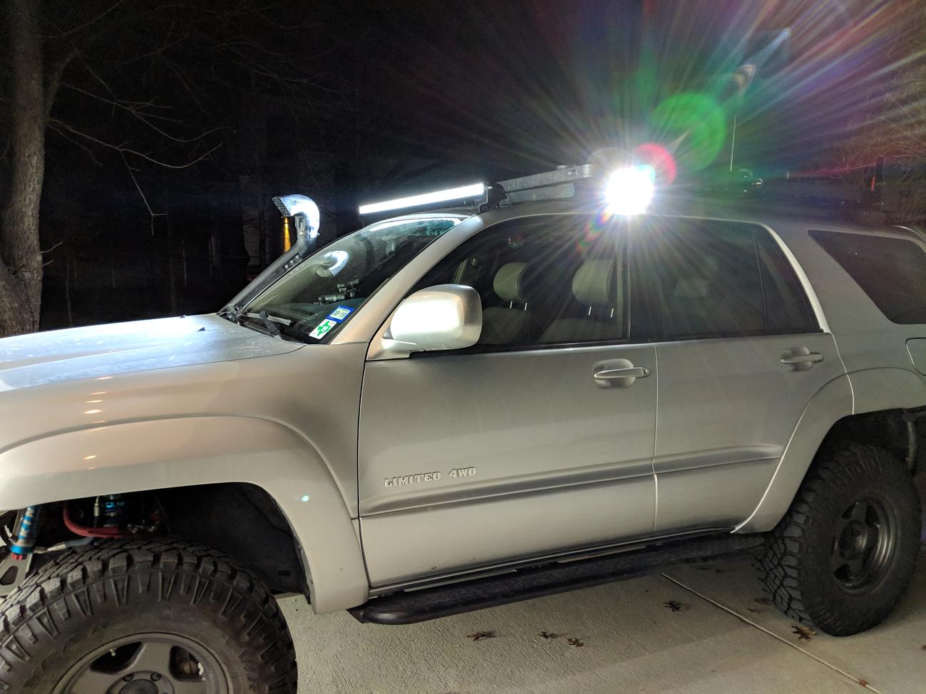

Not today, but over the last couple weeks. Numerous things added:

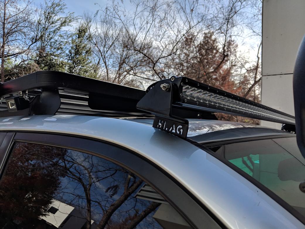

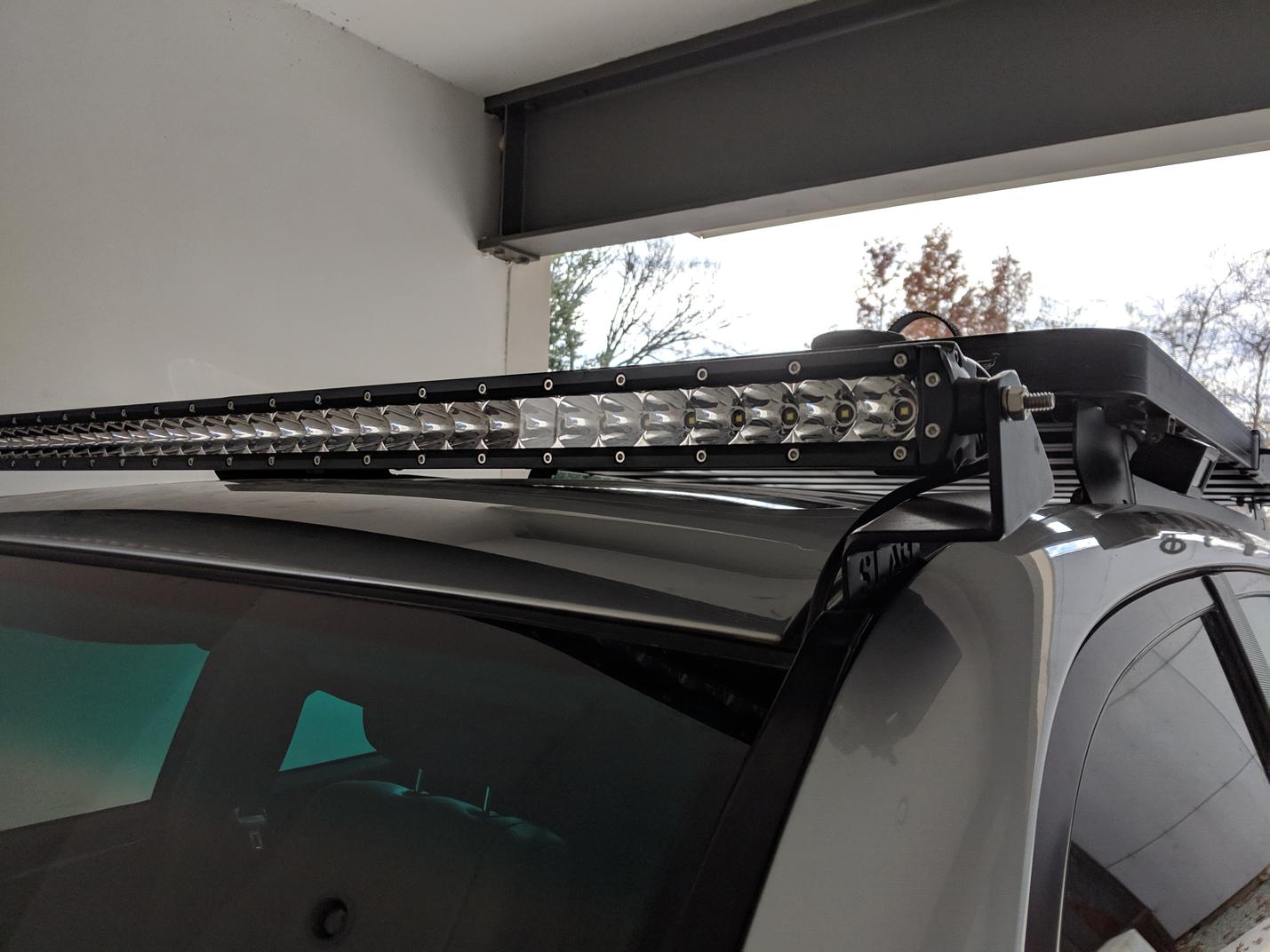

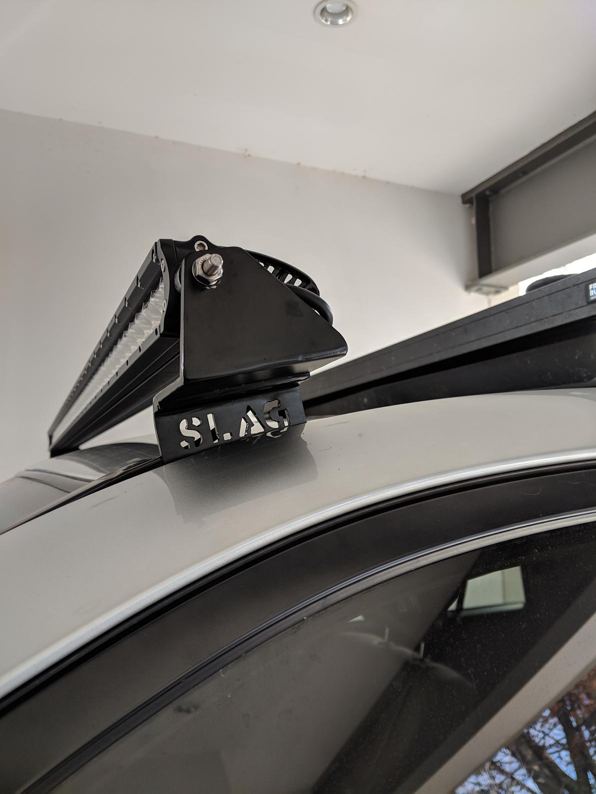

Found out that the Slag roof light bracket does not fit Black Oak 50" light bars. not even close. So a neighbor and I used the bottom part of the bracket and fabbed something up that would accommodate it. Don't point out the welds! It was the middle of the night and this is not a show truck lol.

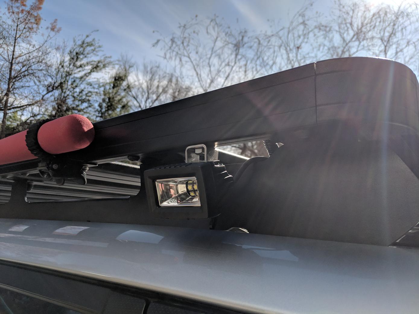

Added side lights to the FrontRunner rack. They want a huge amount of money for their pod light brackets. Not sure why as you can just bolt a light on one of the bottom holes in the side tracks.
Routed that light and the 50" light bar down the track of the windshield with no problems.

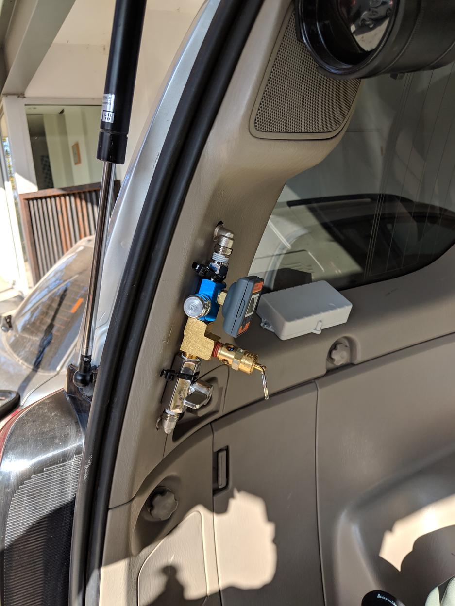

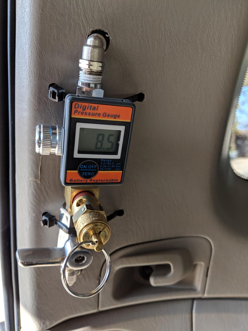

Also added the Firestone airbags because I tow and even with the Icon springs its drooping a bit. I already had onboard air so I routed the air up to a pressure regulator, blow off valve and ball valve so I can fill and empty the bags without dragging an air line out. Just turn the regulator on and flip the ball valve (carefully, as I can fill them up to 30psi in about one second lol).

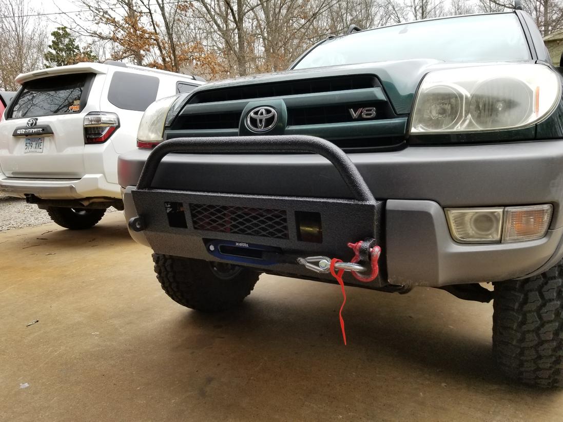

Finished pic of bumper with winch installed. I've built full bumpers on a bunch of my trucks but this is an effort to save weight on daily driver.

Looks great! Did you end up powdercoating it, or is that a bedliner type material?
Thanks. Its bed liner I got on ebay. It's called raptor liner. Real easy to spray and it's strong. Same stuff I put on rack and sliders. Probably going to do a swing out tire carrier through plastic bumper and be done with it.

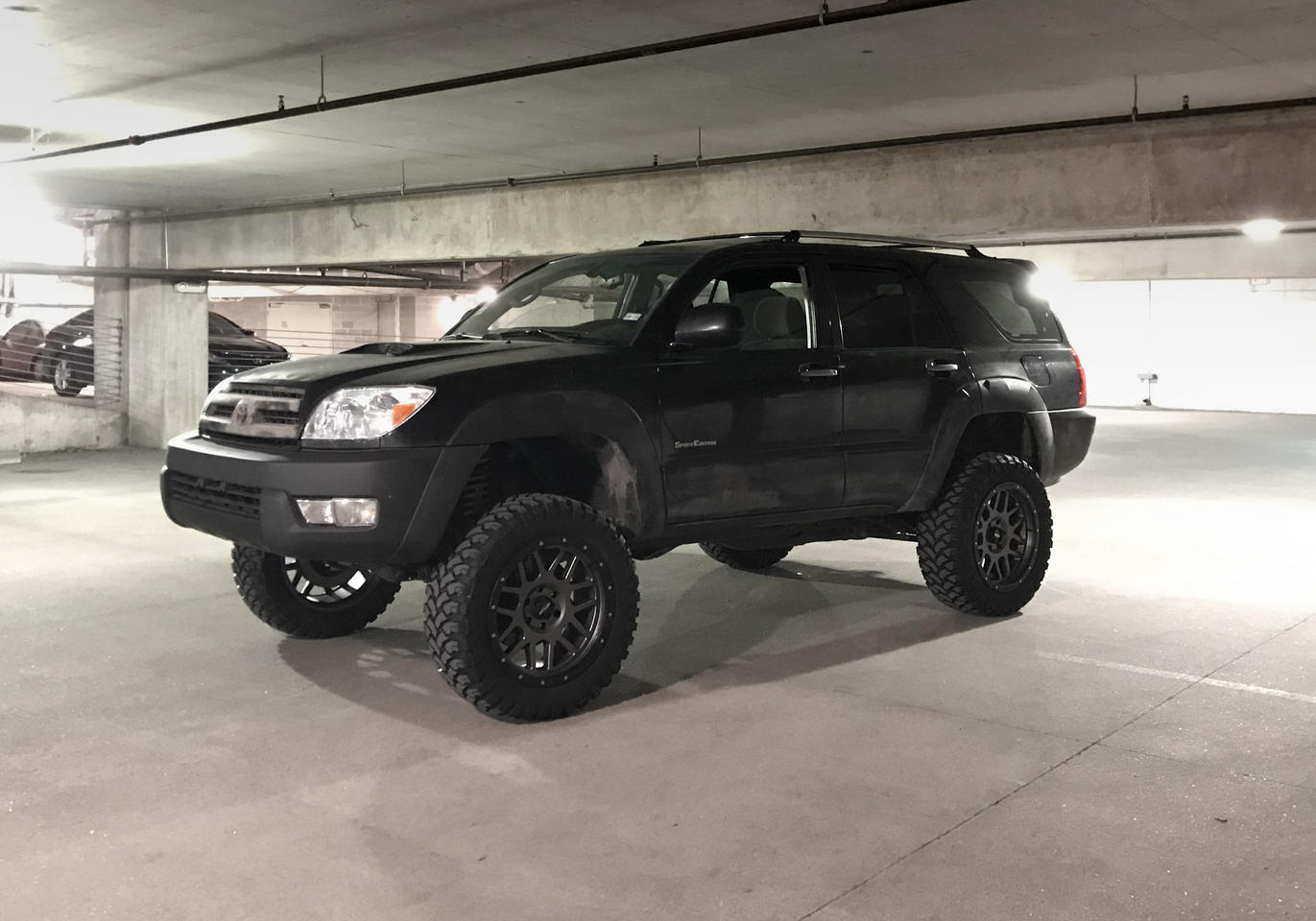

Got a chance to run down to the tire shop and get my wheels/tires on the truck. 6" lift, 20x9 33x12.50x20. No rubbing! Now to do some exterior refreshing
Good to know, thanks for the info. I had heard of that product a long time ago, but forgot about it. I have used spray bedliner before such as the Duplicolor one that I’ve sprayed wheelwells and such with and had good results. That one looks like it has a more aggressive pattern to it, which probably adds to the toughness. Was it a spray can, or did you spray with a gun?
