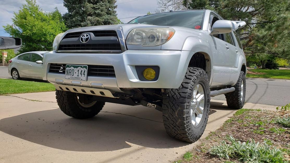

Broke the RCI skid plates in. No rub in these videos, though...

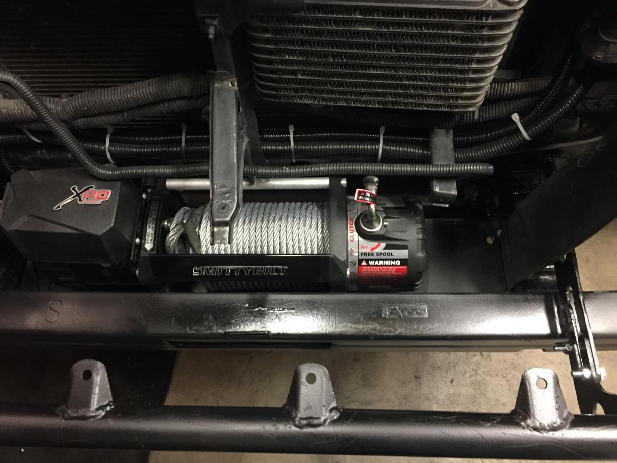

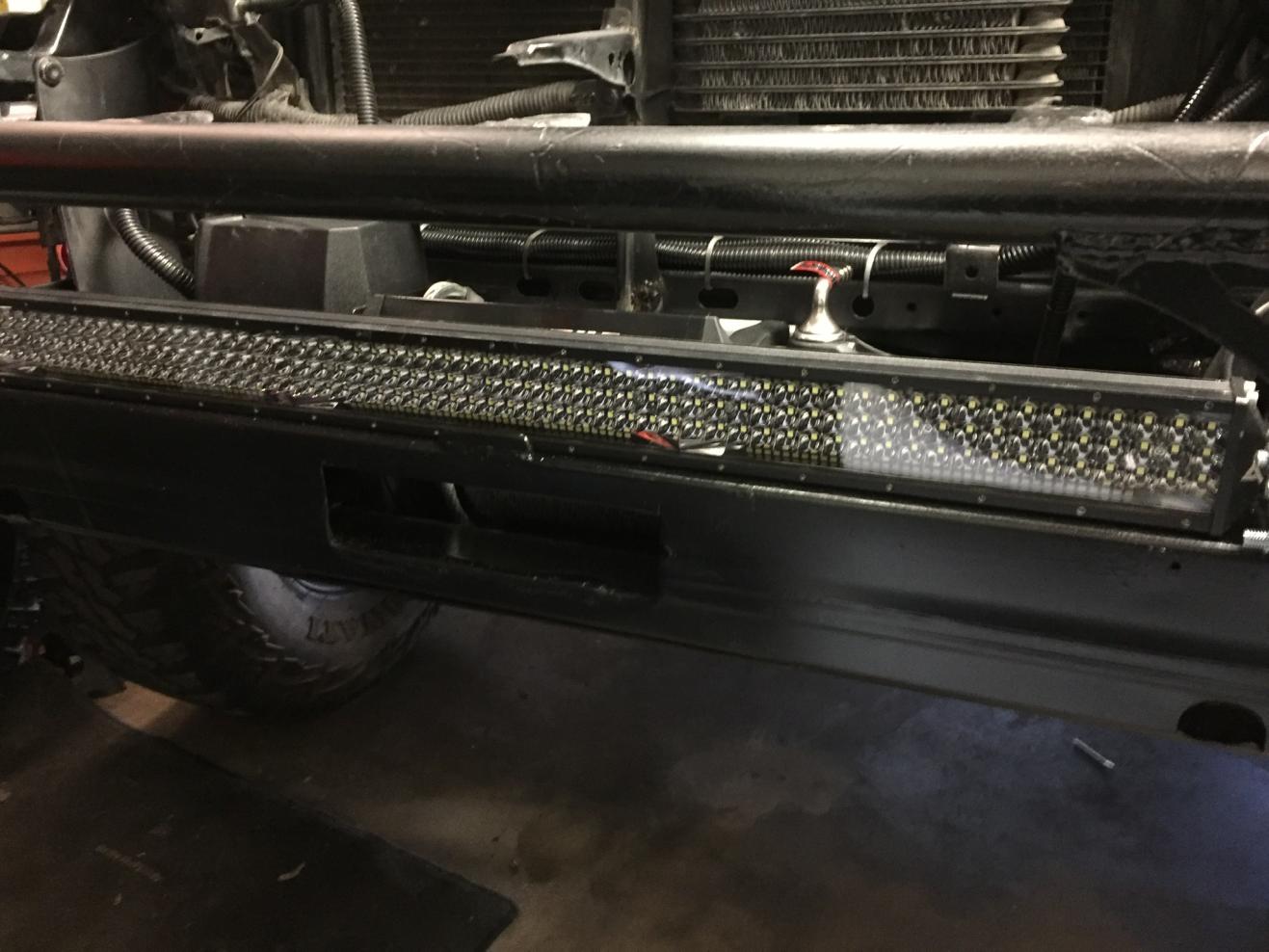

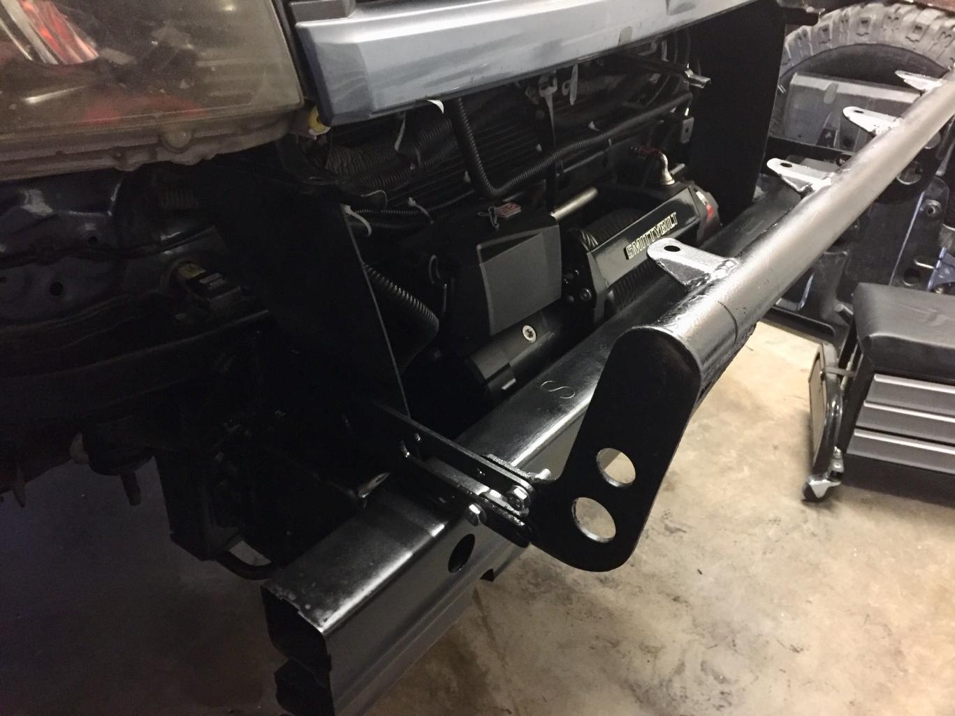

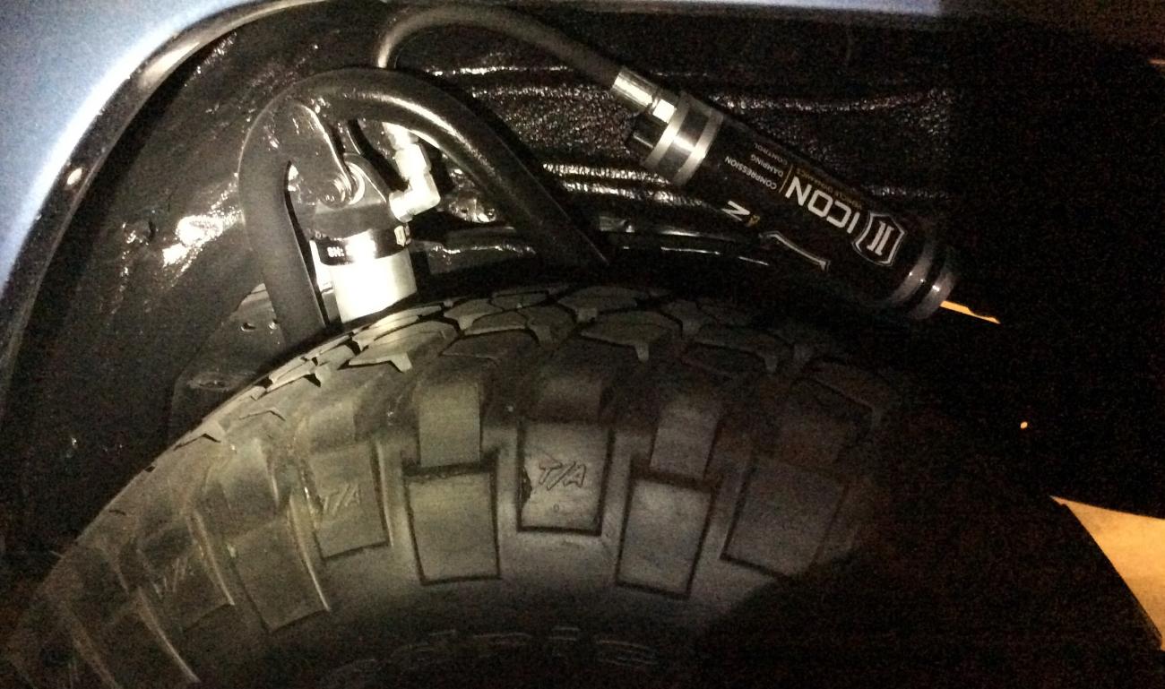

Hidden winch mount and Shock Hoops
Installed some new 2.5 icon shocks w/adjusters but not before having to Fab up some rear shock hoops using some .120 dom tubing I had laying around.
Recently fab up a hidden winch mount using some steel plate and utilizing the stock bumper to keep the stock look and still able to keep the light bar exactly where it was.

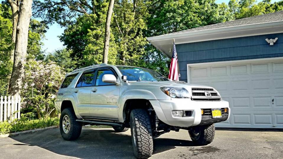

Bumped up the Bilstein 5100's to the 1.75" lift (3rd notch) and got her sitting almost level! No lift in the rear, stock springs all around. Also pulled off the running boards. Really liking the change it made!
Also got new lower control arms and front wheel bearings installed. Shes a happy girl!

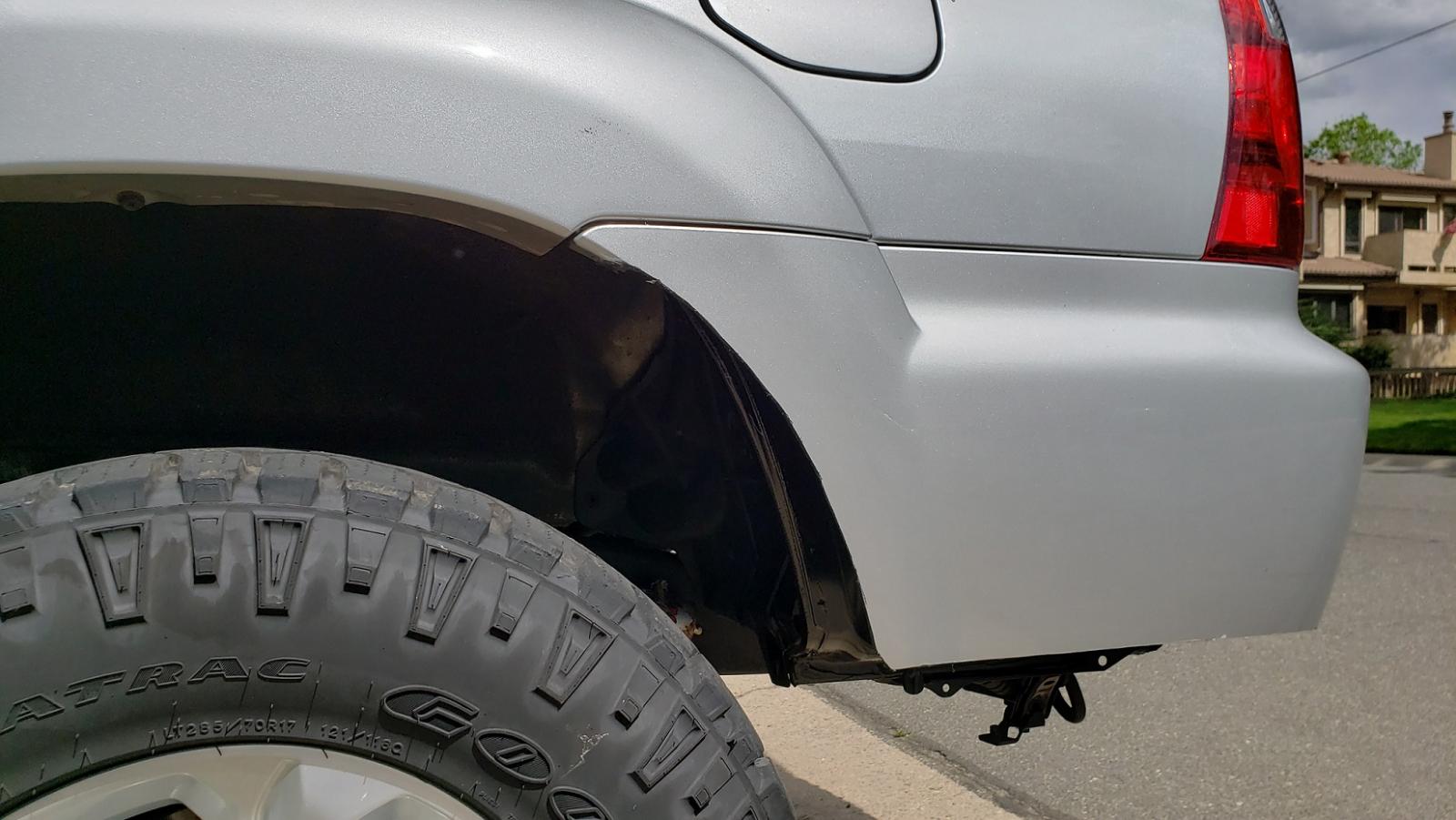

Can’t believe I did it all in one day but I got all my armor installed + new wheels & bigger A/T tires. The roof rack is all that’s left. Little worried about my mileage though and I think I lost some ground clearance. :-(
