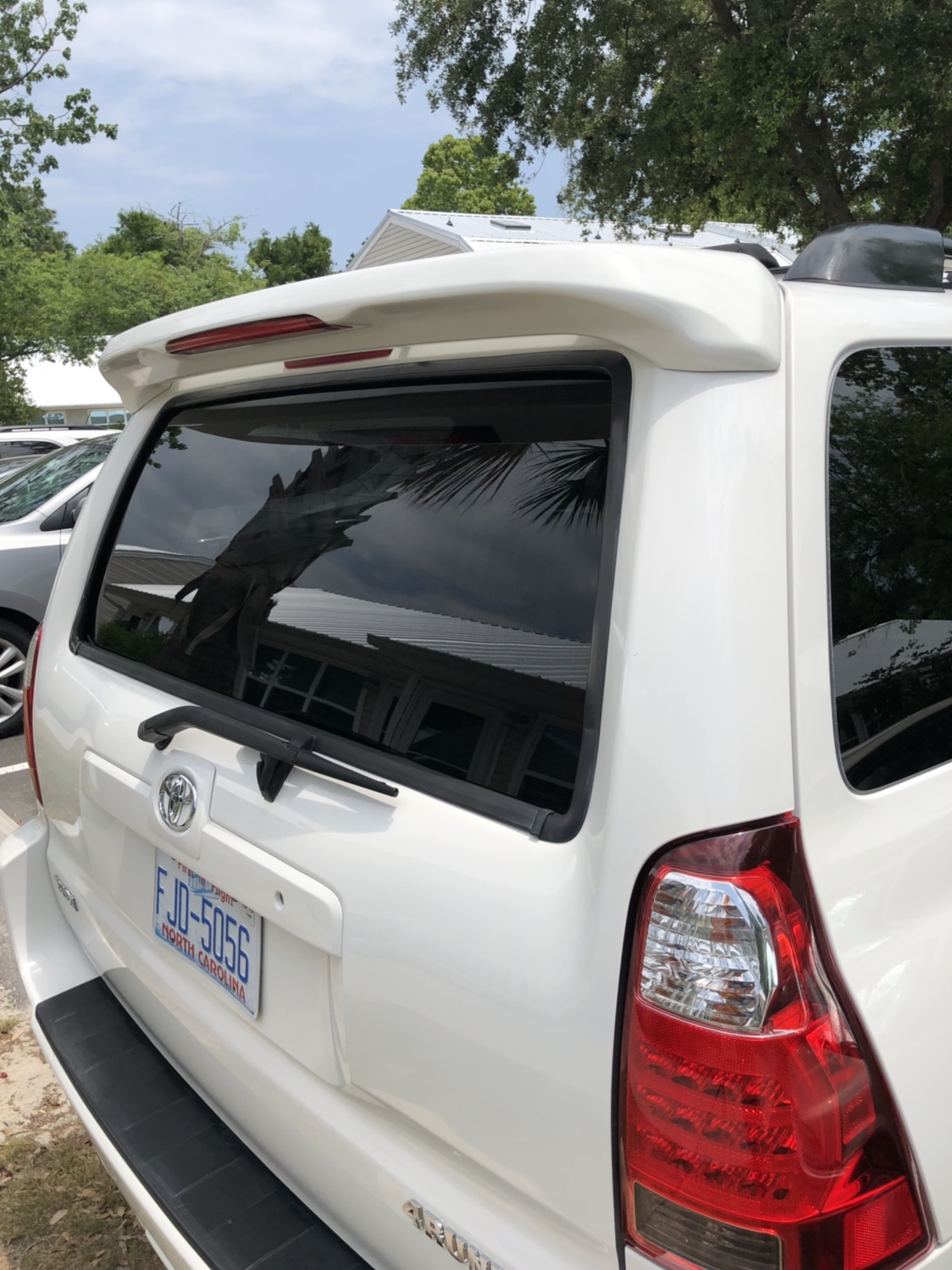

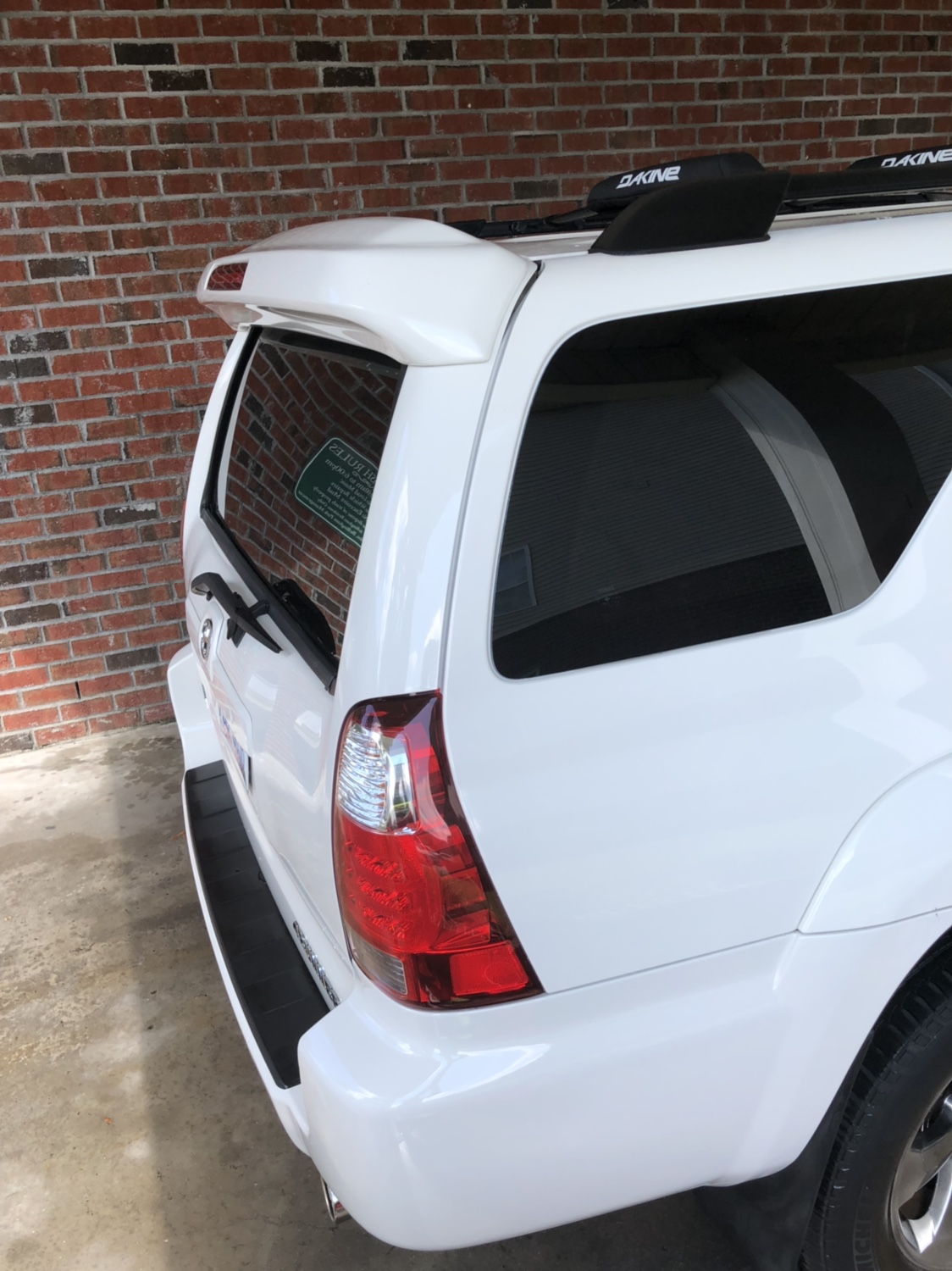

Removed flat port spoiler and Installed the factory spoiler with the hump.
Vehicle: 2005 4WD 4.0L V6 SR5 with 206,000 miles
