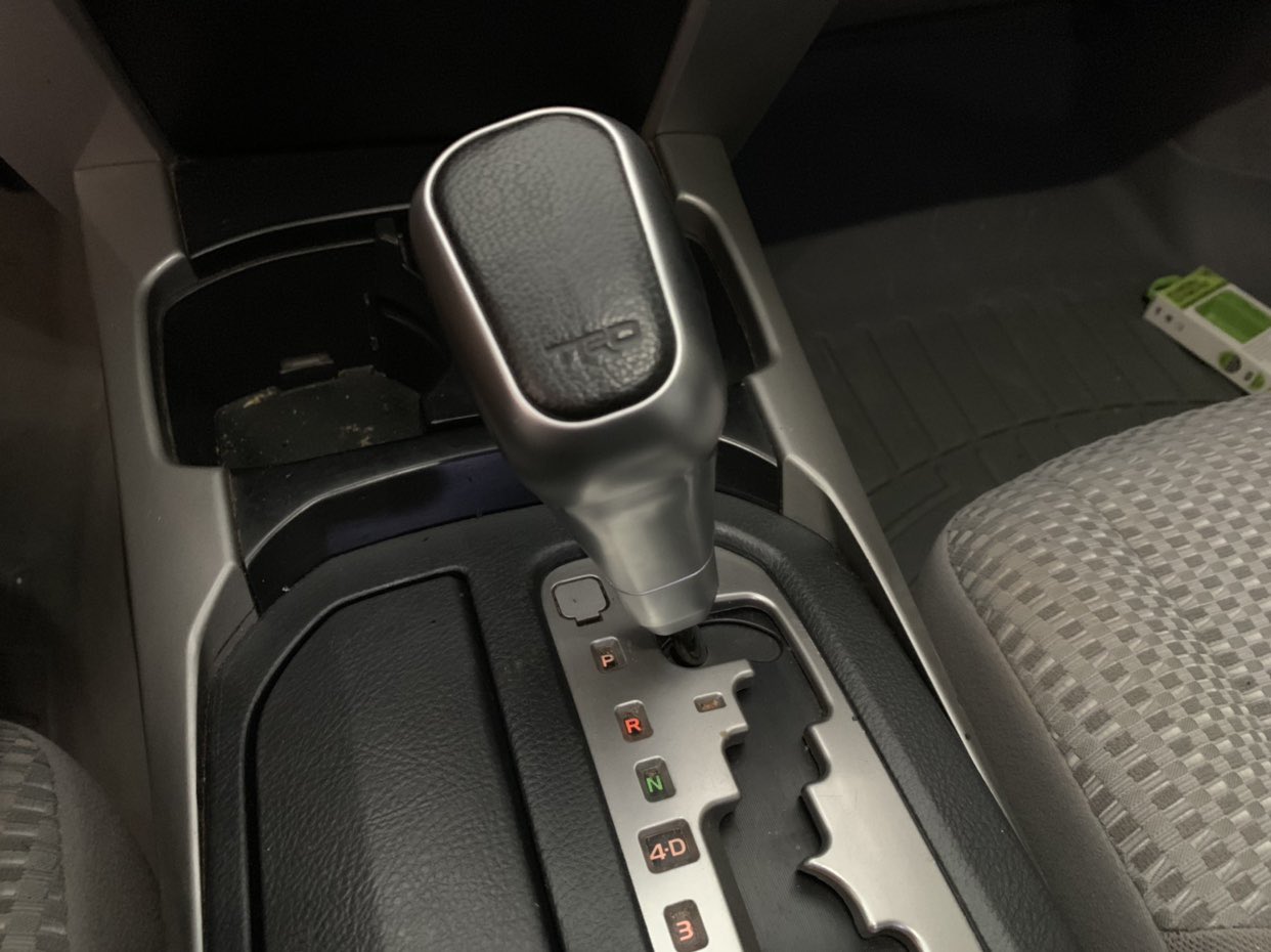

Can you get it tight and also down to 2-L without contact?
Yes, thanks to [MENTION=112299]Formidable[/MENTION] suggestion on a thread I put two M8 nuts and a rubber washer before the knob and it sits and tracks perfect. Look up his history you’ll see the post. You do have to pry off the bottom of the knob before install but it’s easy. Just use something plastic to do the prying and it’ll be fine.
Edit: this thread
TRD Pro Shift Knob Installed
TRD Pro Shift Knob Installed - Toyota 4Runner Forum - Largest 4Runner Forum

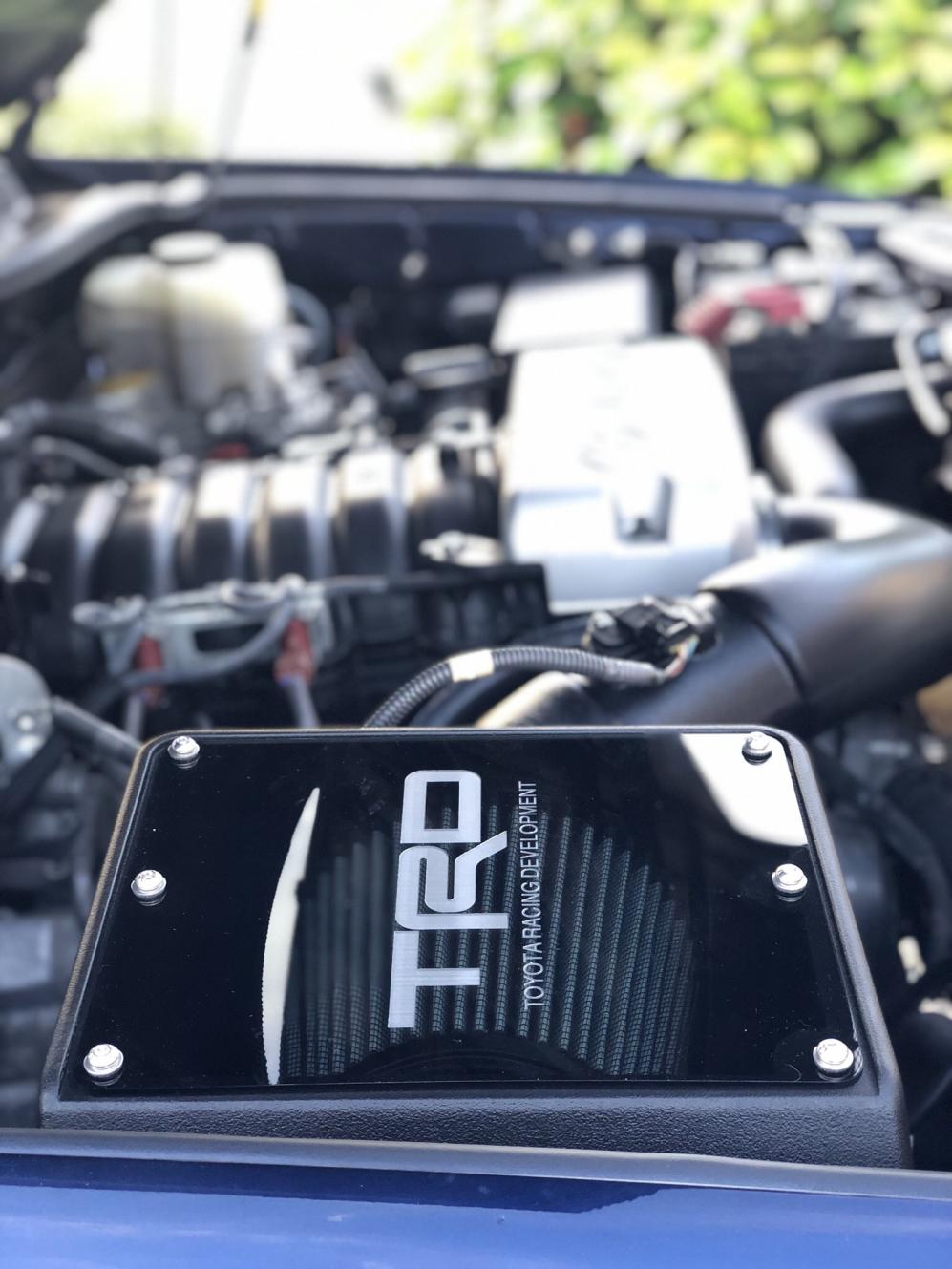

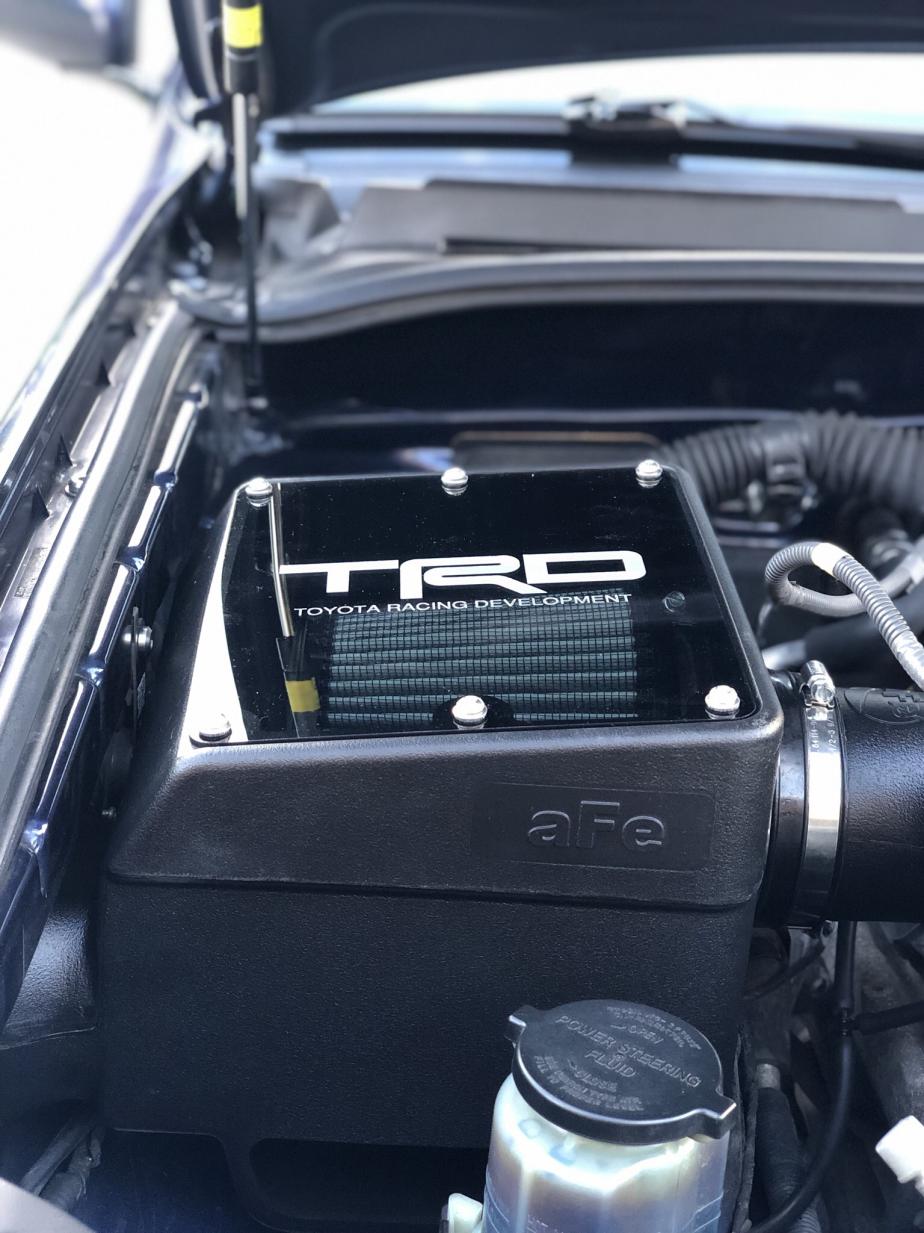

AFE intake for the 4.7L V8 with custom acrylic TRD etched cover installed.
