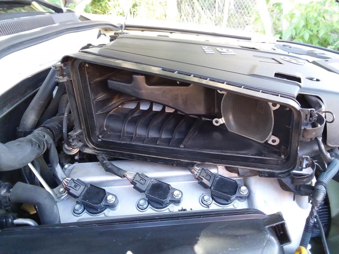

After 210 K miles, I decided to remove the carbon filter on my 1GRFE.
I took some rubber hose and blew through the filter to see if there was resistance. There was quite obvious resistance. So I decided to remove it.

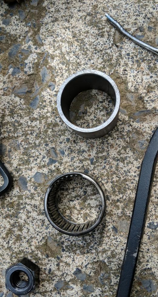

Yesterday I replaced my needle bearing with the ECGS clamshell bushing and put in a new CV since mine was leaking. Not a hard job at all other than getting the CV axle out and getting the new CV in. The internal clips on those things are stubborn!! It's nice to not have rattling/clunking from the loose axle anymore (I also tightened up a swaybar endlink that was doing its fair share of clunking)
You can see where my axle wore down the needle bearing (unless I just don't know what I'm looking at?)
Holy crap your valve cover is clean! I guess that's what I get for getting mine dirty every chance I get
