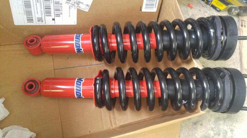

Strut assembly
Assembled my new front struts. Using the moog tall front coils and monomax struts. Went ahead and bought new top plates so I could assemble them before I remove the old ones. Also adding daystar spacers. Finished the rear with the moog tall coils, skyjacker 7000s and daystar spacers. Plan to install the strut assemblies tomorrow.
