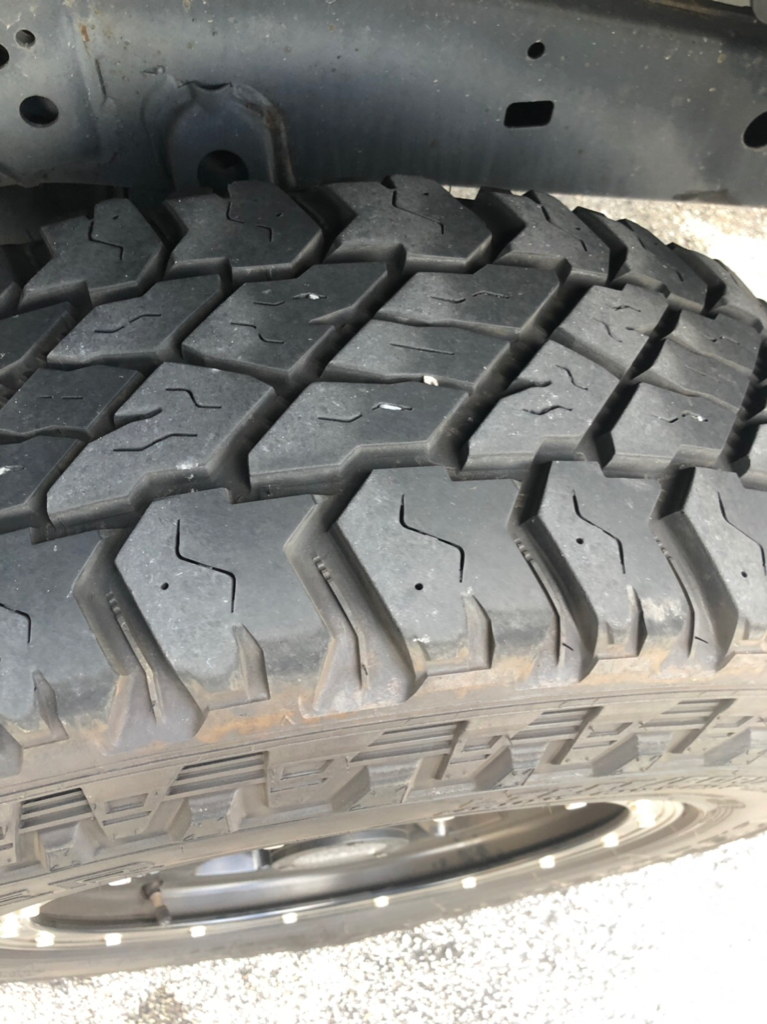

I’ve been seeing this strange “wear?” Pattern on my tires, all 4 but more prominent on the rear tires
I had a rotate, balance and alignment done about 500 miles ago but haven’t noticed much difference
This is the rear driver side tire for reference with the “dirty” side of the tire towards the front and the darker non sandy side of the lugs towards the rear of the car
Any ideas on causes?

How old are your shocks?
Year and a half old bilstein 5100s
Looks like they're cupping to me - which is typically caused by worn out suspension or bad alignment. I'd double check the alignment specs - things like slightly bad wheel bearings can throw the alignment off so that it looks better than it is (ran into this yesterday when I tried to get mine aligned -___- ). Maybe take it somewhere that does a free alignment check.
From googling, it looks like that kind of cupping is common on the ST Maxx when one of those two things are off. I'd just check everything suspension-wise, as something's likely worn out and causing it. The only other thing I can think of would be tire pressure. Not sure if it'd be too high or too low though, as those usually have different symptoms.

Cupping is also caused by incorrect air pressure, and/or heavy braking. May be as simple as airing up your tires some more.
