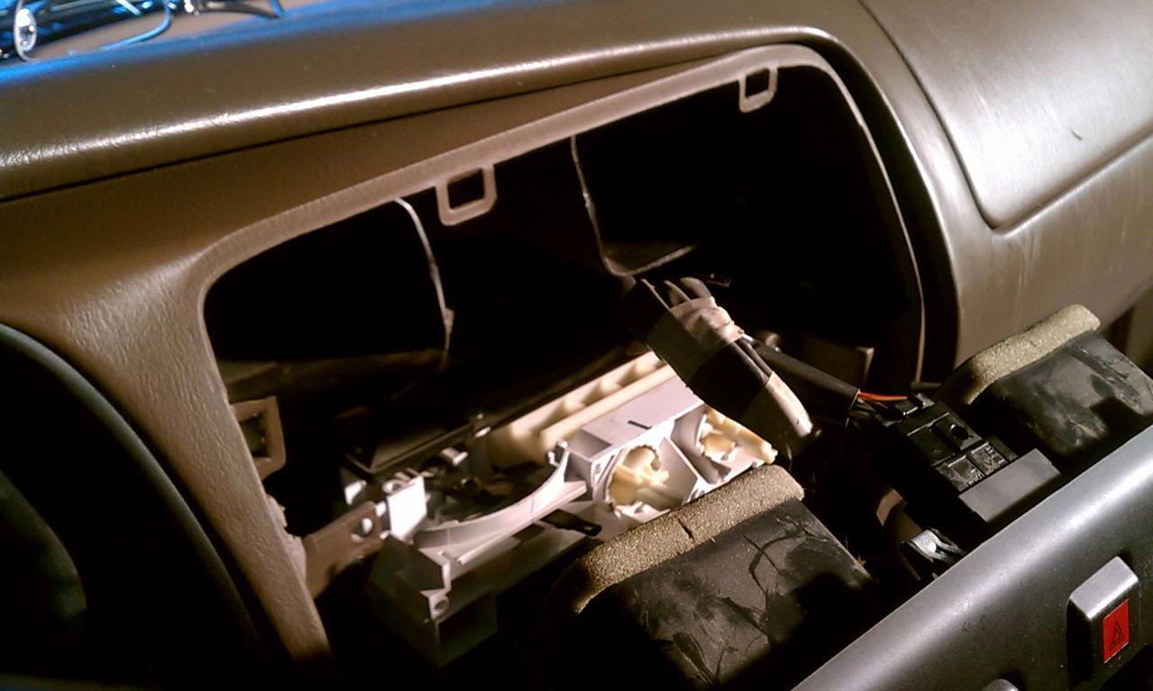

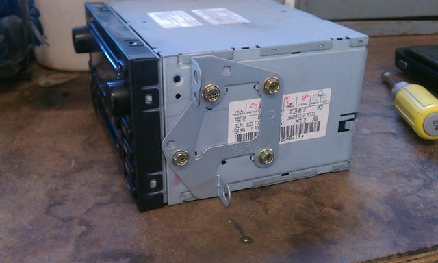

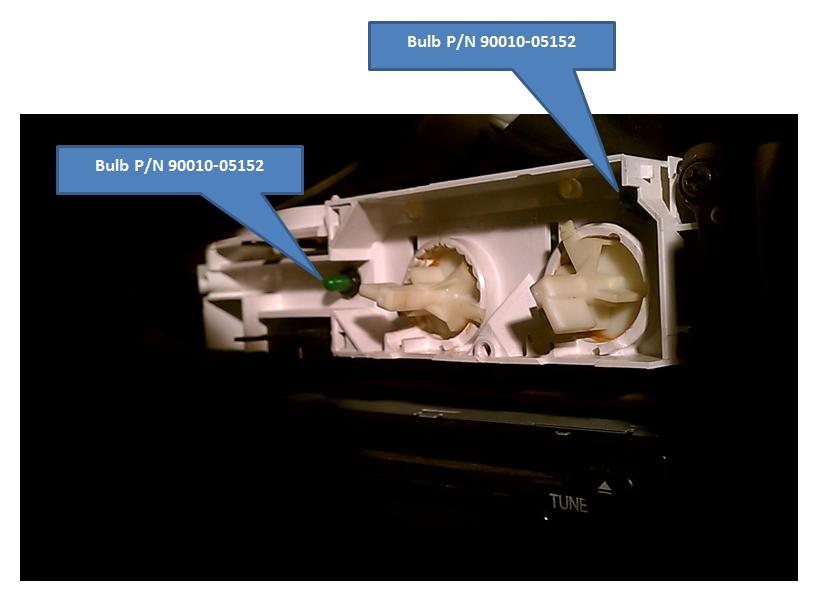

swapped radio & replacded dash bulbs
My orig radio died so i got one from a guy here on the forum - Thank you!! Also replaced the bulbs behind the fan control and heater/defrost mode switches - bulb is part # 90010-05152 (though only one was out, I figured i was in there so replaced both). Also replaced the the bulb under the shifter PRNDL which was also out. Can find that part# somewhere if anyone needs it.
Thought these pics may be helpful to someone some day...
