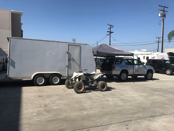

Got it fitted with a weight distribution hitch, electronic brake controller and extended mirrors. Will be towing a 16x8 enclose trailer that will weight a little over 6000lbs. Lets see how the 4.7 does coming up the Grapevine!

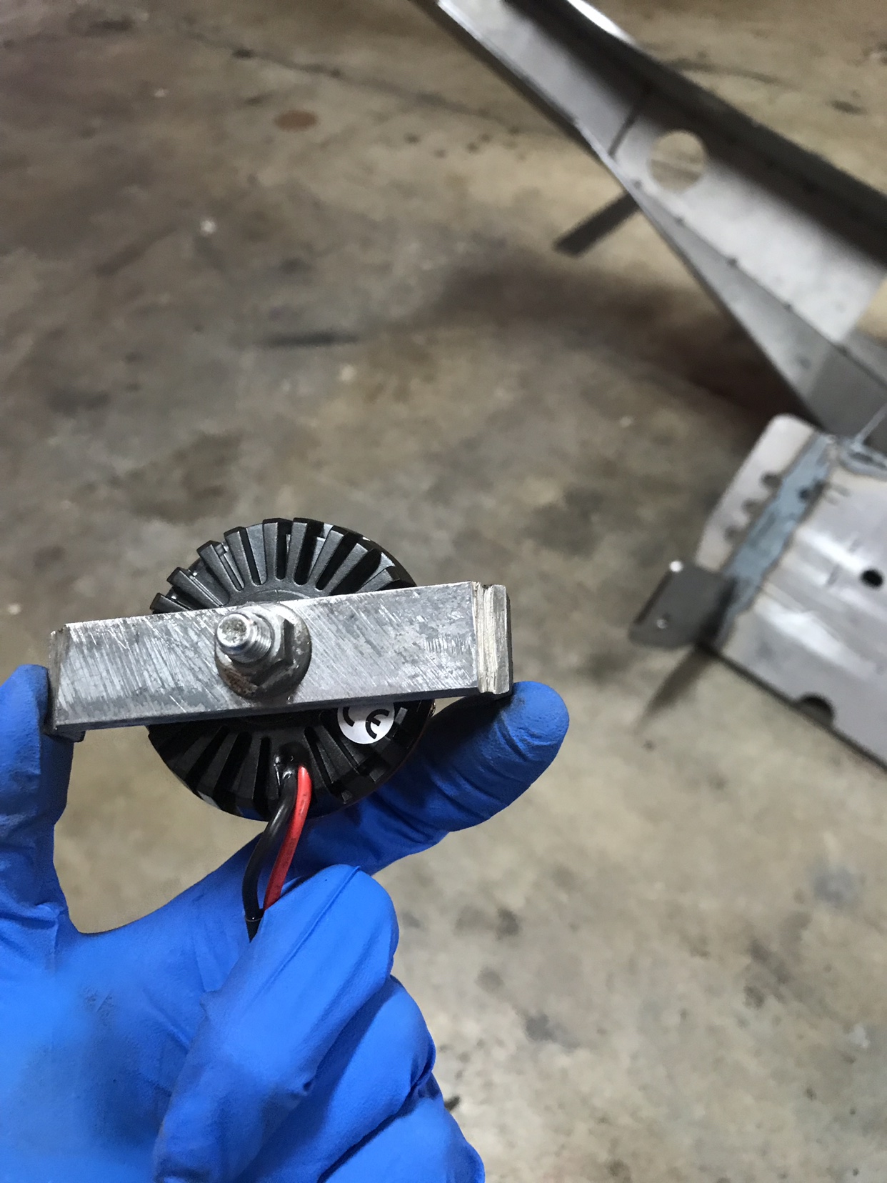

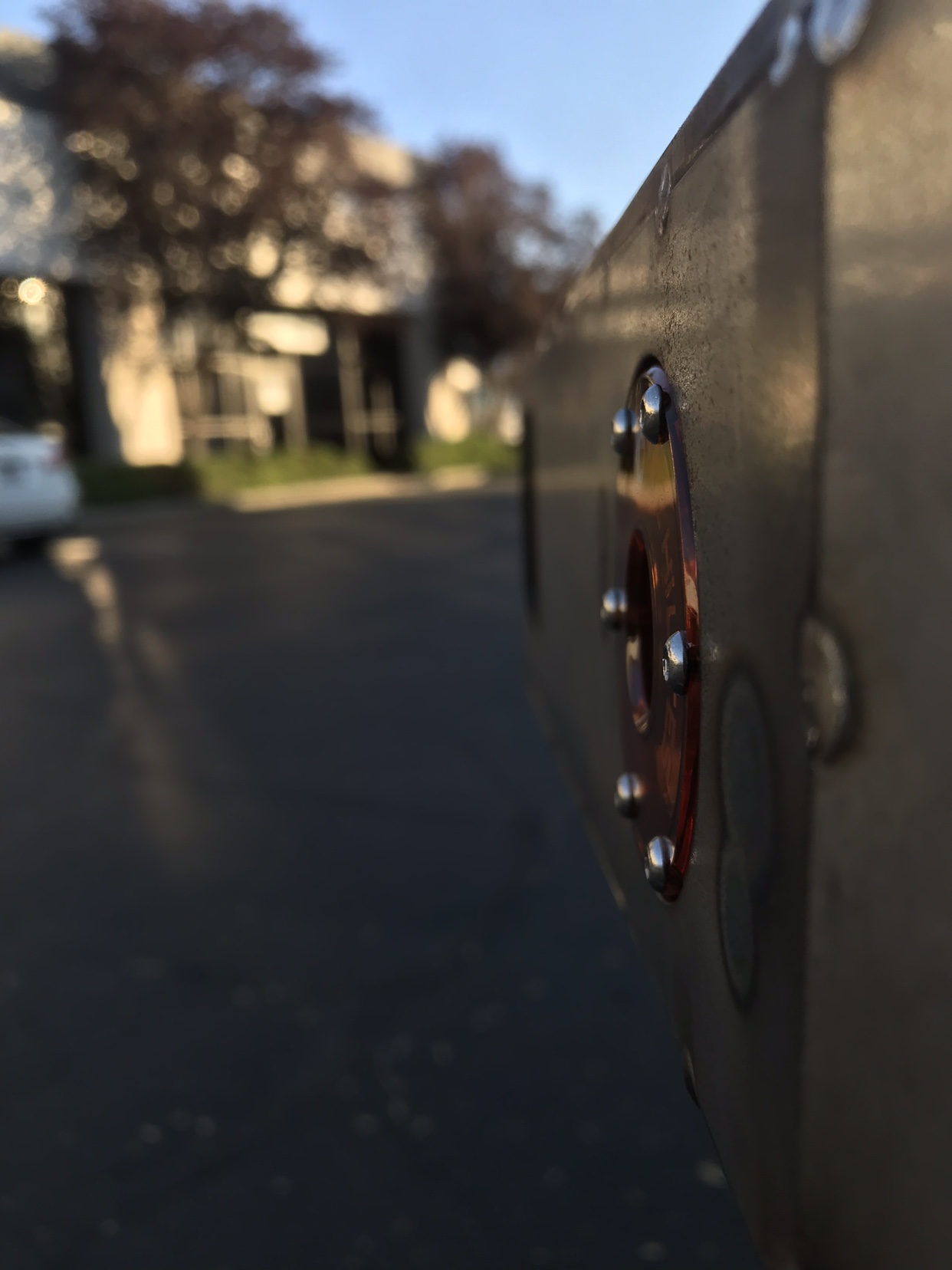

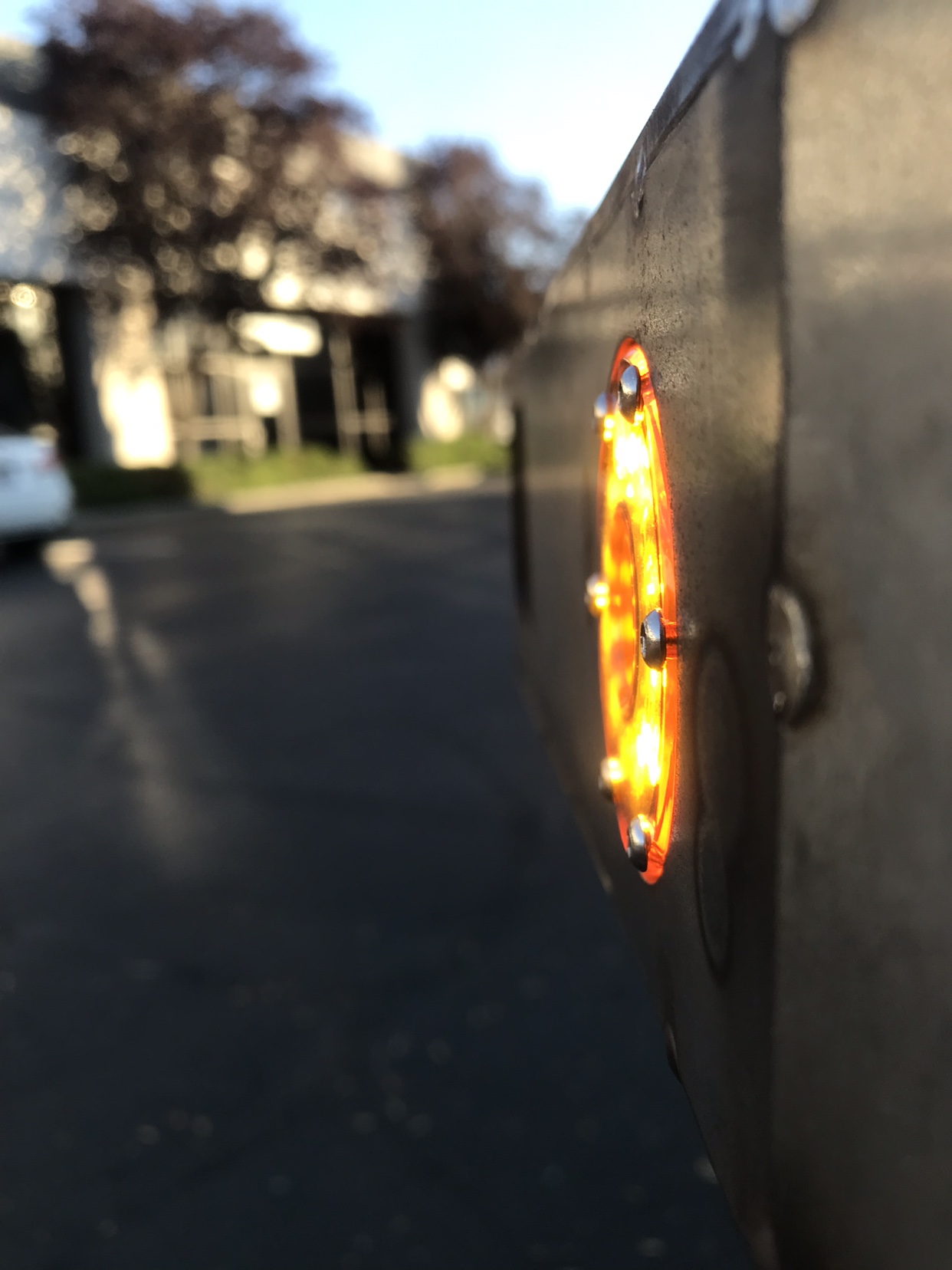

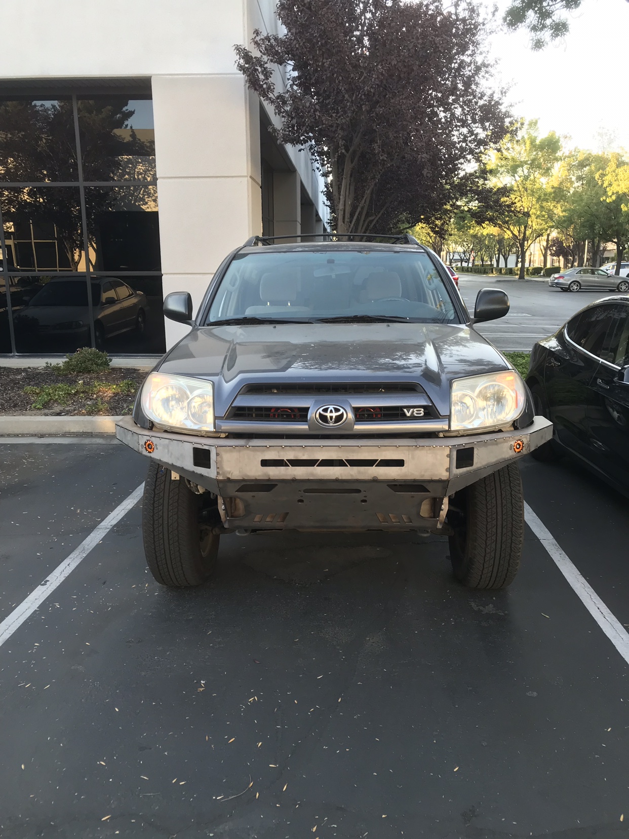

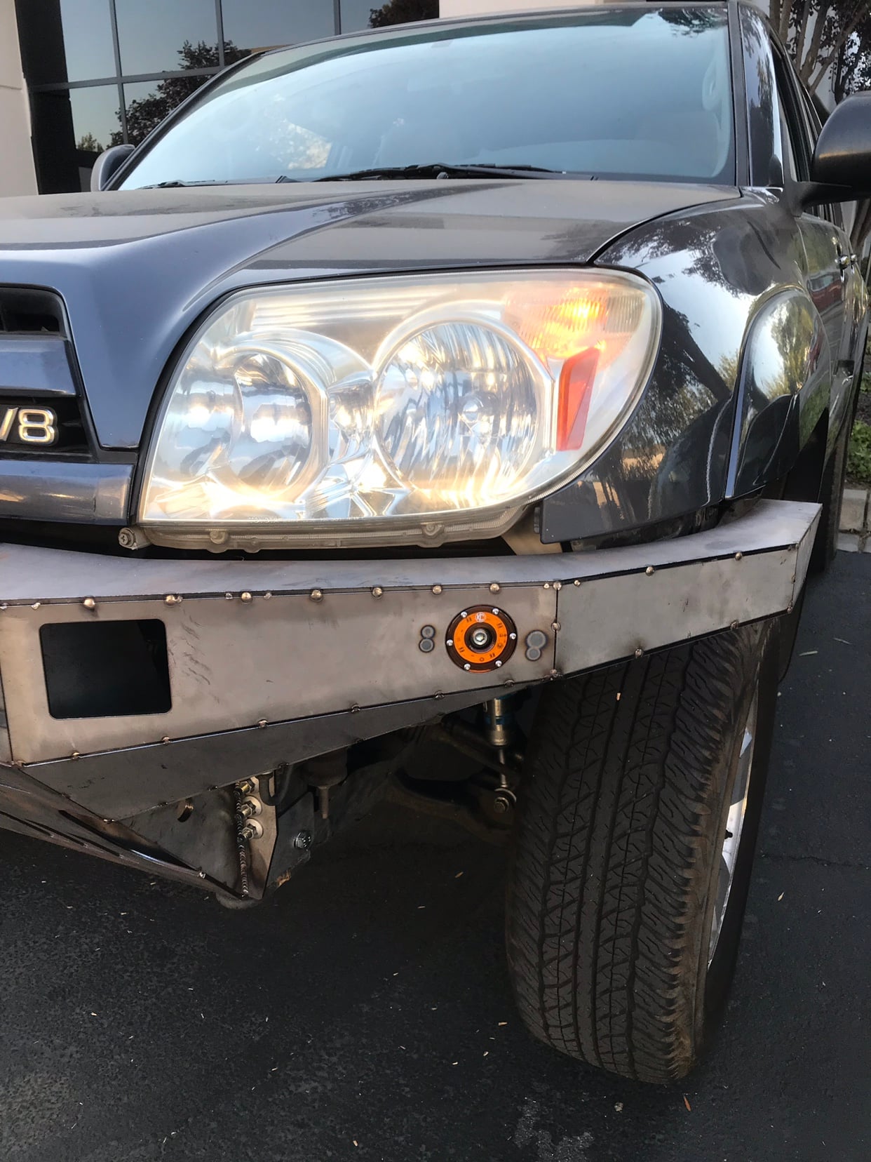

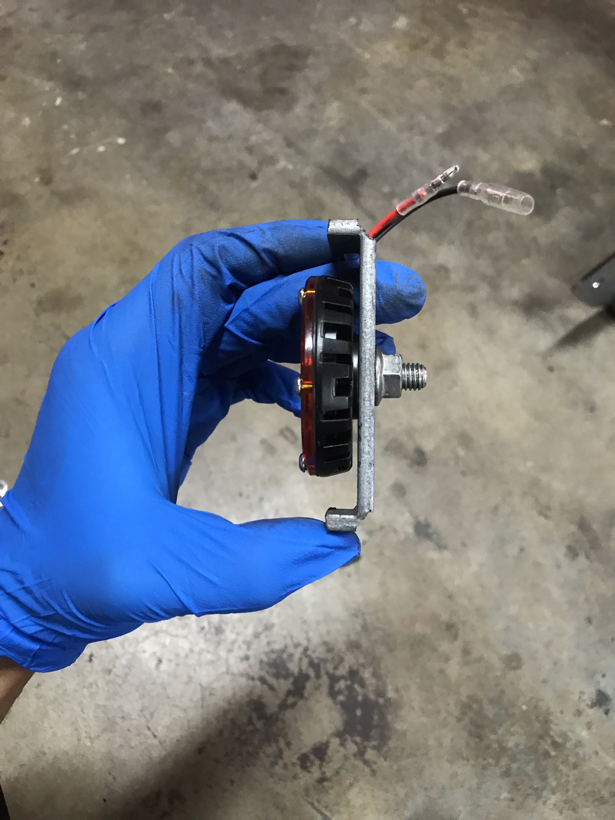

No more Hyperflash!

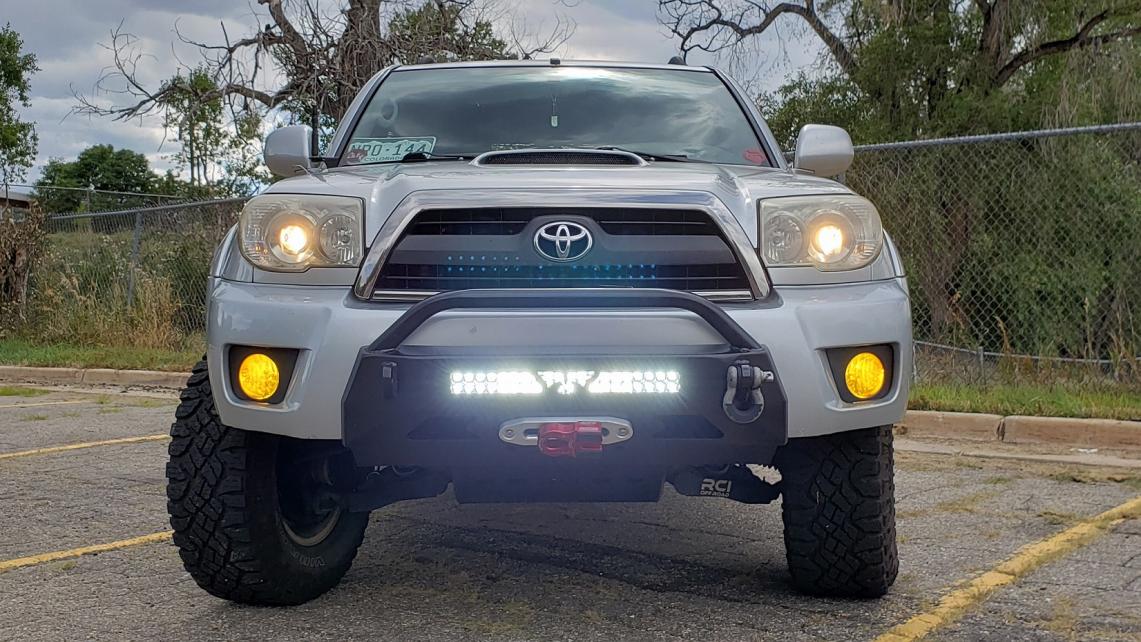

I replaced my factory turn signal relay with one from Amazon to correct my newly acquired hyperflash. The LED turn signals in the Demello bumper caused them to hyperflash as expected. I already had the relay ready to go, just was lazy to get around to it with the heat as of late. Woke up early though and got it done!
Very easy job once I got over my apprehension of unplugging everything from the fuse box. Turns out each plug only fits in it's corresponding socket, so it was next to impossible to mess up unless you're a caveman(sorry Geico).
I was under the assumption that the initial "slow startup" for the blinking sequence would annoy me, but it is hardly noticeable. Overall I'm very pleased with the results, and my turn signals function as they should in terms of flash intervals. It may be in my head, but I swear the sound it makes is somewhat different and it's actually more pleasant to my ears. I may be losing my mind though, so who knows. Did u hear that?!?

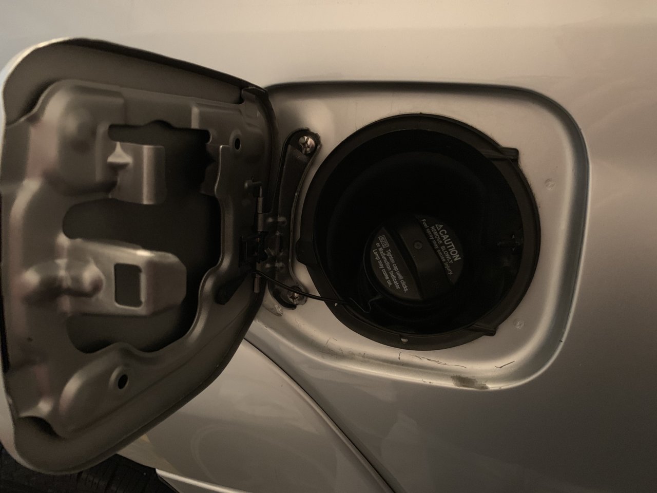

Installed new fuel door. Original door hinge pin had rusted in half and couldn’t open the door without scraping the crap out of the body.
Drilled out the rivets and added M6 machine screws per another member’s post.
Topped the hinge and screws with some CorrosionX HD to prevent it from happening again. PO didn’t do much rust prevention.
