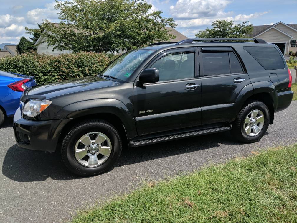

I bought one... 2007 107k miles, took me a month of looking and I had to drive 3 hours to get it but well worth it.

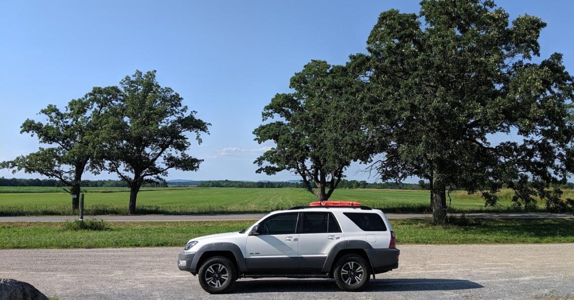

Nice two tone look, thinking about that now.
