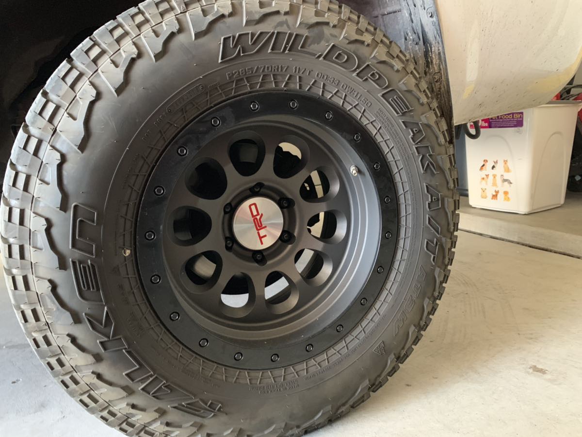

I would love to hear your input. what didn't you like about the BFG KOs. I was about to get the BFG KO2 but the tire shop was having a sale so i went with the falkens.
But why are the Falkens better then the BFG? Just curious to hear your input.
The compound seems to be a little softer. Whenever it rained i felt like i was driving in ice with those KOs. The Falkens just seem to ride better in dry and wet
I’ve had mine for about 4k and they're awesome. I did come from an E load MT to passenger Falkens, so for me it was a drastic difference.

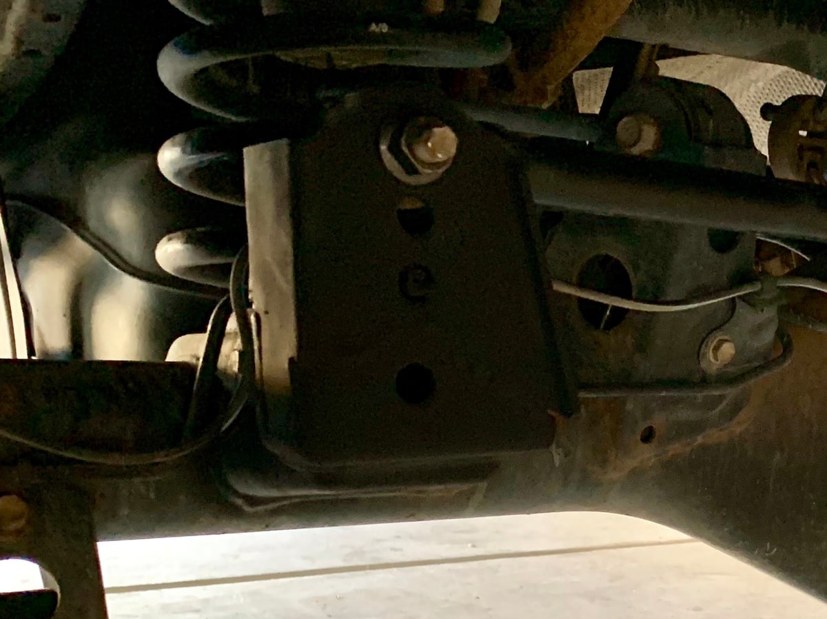

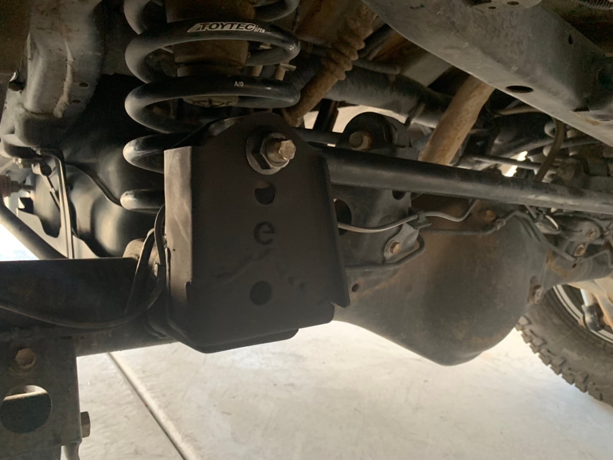

Installed my [MENTION=28464]eimkeith[/MENTION] PCK, nice and level back there now. Also installed Icon 2.5 w remote resis and adjusters in the back. Much better ride than my 5100’s.
I need to install my pck...been sittin there for a while now
It's a lot easier than I thought it was. Mine sat for a few weeks until I got some free time. Here's a slightly better picture.

Just thought I'd drop a line here following up my post about the PCK install I did a few days ago. I was skeptical about the kit to be honest, I didn't think it would make much difference.
Ever since I lifted my 4R, I've had this weird floating feeling when driving over bumps on the highway. It seemed like the ass would take a second too long to settle down. I figured it was part of changing the geometry of the truck and I'd have to live with it. I've had the kit on for a few days now and have had the chance to do some highway driving.
What a difference this kit made. Such an easy solution to the floating feeling in my rig. She feels much better hitting those bumps on the highway now. The kit fit great, no grinding or modification needed, just cleaned up the bevel for welding. It was an easy install even for a relatively new self taught welder such as myself. If you guys are on the fence about it I'd recommend it. I only run Toytec 2" superflexes in the rear and my kit fit on the top of two available holes to have the panhard sit even. Thanks [MENTION=28464]eimkeith[/MENTION] for a great product.
